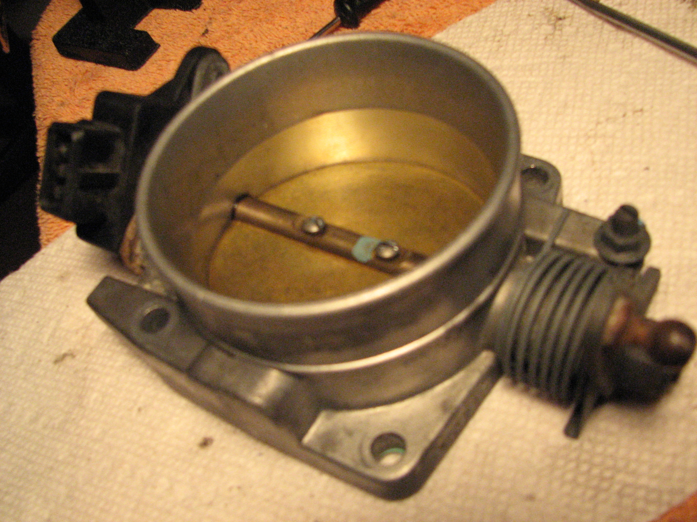

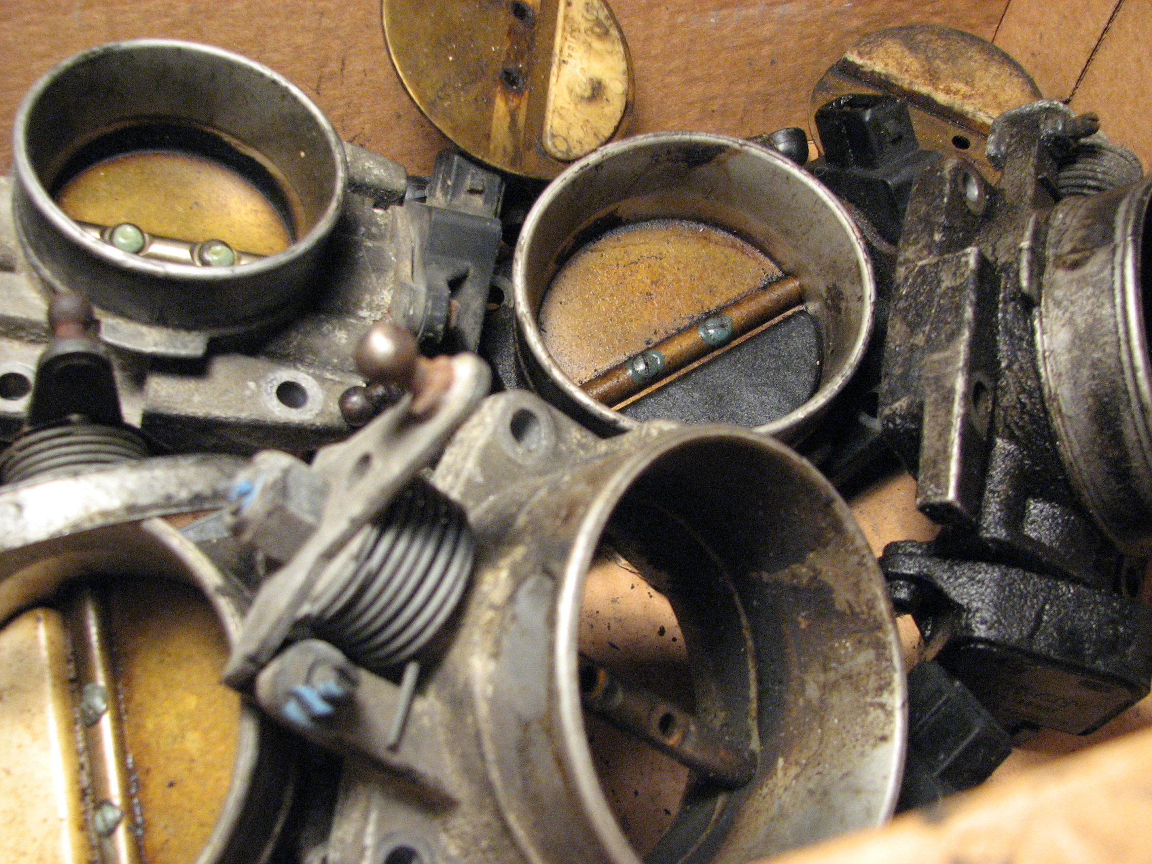

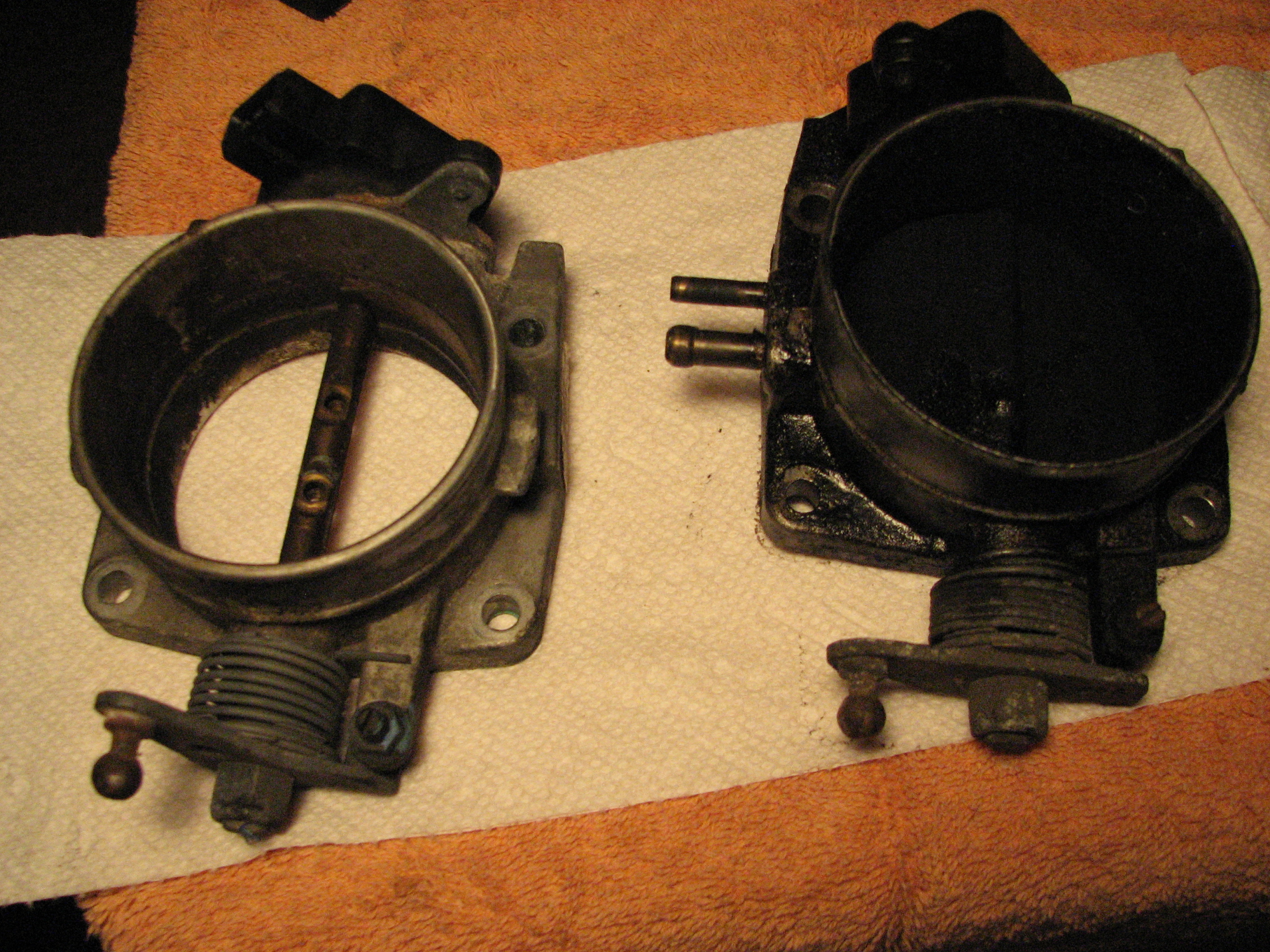

After doing the N/A throttle plate alteration on my '93 I had a box of throttle bodies and parts. I had recently grabbed a couple turbo throttle bodies for the wagon for throttle position sensor swaps or whatever.
I can easily get an N/A manifold at my pick and pull for $23.00, or I can spend a couple hours grinding the bore to three inches on the present one.
Either way, It is a plan. Today was a snow day so I brought my box of throttle bodies inside to create the appropriate piece for the application.
A Box Of Throttle Bodies.

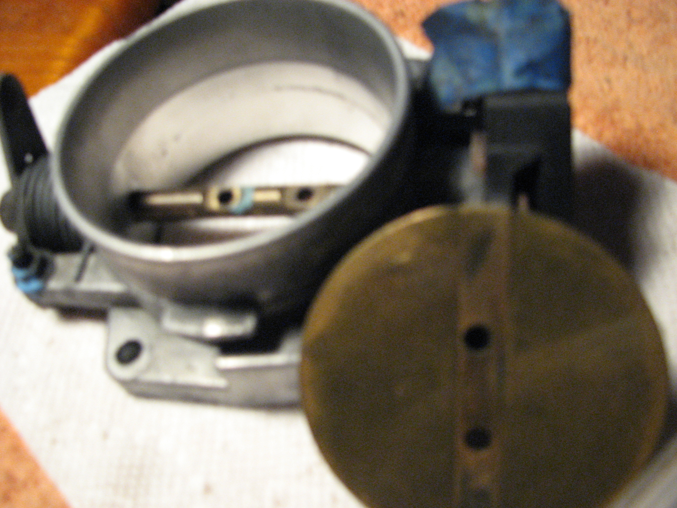

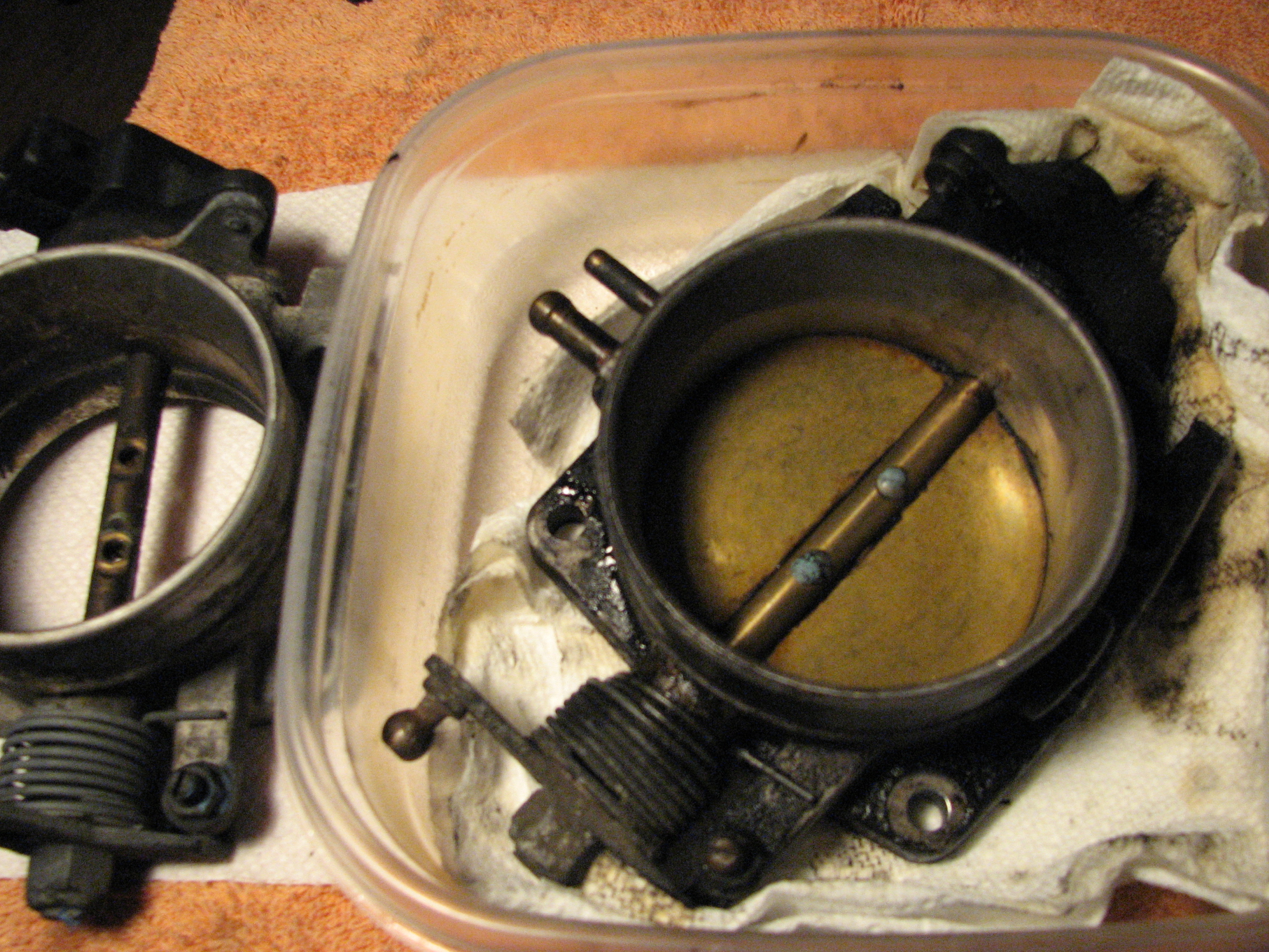

I had a few 3" for my '93 but only one with no vacuum tubes. (what I want) That was an easy choice for the body. I had plenty of the 3" N/A plates with the obstruction but I wasn't looking forward to filing or grinding it off. I did dig up a 960 throttle body with an unobstructed plate, but it had vacuum tubes and the TPS was angled different as well as the throttle linkage arm.
So the choice was simple. Take the throttle plate from the 960 body and install it in the 850 N/A unit.
The hardest part was cleaning the 960 throttle body just to get the plate out. There was a reason the 960 was at the junkyard, it was breathing oil straight. It must have smoked horribly.
960 on right with donor plate.
Gunk degreaser and Brake cleaner in the house. A little light headed.
Getting there.
Getting there.

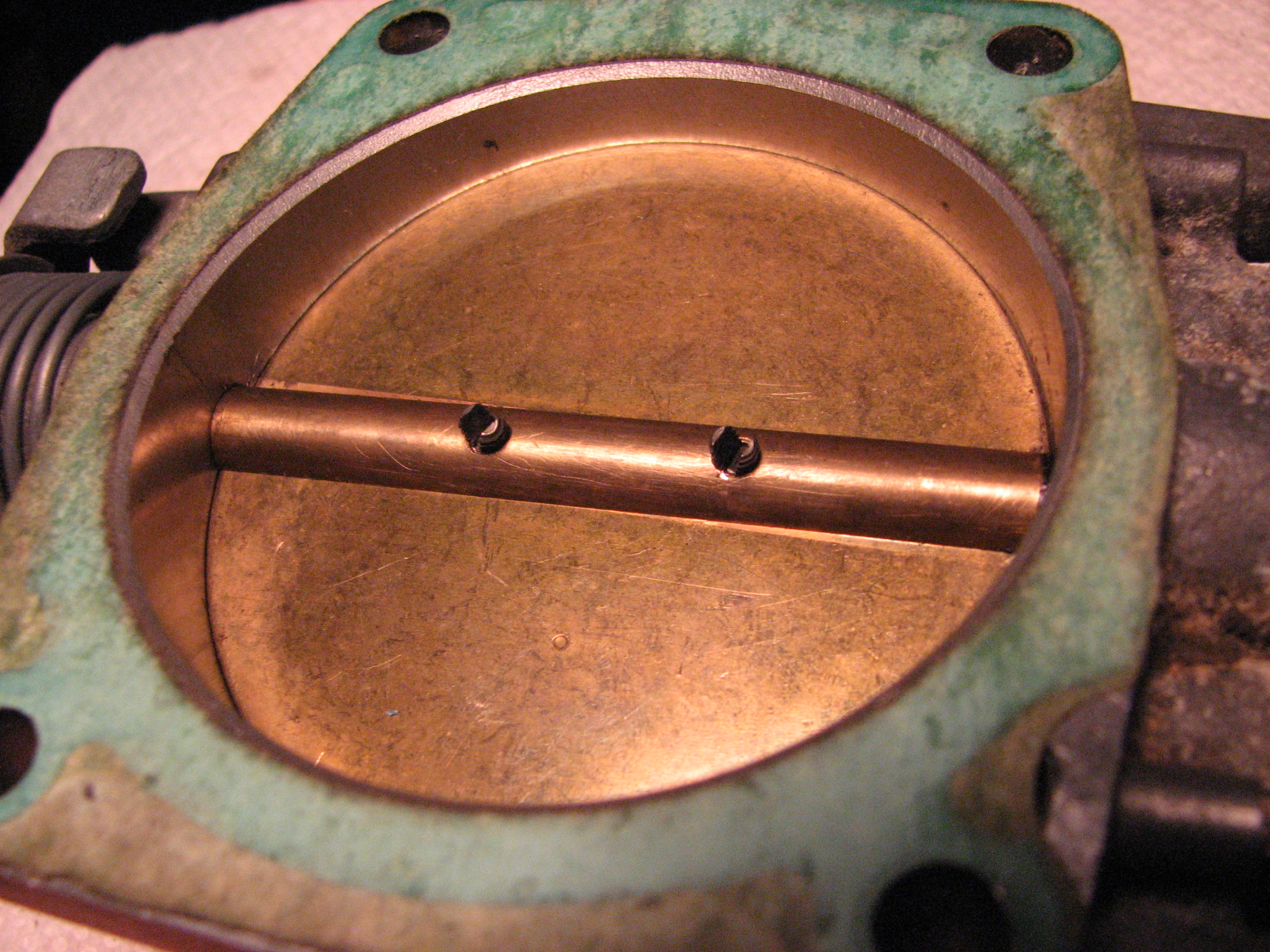

All set looking good.
Be sure to spread the screws to lock them.
The thing I learned when modifying the '93 throttle plate was to not forget to lock the plate screws by spreading the shaft of the screw by the slot on the other side.
After a week or so the throttle plate vibrated loose and would stick open and idle at 2,000 rpm unless I tapped the pedal. It was easily fixed but the kind of mistake you make once.
Manifold is next. I would like to get one from the yards so I can take my time over the winter to clean it up and bench assemble things. I know I can find an N/A for $23. and change, so why bother trying to open the bore myself with hand tools.
Edit.: It just occurred to me. This exact setup is what you want on the N/A to improve throttle response. I simply could not find any 960s at the time so I had ground the plastic obstruction by hand with a file.

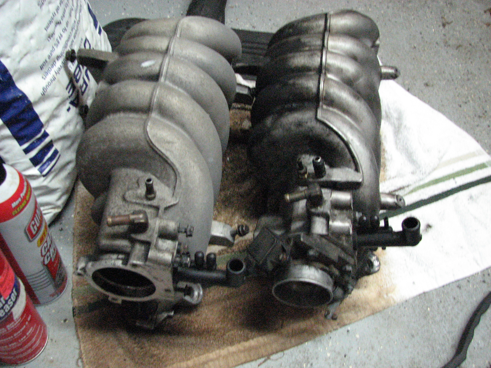

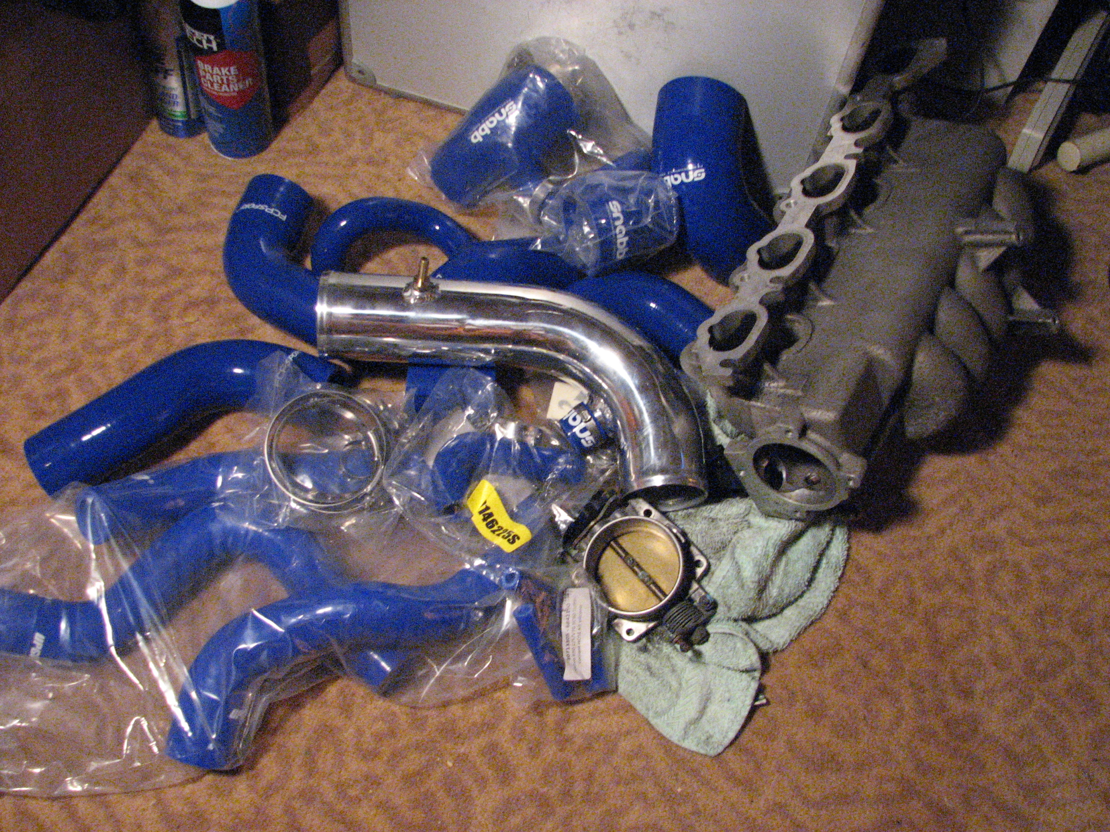

I did finally get the manifold during the one and only day in January that was suitable to go outside here.
I've bought a few other things along the way. Reconstruction begins Monday and will be added to my maintenance log with photos.
There is a bigger pile today.

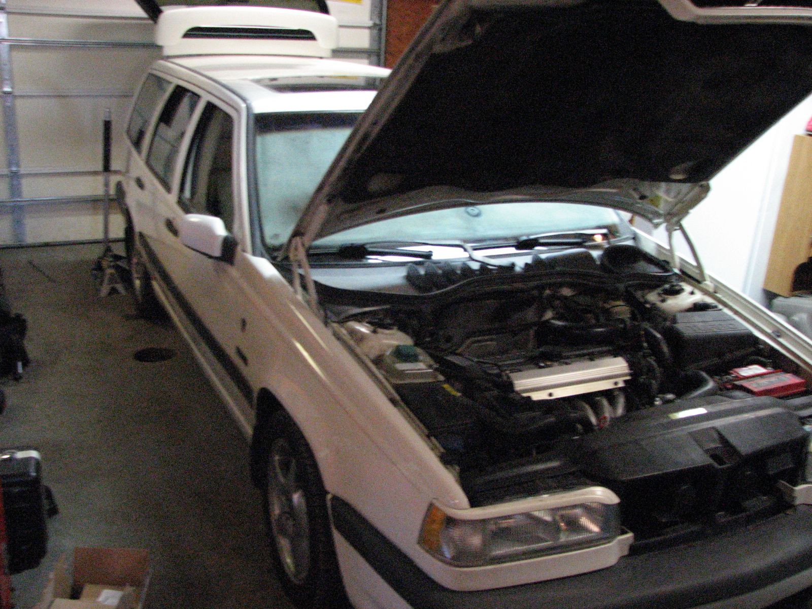

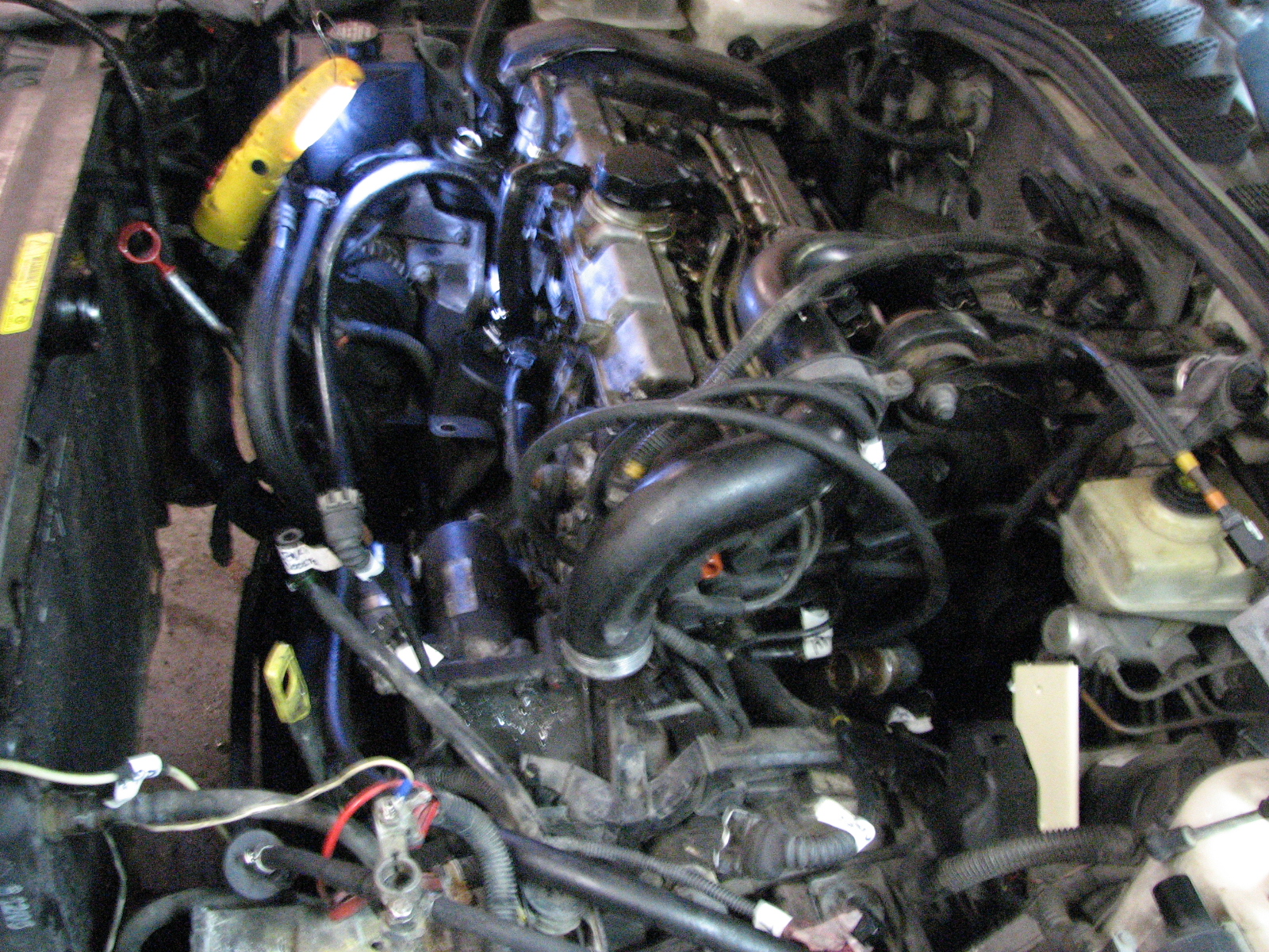

I am into my project as of yesterday.
The garage is only down the street but the ECC is not functional at the moment. That will get fixed as well.
The Wagon had no shelter over the winter and it was as cold as -20F here.
I had to order a radiator quickly from FCP because I noticed small drips of anti freeze on both tank areas. The steel piece across the bottom was extremely rusty.
All the hoses will be silicone, and I have a new Aisin water pump coming as well.
Everything has to be done by Friday when the owner of the garage/home comes home.
Frost inside the car. It was cold yesterday.
Thawing out.
Thawing out.
Before.
Before.

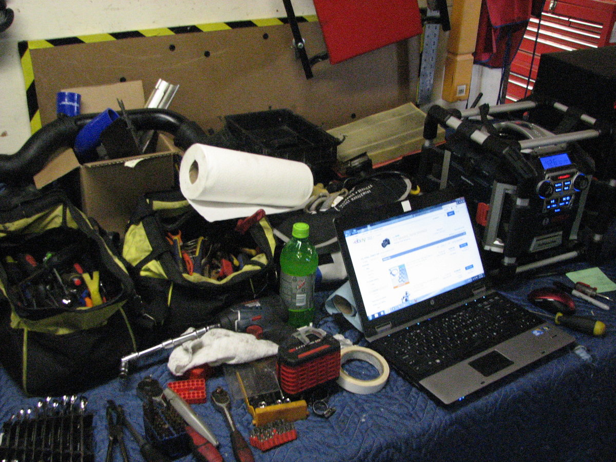

Central command. Air hockey table.

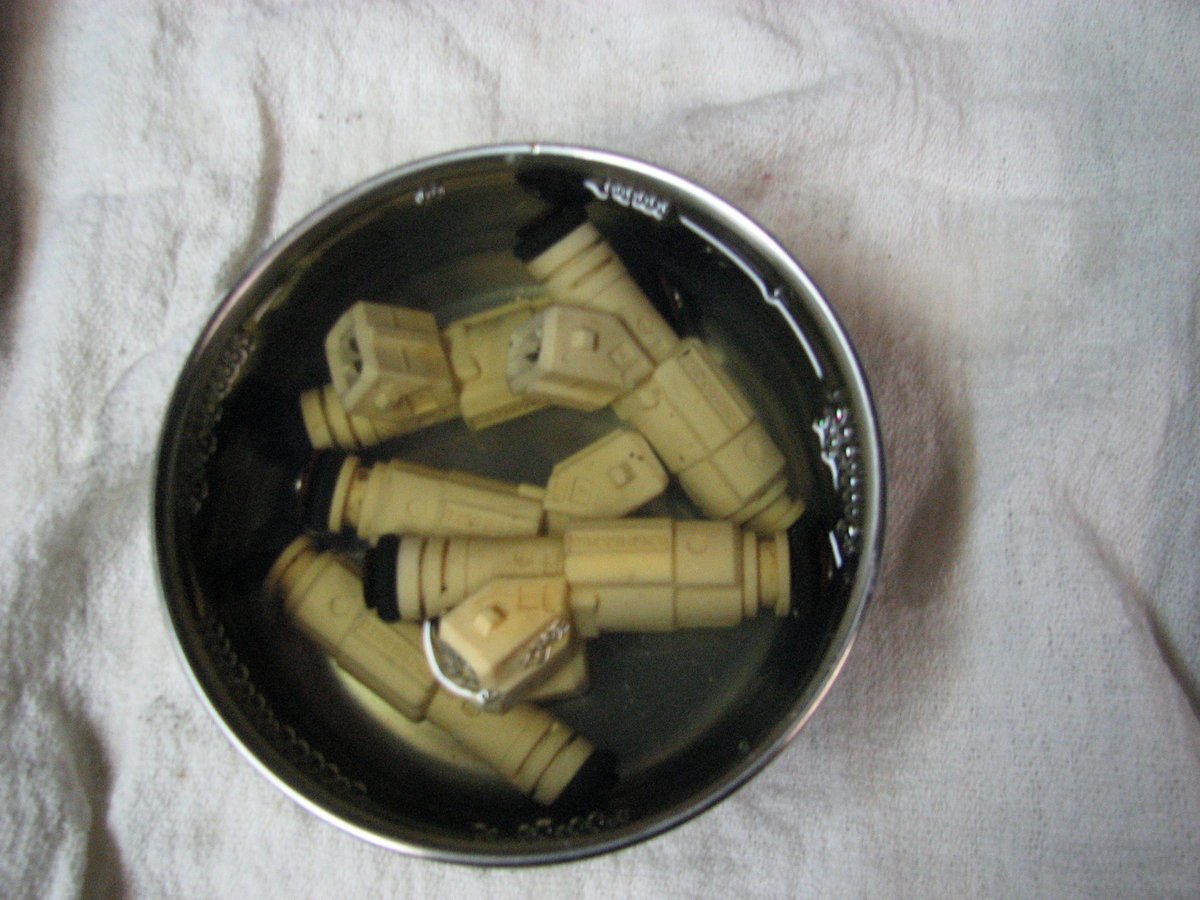

White injectors soaking in seafoam. Expensive little bath.
Where I left off.
Where I left off.
Hopefully everything ships on time.

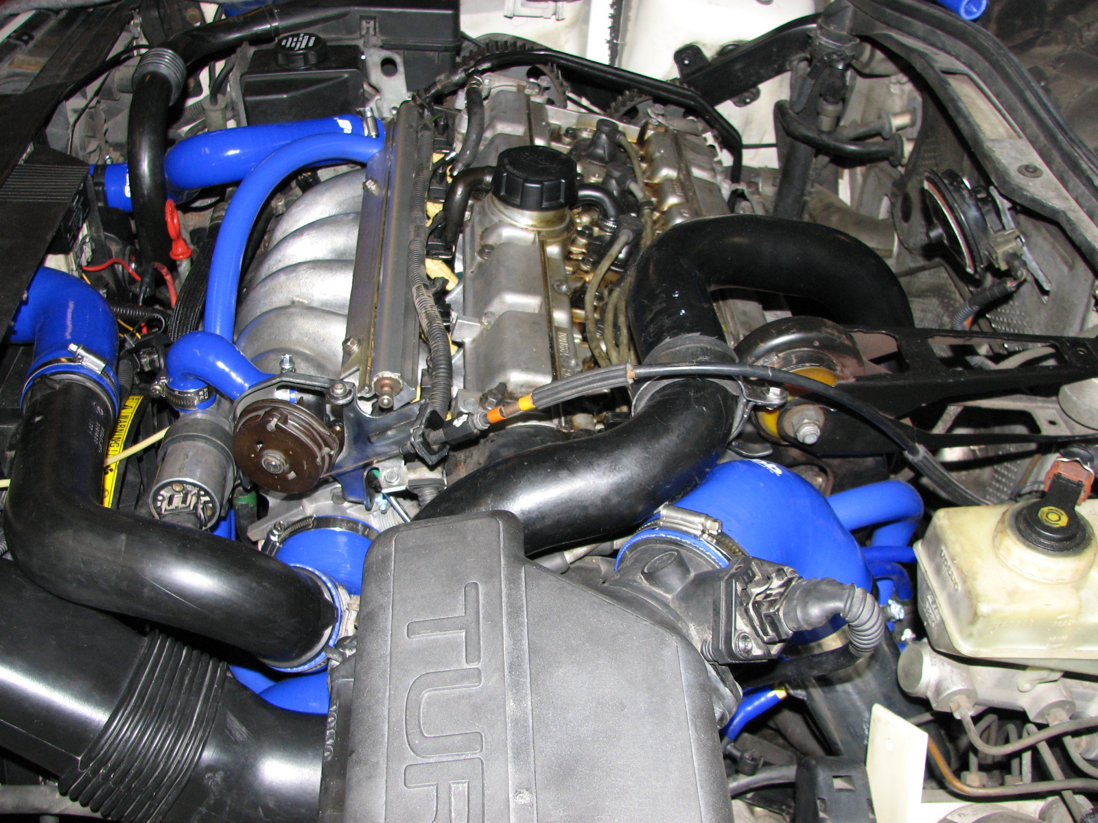

I've been working on it for four days now. I am waiting for the water pump that is late in shipping.
I'll finish the timing belt, water pump, pulleys, tensioner, as well as the serpentine pulleys and belt tomorrow.

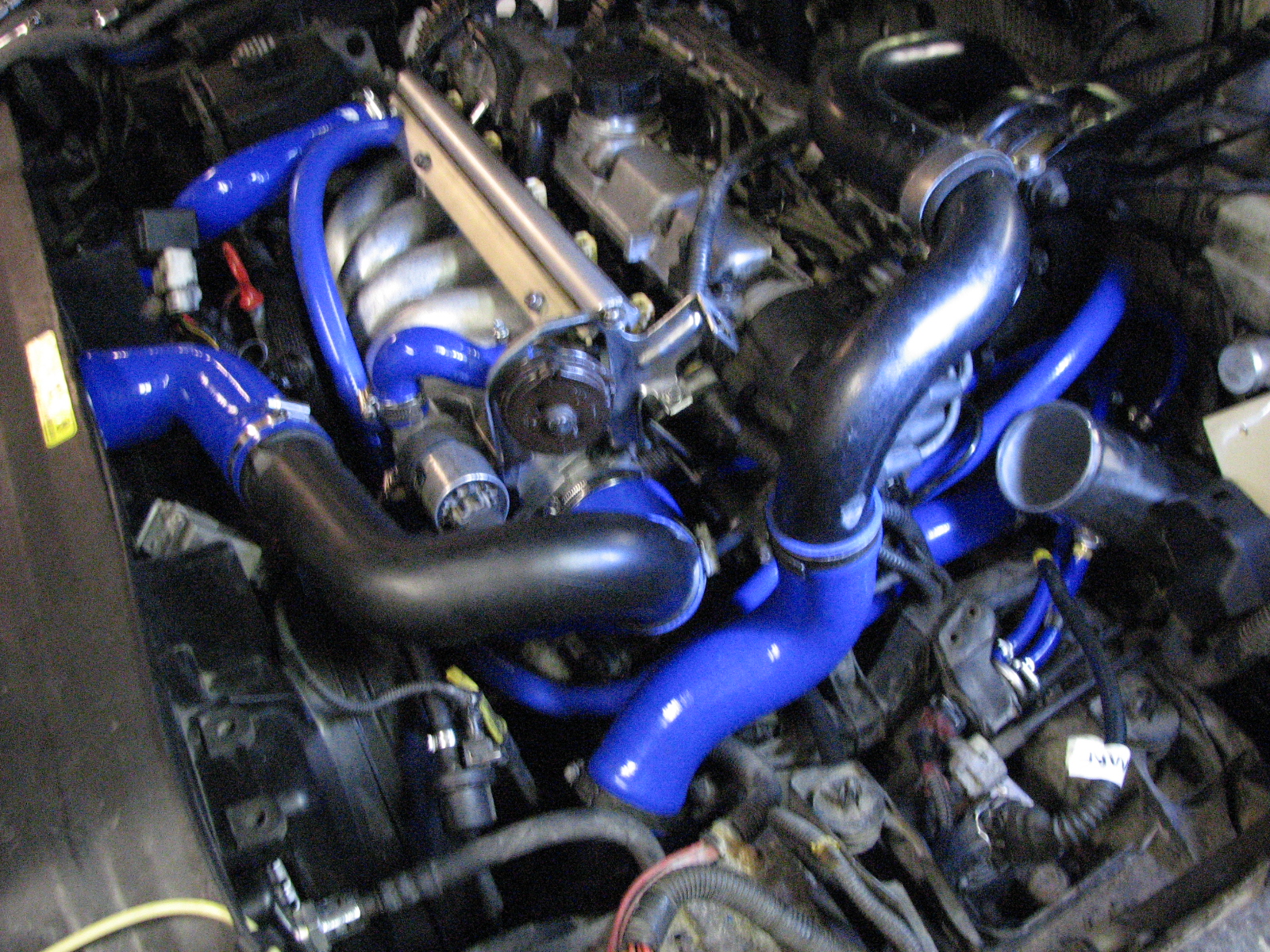

The 3" aluminum intake to turbo makes the air box a snug fit.
Almost done. Water pump delivery today.
