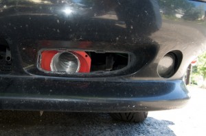

My much-delayed $25 Cold Air Intake blog post I finally finished last night. Basically, this Matt's Volvo Blog Issue #2 is all Cold Air Intake. It's about what I did, how, why and what my impressions are after 6 months about a few thousand miles.
>>> Here's the writeup Cold Air Intake Tutorial <<<
This very post is where you may discuss it, ask me questions, tell me I'm an idiot, etc.
Sample:
Before we start, I’d like to warn you about something. This mod does one big no-no, and that is exposing the engine to a greater risk of ingesting pollutants like dust, water, sand, grit or other debris. Volvo engineers have been working for decades to keep this stuff away from the engine, and by doing this you’re removing a big safeguard they designed: the position of the air intake.
To judge the degree of risk, a proper test of several (dozens? hundreds?) of 5-cyl turbo Volvos would be in order. Of course this has not and will not ever happen, so you must decide for yourself how much the extra power/efficiency is worth to you. SO FAR, my engine is fine.
If you absolutely must not take any chances with your Volvo, don’t perform this modification. Put in a K&N filter and call it a day.
Want more power?
I’ve had a bug in my head to do this ever since Pete in Australia posted his cold air intake modification years ago. Mine is really no different. Just better documented Image . Want more power, more efficiency? Don’t mind getting your hands dirty? Don’t mind checking on your work every month or two? Have $25?
Then this mod is for you. You’ll need
  • 1 plastic funnel, $5
  • 1-2 yards of 3-inch diameter dryer ducting tube, $10
  • High heat duct tape, $5
  • Duct tape, $3
  • Lock ties, $2
Also -> Amazon link

I agree, the biggest downside of this is not knowing how much better, if any, the performance and fuel economy is with the mod. Barring going to a track, or knowing a friend with a dynamometer, the only truly feasible test that would satisfy my curiosity would be long-term fuel economy test. Even then, you'd preferably want to test it on the same drive, say the route to work every day, with and without the mod alternating every day or every week.
You could run some repeated highway on-ramp tests late at night using a passenger with a stopwatch, or a performance tester, but you'd want to test, remove the mod, test, put the mod back on, test, etc.
You'd have to be pretty dedicated toward knowing if this cold air intake added 1hp or 2hp ;-).
Whatever. It's fun, and it's fun to point down to the odd red thing in the spoiler and say "I made my own ram air intake." Then see friends and family roll thier eyes.
Let us know how your K&N testing goes, and your cold air intake, if you do it.
