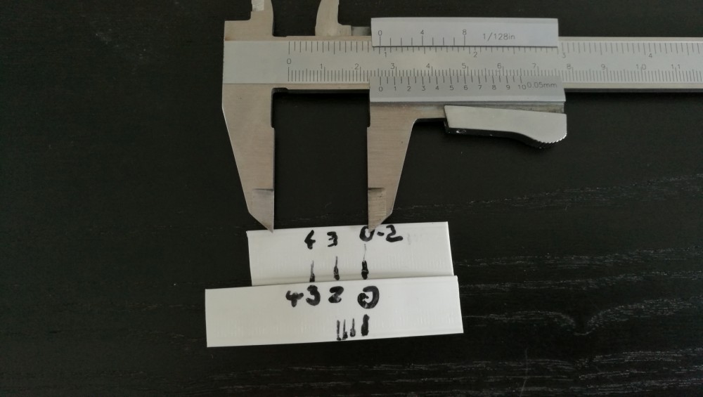

Kind of reviving this topic. I have a question regarding travel of the stock actuator. Or generally what would be considered a good actuator for a volvo. I cannot seem to find any reliable info on that (travel vs pressure)
I have an unknown old actuator and a Mamba I bought from ebay. I had some troubles with surges/overshoot when increasing the tension on the old one. I measured the travel - see picture (bottom). Is the old one still good? there is very little travel. New one seems very linear.
(numbers indicate psi, 1inch caliper for reference)
I can put a stiffer spring in the new one, but that only starts around 8psi which seems way too much. the current spring seems a bit too weak. I will play arouind a bit with it. I still have an ARD actuator, but that was way too stiff when I tried it before. I also relocated the bcs and shortened the hoses, that might help a bit.
