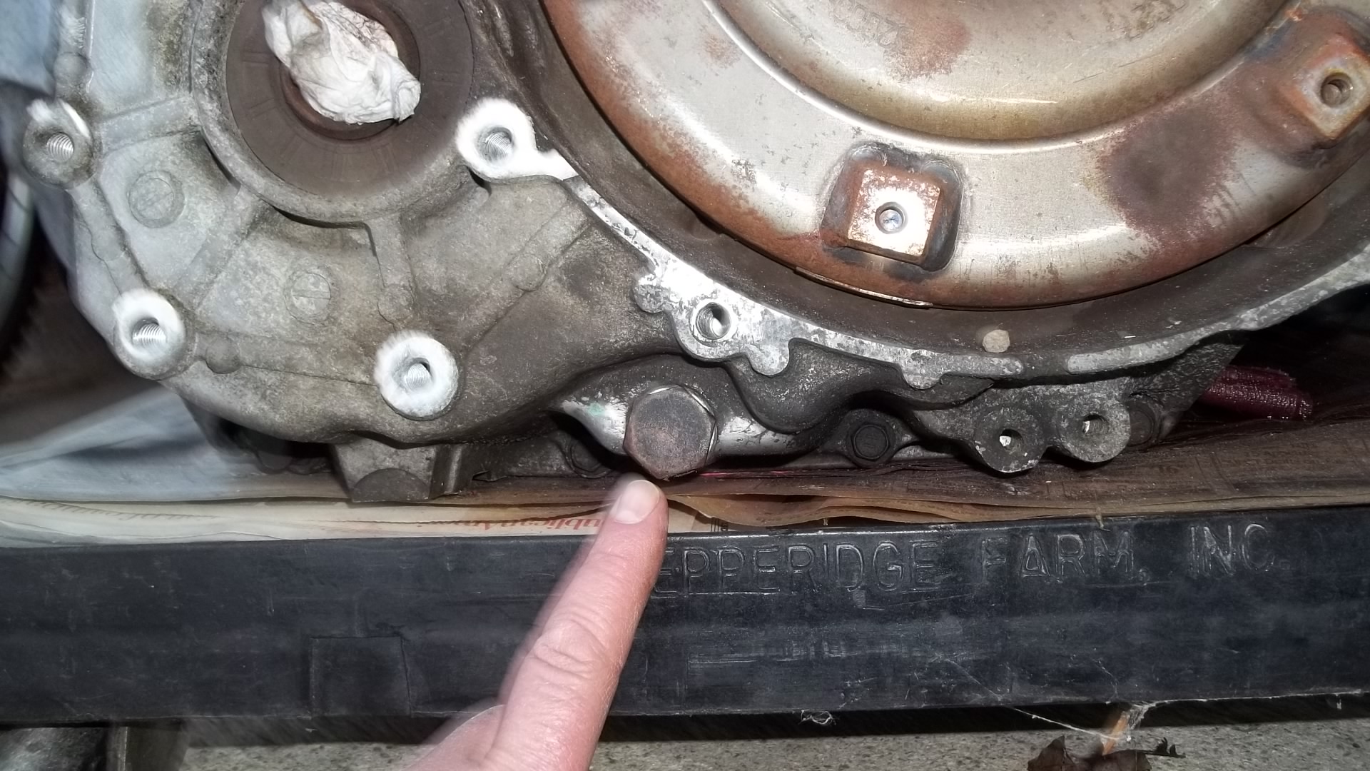

I should not have referred to a "pan drain / refill". It would have been more proper for me to call it a "sump drain / refill". The plug that gets removed is located at the bottom of the transmission - not in the "pan" that covers the valve body. Now it's my time to apologize for the confusion.
Here is a photo of the sump plug. Just this simple sump drain / refill will change about 2.5 quarts of the 8.5 quarts (I think those are the quantities off the top of my head) that are in the transmission. A fluid exchange includes a sump drain, but additionally, you remove the transmission fluid return line from the cooler to enable the transmission fluid pump to cycle fluid out of the torque converter. Basically you are using clean fluid to purge out the dirty fluid by intercepting it before it returns to the transmission. There are threads about fluid exchanges. It is more gentle than a power flush.
A power flush uses a machine that uses higher than normal pressure to flush the fluid out. I guess you could think of it as a fluid exchange on steroids. Generally those are not recommended due to the reasons you stated earlier of dislodging debris within the transmission.
BTW, Mobil 3099 is the recommended fluid for your transmission. Some owner's manuals (like mine) had Dexron IV/Mercon listed which is incorrect.
