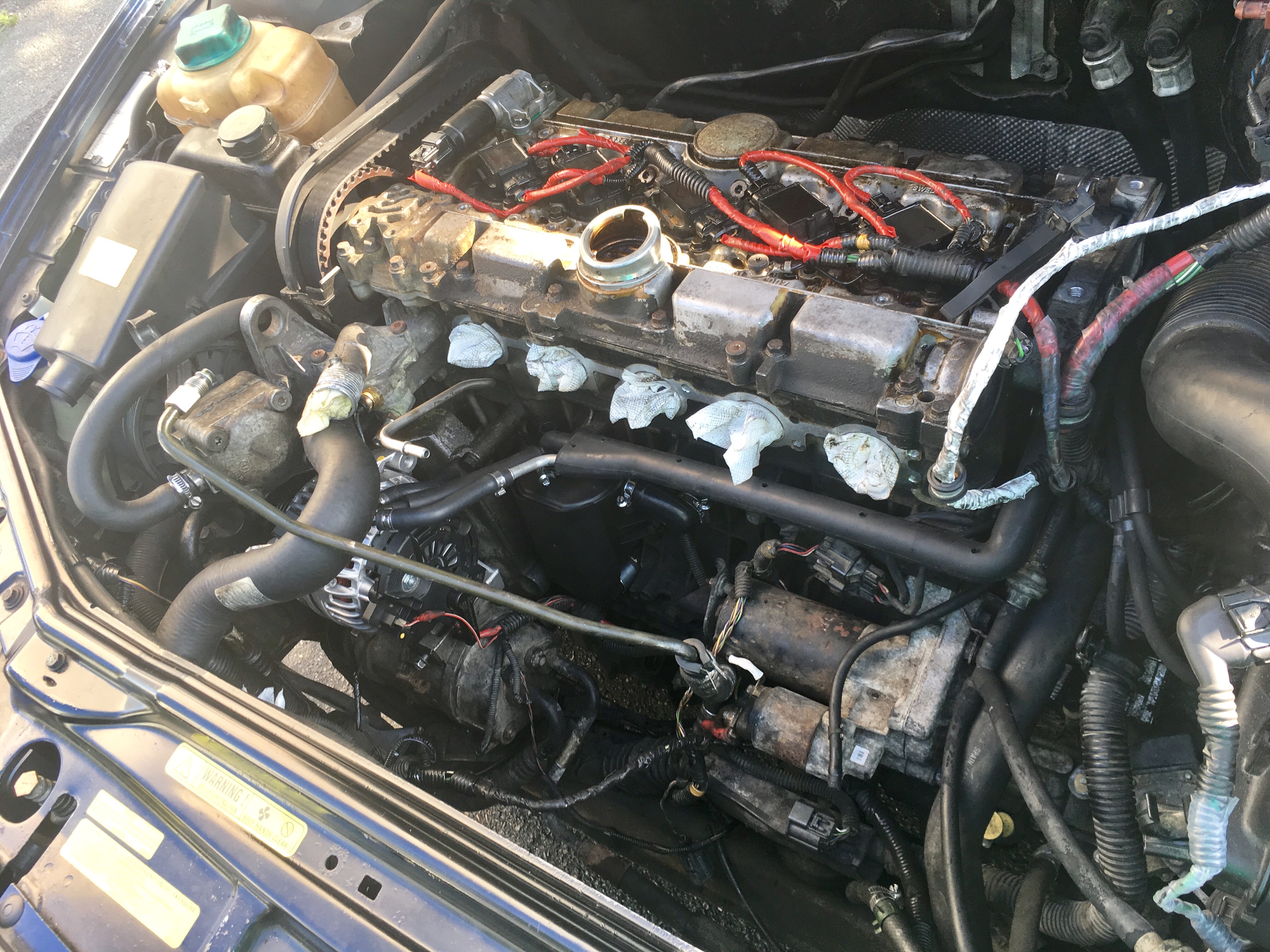

Just wanted to post an update with my progress on the PCV job, and notes and observations so far. The current status is that the new PCV system is in place, but I still need to reinstall the intake manifold/throttle/injectors, hook all the hoses and cables up, and put back all the air intake and other peripheral components I moved out of the way to gain access. I was pretty exhausted from working all day Saturday and half of the day Sunday, so I'm taking tonight off and hopefully will finish up tomorrow night.
0. I wish I had a permanent car repair area that was covered, had a level surface, lighting and fans, a workbench, and tool cabinets. You know, like a garage. Much of my time during the job is spent hauling things up and down the stairs to the basement or in and out of the storage shed, or running back downstairs when I realize I need something else, or taking a break from standing out in the sun, or using flashlights or work lamps when it gets dark.
1. Just to make things complicated, a few days before I had planned to do the PCV job, my alternator died. Being under warranty from Advance, I had them replace it, but had to remove the alternator in order to get the replacement. Since I knew I was planning to do the PCV job on the weekend, I left everything taken apart and didn't install the new alternator. That made the taking apart and putting back together for the PCV job a bit easier.
2. I couldn't find a very efficient way to remove the Oetiker clamps from Volvo's hoses. I tried using wire cutters, but they wouldn't snip the clamps. Maybe too dull? I ended up using a combination of wire cutters and pliers to pry off each of these clamps. It took a while.

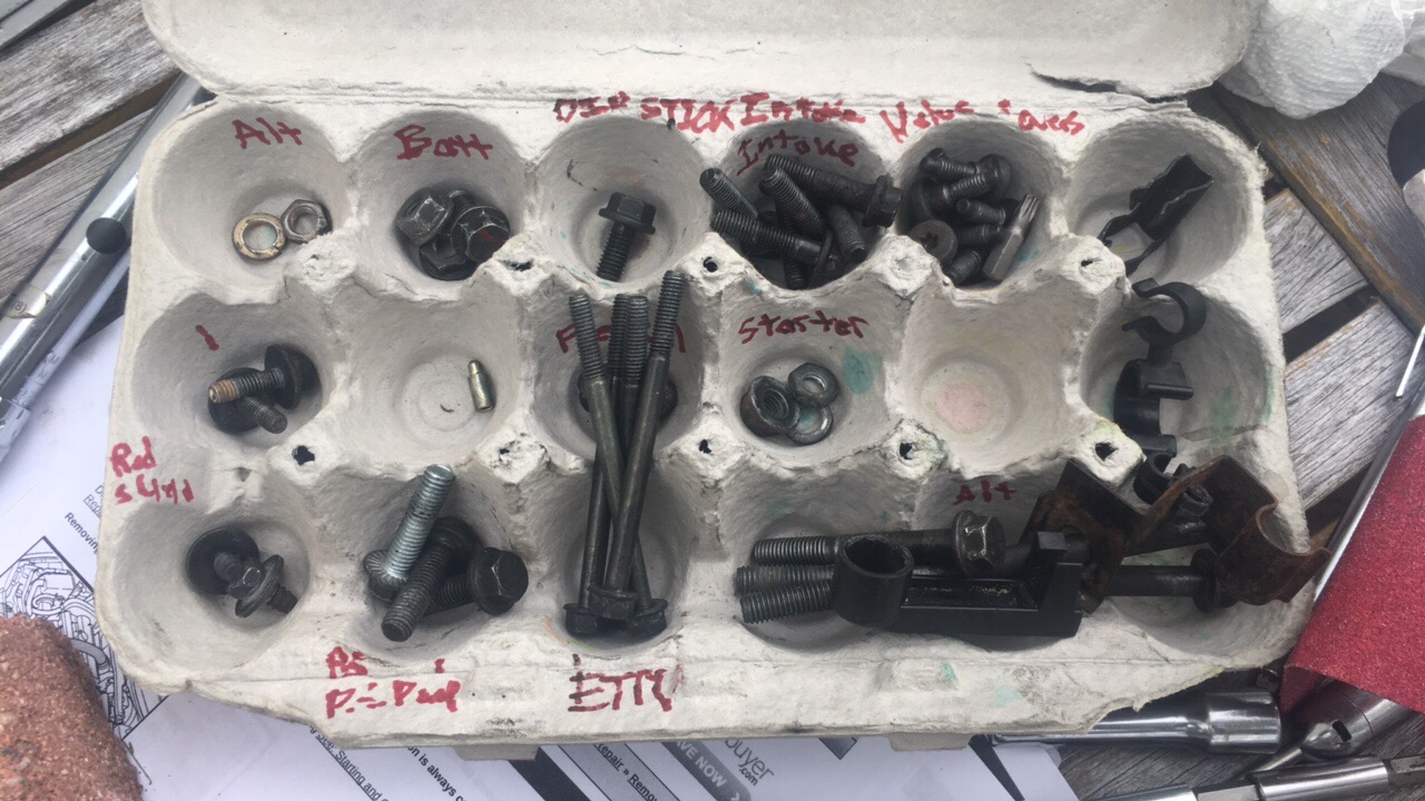

3. I used this organization method for all screws and nuts that I removed in the process of the job. Made things a LOT easier. I kept it on a work table a little bit away from the car so that it wouldn't get upended. Yes, I know my handwriting is bad. Incidentally, as I put bolts back in, I gave each of them a good brushing with a wire brush to remove any debris from the threads.
4. I didn't have any trouble getting to the lower left manifold bolt as others had noted. I used a 3/8" drive socket on an extension. Of course, I had also removed the fan shroud, the alternator, and moved the power steering pump, so maybe that made it easier. It seems like there are two schools of thought on these things - spend less time removing components and more time working out methods to get at the bolts, or spend more time removing components and less time working out how to get the bolts. I like the second way better, even if it does take longer.
5. I recommend draining some coolant from the radiator and removing the upper radiator hose to make access easier. Also, if I do anything like this again, I'd also drain coolant from the engine block, as it's pretty awkward to try and catch it from under the banjo bolts.
6. None of the tutorials I read or videos I watched covered *replacing* the long crankcase breather hose that runs from the PCV box back to the Turbo. They just covered disconnecting it at the PCV box, so that you could get the PCV box and attached hoses out.
7. I didn't have a hard time getting the banjo bolt off from the corner of the manifold, but again, maybe this was because I already had the alternator, power steering pump, and fan shroud out of the way.
8. The banjo bolt on the other end of the crankcase hose, back by the turbo, seemed like it was going to be tricky, and I spent a while figuring out ways to get at it. Then I realized that it was actually just covered by a removable plate held on with some pretty huge bolts. Once I took the plate off, it was pretty easy to get at that bolt. Based on my observations, the purposes of the plate appear to be: a) To serve as a mounting interface between the engine block and a bracket that consists of an engine lift eyelet and a guide channel for the turbo hoses, and b) To serve as a mounting interface between two of the engine mount bolts and the engine block. I have since replaced it and torqued it down pretty hard, which I felt comfortable doing considering the beefiness of the bolts and the fact that it needs to support the engine mount.

12. Here's the current state of my engine bay:
PCV system is all in place and hooked up except for connections to the intake, etc. I'm taking a break for tonight, and tomorrow night I hope to finish up by reinstalling and connecting the manifold, throttle, and injectors, and then all the other plastic pipes and components I had removed. I haven't decided whether to try starting the engine with the cracked ignition coil, or hold off until the one I ordered from eBay arrives on Friday.
