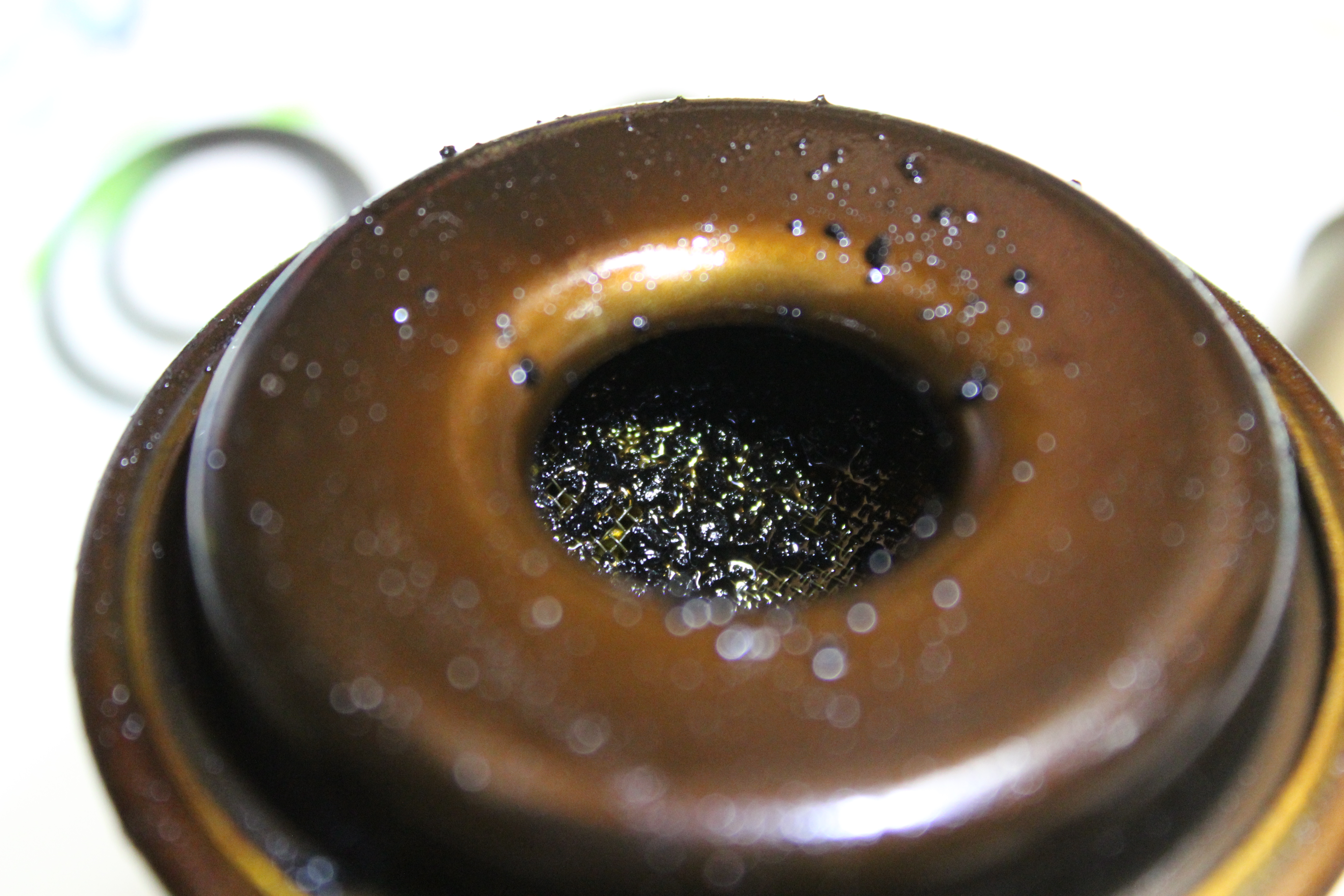

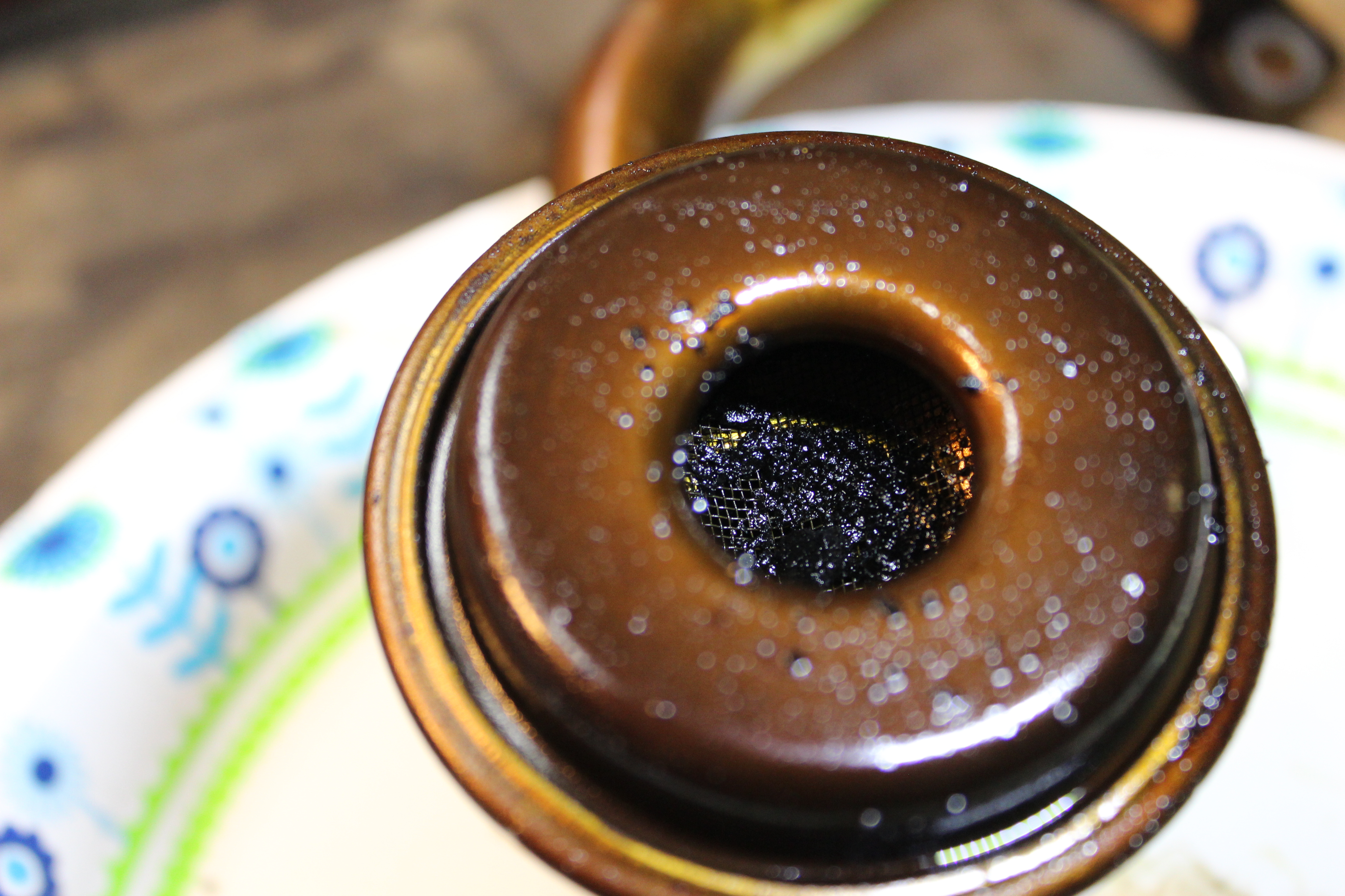

It may be hard to tell, but the entrance to the old style tube has a lip that protrudes inward, or, towards the screen. I know from experience that this lip truly does prevent at the very least, some of the junk from being voided from the bottom of the 'spaceship' & then falling back to the floor of the oil pan.

Edit: I knew I had taken pictures of the inlet to the pickup tube on mine, just crazy to me how such a small detail like the inward protruding lip could make that much of a difference on a sludge impacted engine. And equally as crazy how omitting that same oversight/tiny detail frees the pickup tube of so much junk.
