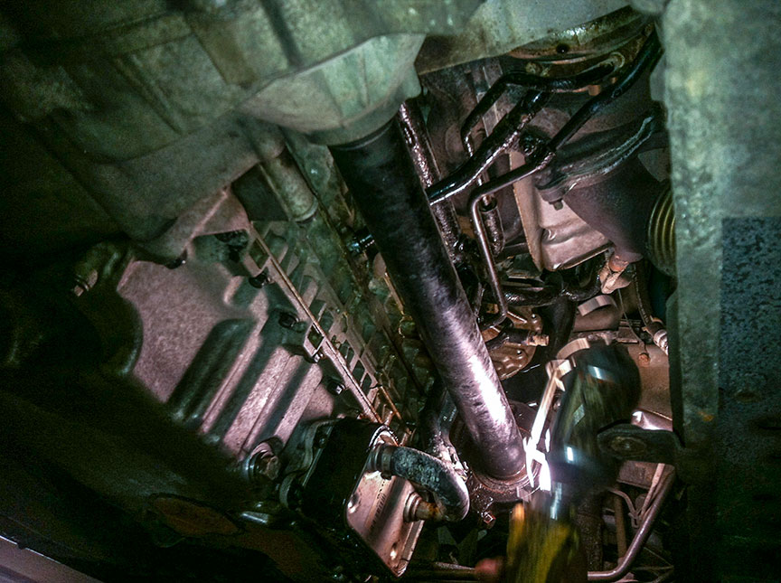

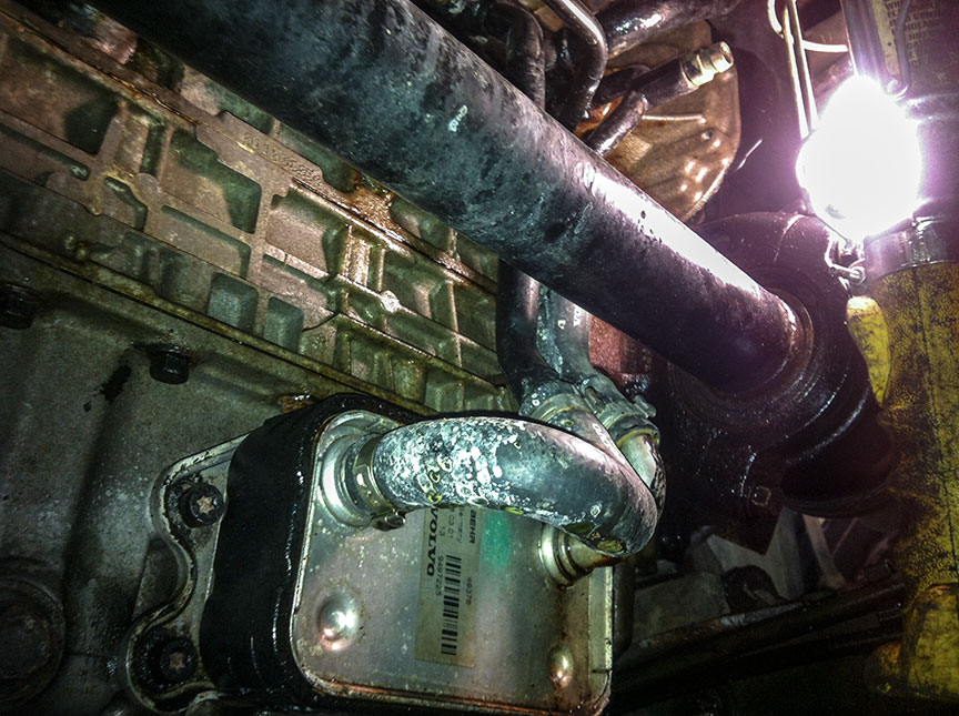

Thanks but it's not the turbo. The oil starts at the opposite end of the engine and higher up than the turbo. The axle is also clean of grease - some of the shiny parts might look oily because they are clean or a slightly oily mechanic's hand gripped it or, in the case of the turbo plumbing, the oil return line is new and the other lines painted. There is oil dripping onto the top of the right axle bearing housing but it's not originating there. Same thing with the turbo housing.
When I say the oil 'starts' at the other end, that is to say, when it all got scrupulously cleaned up, the first place it appeared again was at that RF corner of the engine and seemed to follow along the seam between block and head before eventually making it as far as the other end and dripping onto the turbo.
Head gasket makes the most sense in terms of the location but my understanding is there is no place oil is under pressure near the head gasket (unlike the B18 engine) so it makes less sense that way. Oil pooling in the head bolt cavities doesn't seem like a probably source. There is also so much stuff in the way it's hard to tell where it's actually originating.

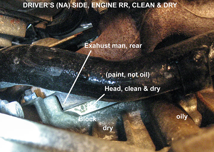

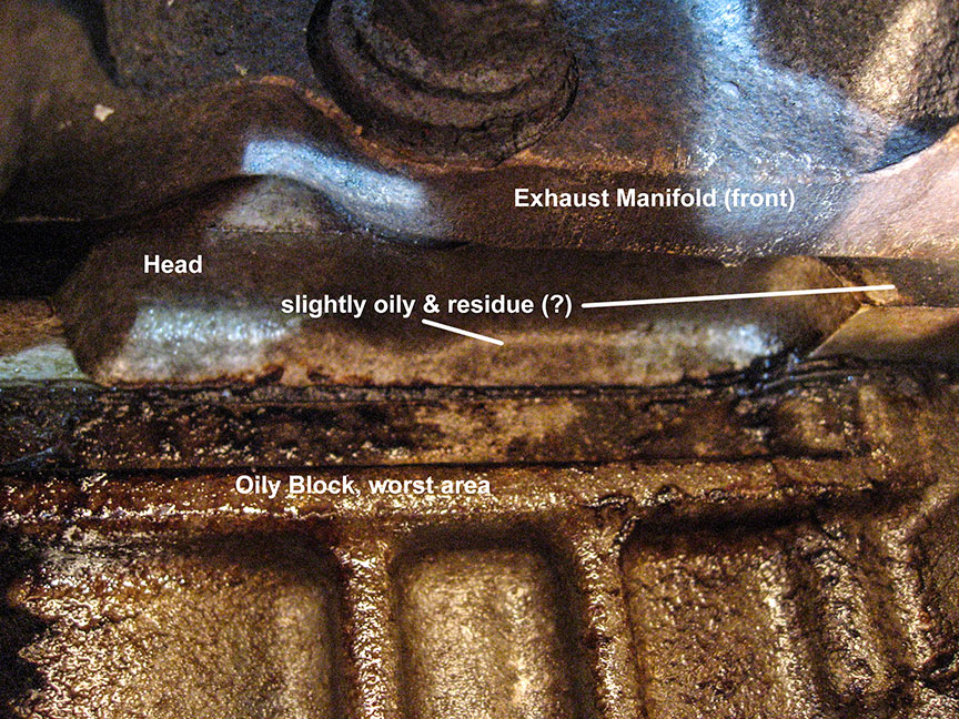

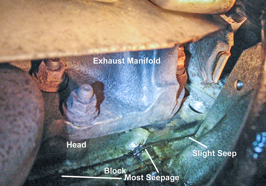

More photos of the crime scene.
If the oil were finding its way along the head gasket seam from the exhaust cam front then there would likely be a lot more drip & seep closer to the front of the engine and not as much where it is, right?
What's curious here (to me) is there appears to be a bit of oil uphill from the head gasket. Just wicking, maybe?
