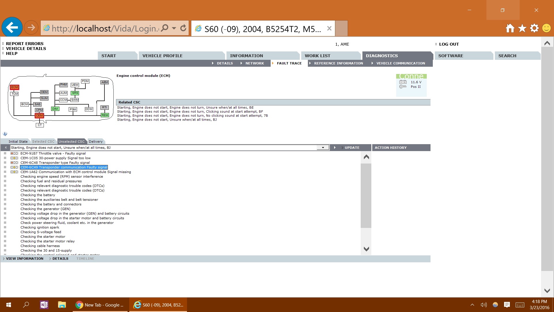

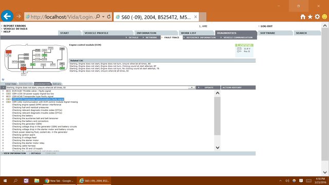

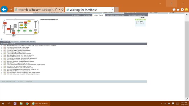

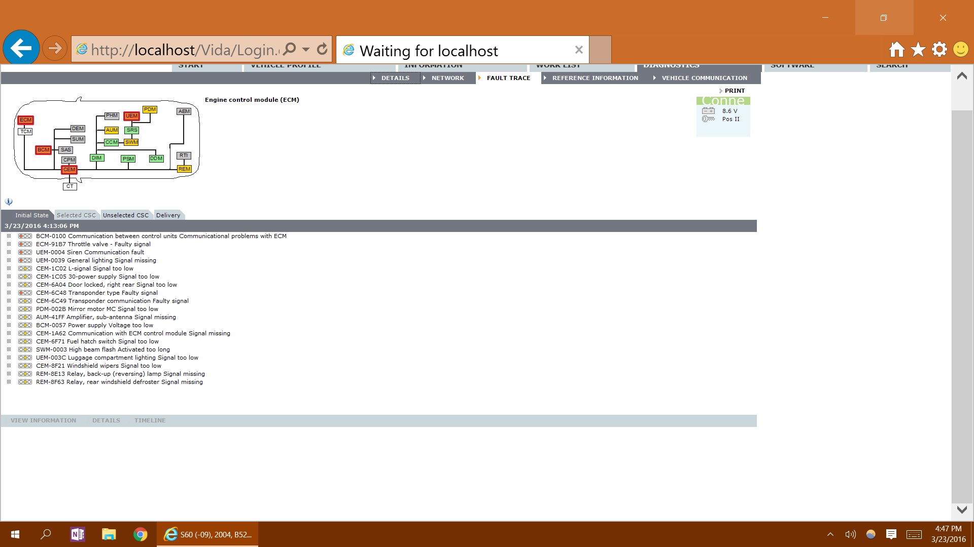

As mentioned before, I did go ahead and get VIDA. Maybe this can help shed some light on the issues. I was able to get the Volvo specific diagnostic faults:
Please let me know if there is something more relevant that can be grabbed...
I attached two images. They are screenshots of the diagnostics.
The codes under "unselected CSC" are:
ECM-91B7
CEM-1C05
CEM-6C48
CEM-6C49
CEM-1A62
The second fault picture has even more codes that could pertain to the issue...

You do apply dielectric grease to the pins but just as a corrosion inhibitor. Volvo service instructions for electrical connectors always calls for dielectric grease. This is confusing but the grease will not prevent connections when it is dielectric. You can't use conductive grease in electronics due to the chance of cross connection through the grease. There are special application conductive greases that are expensive and are applied VERY sparingly but they have for the most part been dropped from use in engine compartment due to the potential for the grease running and making connections between pins.
The throttle potentiometers in the ETA must have good signals back to the ECM or there will be codes. That system is not tolerant of not being to track throttle position via the two different pot signals being in agreement to a very small allowed deviation. The pins associated with throttle at the ECM connector also have little allowance for poor or corroded connections.

Use Delivery tab for current codes. Some posters have been able to buy the wire from dealer and solder in. Search forum as there may be a part number. Remove the throttle and take a good look at the pins.. Make sure you use contact cleaner not throttle cleaner.

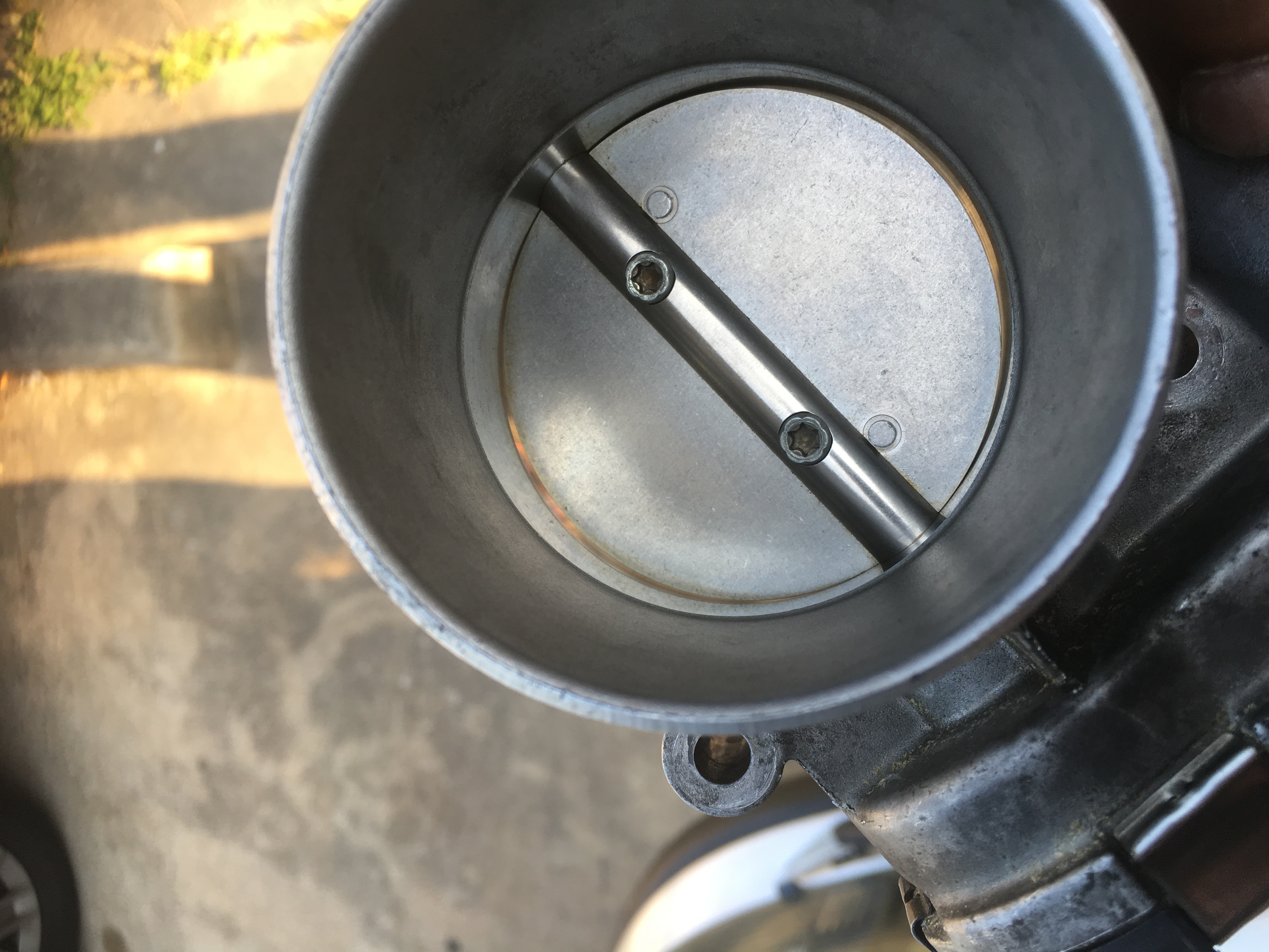

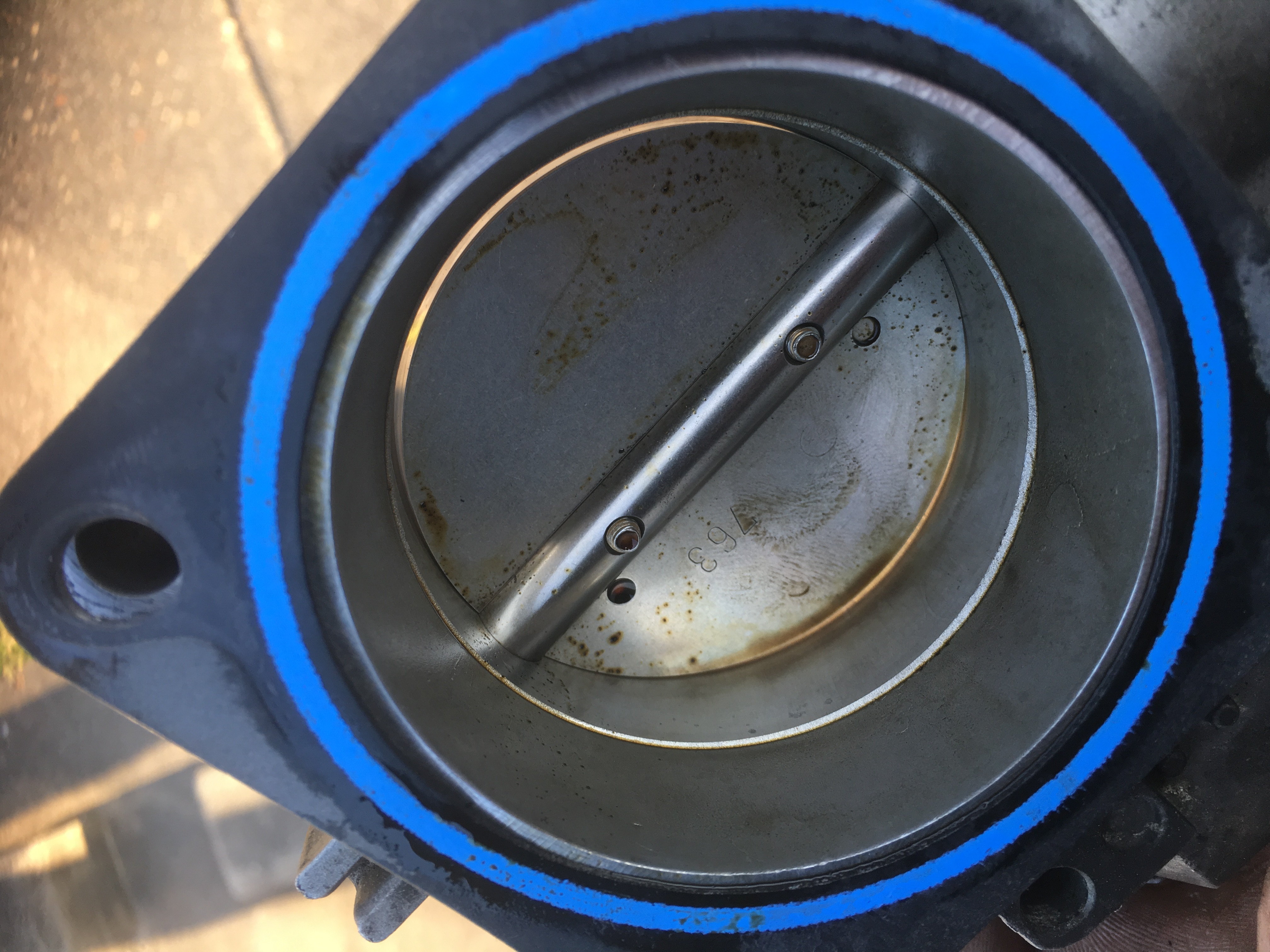

Thanks you all. Okay, so I finally got around to removing the throttle body and it had oil in it- I think the substance was oil at least. It was on the side that connects to the intake manifold. The side that connects to the hose was clean. I think it was actually oily inside the hose, although. Mind you, I just cleaned the throttle body about 2 to 3 weeks ago. I am going to put the new (used) one in that I bought and see how it fairs... I am cleaning the new (used) throttle body with throttle body cleaner and the connectors with contact cleaner. I am thinking of applying A LITTLE DAB of dielectric grease to the connectors... right? I attached some more pictures for reference.
Do you all have an idea, why an oily substance would appear? I am due for an oil change, don't know if that's related.
Side that connects to the intake manifold directly: Side that connects to the hose:

If the intake manifold and air induction tubing are heavily oiled you could just be getting residual oil carrying over. If that's fresh oil from the motor in 2-3 weeks, that's really heavy oiling and PCV or rings need attention.
I don't think this is causing limp mode, though.
