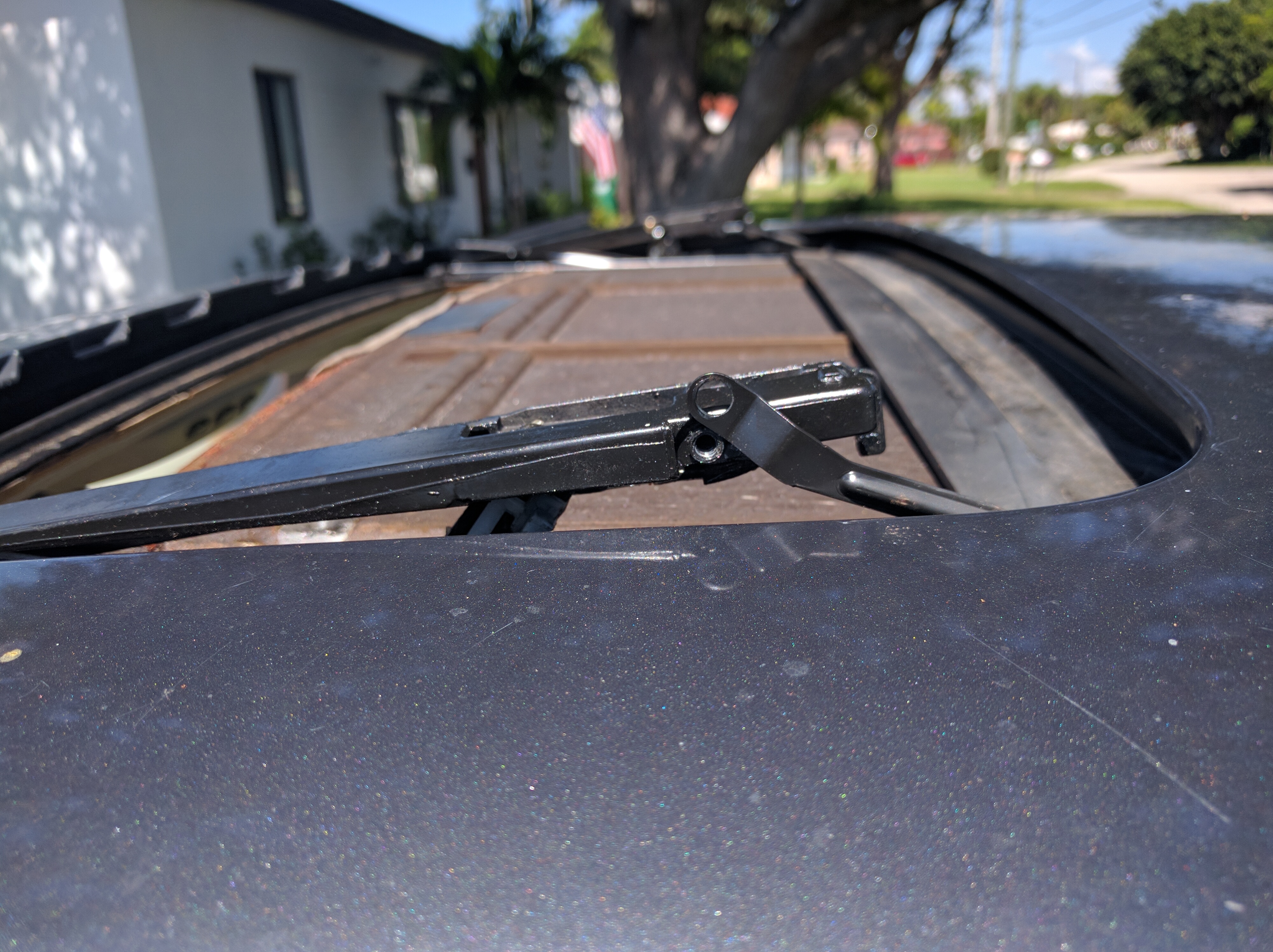

I removed the sunshade on my 2006 S60 last week and I took some nice pictures I could share with you. I will mention which item in asc325is's list it is.
#4 After you remove the glass you have to undo these two screws (each side one screw)
#5 slide forward the cross piece so it looks like this
#5 And remove the four screws
You should be able to remove the rear spring clips and remove the sunshade now. If you want to drive without the sunshade be sure to put pack the cross piece so no water end up on your seats (ask me how I know it) and put back the two latches with screws.
