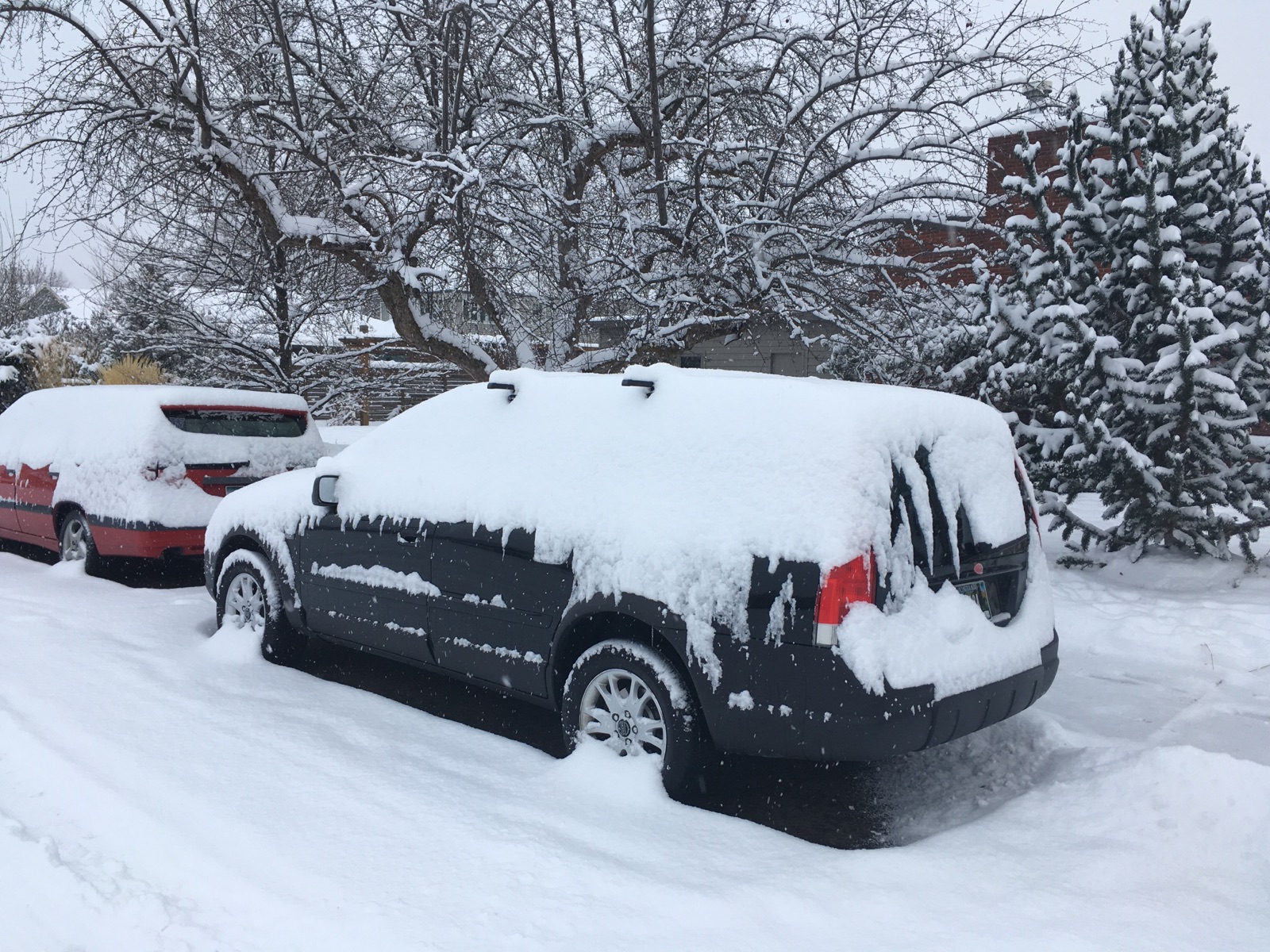

Here's Bart this weekend...

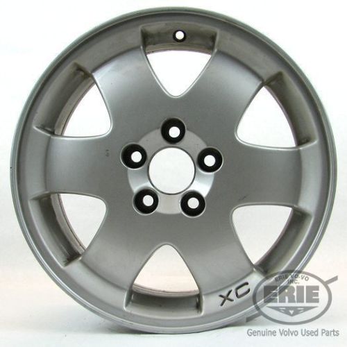

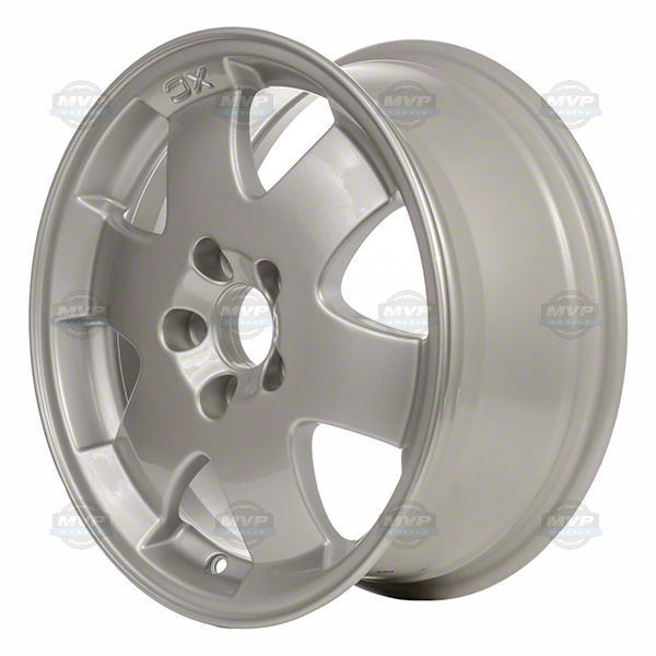

I'd like to get the OEM 6 spoke wheels and keep these for winter. Is that called a TELLUS? I love that wheel.
