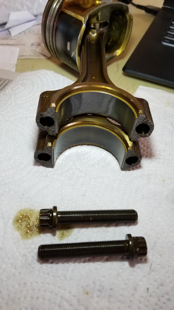

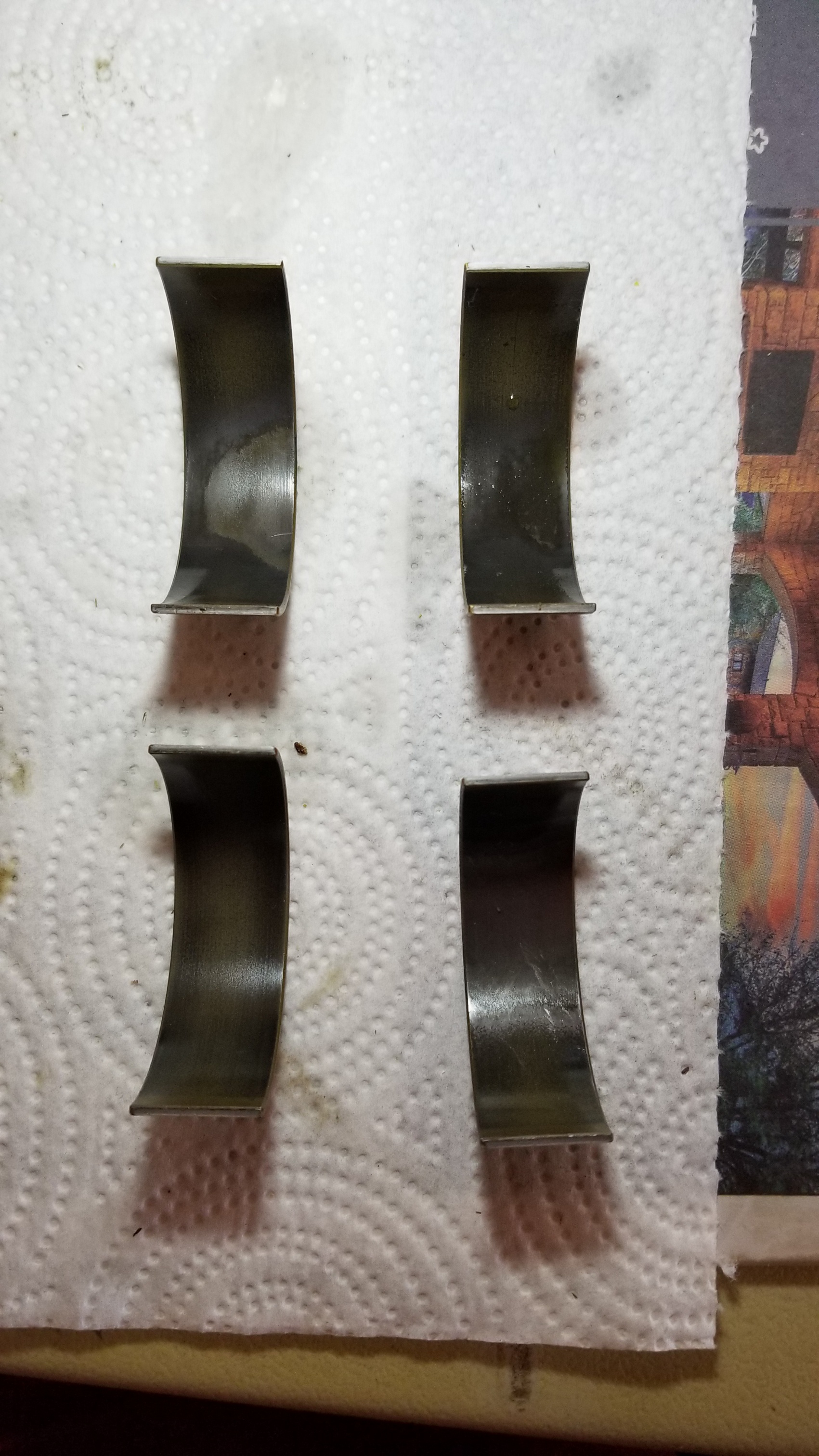

I tried to capture a couple pictures, it's harder than I thought. To me it looks like a little amber is showing through on the bottom bearing shell. I'm guessing that in near perfect health the bearing shells should be shiny & not blurry with no amber?
On the other hand, the crank journal looks, I dunno, you tell me. I'd say better than the bearing.
jimmy57 wrote: 23 Oct 2018, 08:43 You have ZERO tolerance for putting cap on wrong and then running bolts down and drawing the parts together when not installed in the right way. If the grain of the faces gets injured then the rod cap will not close on rod and the bearing will not be retained where it will not spin and fail.
I marked the rod cap & the front bolt so I couldn't put it in backwards, got that part right at least...
I was trying to be so, so very careful. Backed the bolts out one at a time while holding pressure on the cap, then was gently wiggling the rod cap to get it free & just as it came loose it slipped right through my gloved hands & hit the floor. Should have left one bolt in the rod, just backed out a couple turns. Oophta.
Photos relating to this paragraph are below. I can see one of the corners of the bearing shell looks like it has tiny bruise on it from contacting the floor or one of the tools laying there. If it run my fingernail across that "ridge" I can feel an imperfection. I am unable to tell for certain if the cracked surface of the rod cap contacted the floor, but I do see a shiny spot on the one "ear", on the same end & side of the cap as the corner of the bearing shell that got bruised.
I now grasp how critical it is to maintain perfect mating surfaces with cracked rods.
I will take a closer look at the rod end to see if the "shiny" spot on the cap has a mate on the rod end.
Shiny spot & bruise on corner of bearing shell
Upon closer inspection of the bottom of the rod it looks like I might have incorrectly thought the worst of that shiny spot. Well it matches up perfectly with a shiny spot on the bottom of the rod so I think I'm ok there - no contact was made between that face of the rod cap and the ground. Just the bearing got bruised thankfully! Holy rollercoaster the last 24 hours.
So after all that, I suppose I'm looking at replacing at least the rod bearing shells on at the very least rod#5?
I'll go back & clean this post up tomorrow when I have more time, get rid of the unnecessary verbiage.

The bearings shells look FANTASTIC. it does not look like the rods suffered any lack of oiling.
On rods the force is down so the bottom shell will look better and the oil residue will color it amber. They start dull silver but by 50K miles they will usually be stained some. Those look completely re-useable.
The bottom would get injured too if oiling was a problem.
Rod journal on crank looks good.
Before you get all down and out get plastigage and measure that rod bearing clearance on that rod with it torqued and angled maybe 45 degrees. The angle stretches the rod bolt a bit but the torque and half angle will give you a reading you can evaluate without adding a full stretch cycle on those rod bolts. If the clearance is .002" or less put it back together and don't think about that one.
