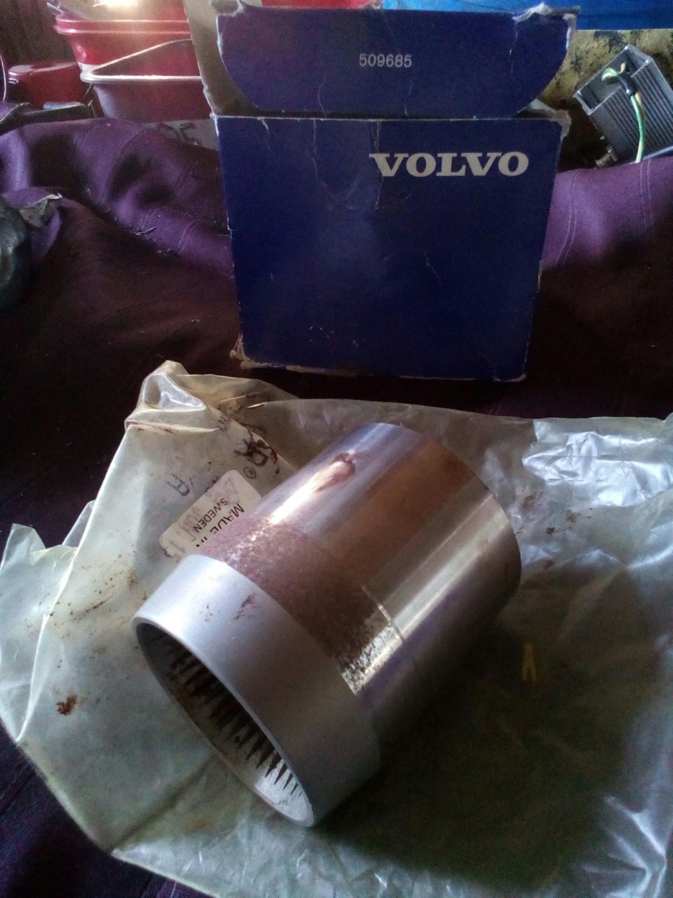

thanks for the post, i dont have an air chisel. I hope my collar sleeve wont be as difficult. Ive removed one before using a channel engine support, removed the fender and used the body and a blowtorch to pull it free. This time i will try using a bearing puller and heat first before removing fenders etc
Talk about soft metal, the things already rusting and its been sitting on the shelf. I hope it doesnt interfere with the oil seal
