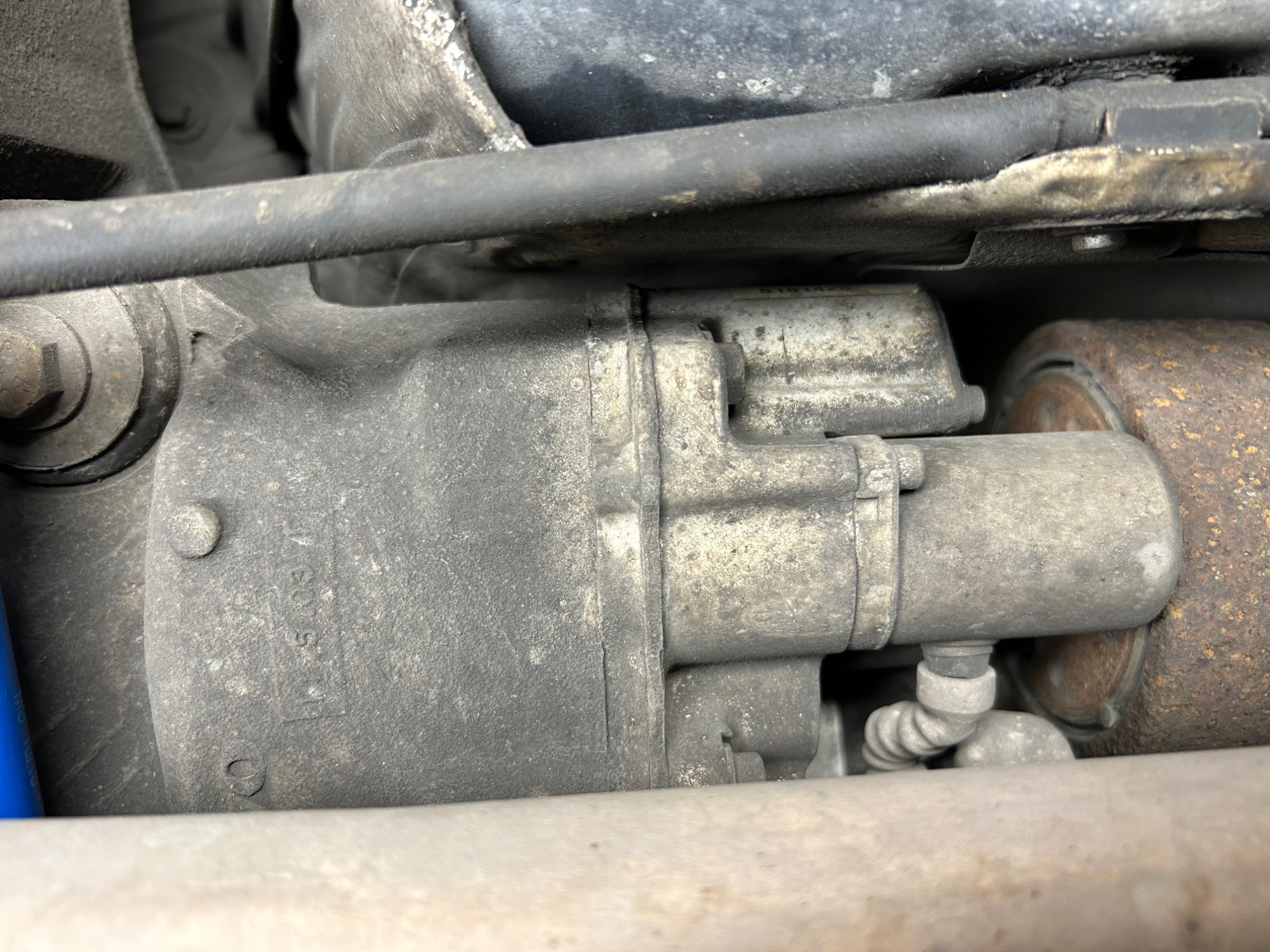

No you don't need to take the shaft or flange off to do the filter and fluid.
Prop shaft and Haldex service '07 XC70

Yeah, those guys…
Laughing about “Jello shots,” wasn’t sure whether to take them seriously..
Are they trying to take out the wrong allen to drain and there isn’t a drain? Just the fill plug on the upper left?

I ran out of time so I didn’t dive into this. It’s working fine. Bone dry, doesn’t seem to have any leakage. 20 year old oil? Yes.
