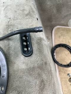

replacing the fuel pump on a 2002 S60 with a plastic tank. Found that the return line was broken off whatever it is supposed to be attached to. Dropped the tank and can't find anything that looks like an attachment point. Anyone know what the return line is supposed to attach to?

Nothing in the diagram but I figured it out.
A previous owner replaced the fuel line from the pump to the filter. When they did, they eliminated the T back to the pump return port.
I added a T back to the return port and now have correct fuel pressure
