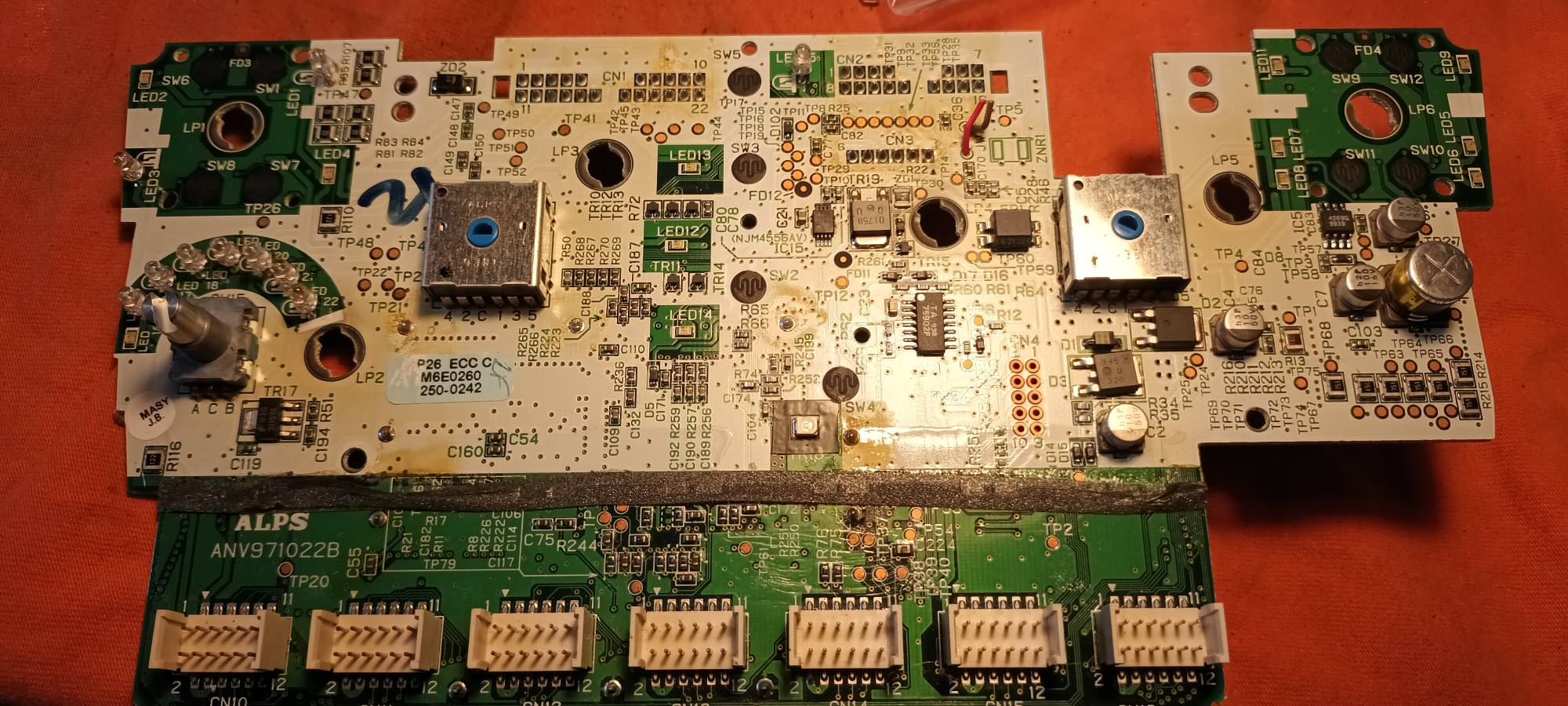

oh haha today has been very weird. what where are the can transeviers? can you please point them out?
CCM pcb
CCM pcb
