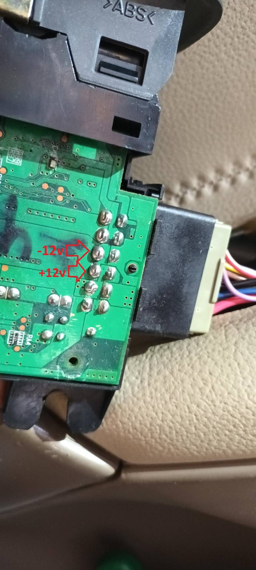

Faulty DDM Drivers Door module.
Fault: Intermittent low voltage output (@4volts)to window motor instead of 12v.

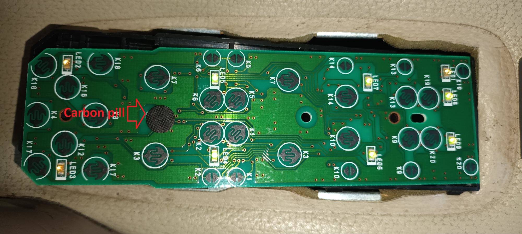

VIDA shows switch carbon pads are working okay, VIDA also intermittently cannot operate window, but shows button "activated"
Fault code DDM 0005 signal low or missing
Reflowed solder on output pins, no change.
Checked voltage output pins and confirm intmt low voltage.
Two 12volt input pins and ground check good. 12volts checked at door hinge connector all good
*Tested switch pad works with a carbon pill.
*Window motor swapped with a better sounding one,with scissor arms
*Regulators replaced and greased
*Window not binding when it does work, goes up and down smooth
*VIDA configuration completed with 6mm soft stop.
Could it be relay(A) or whatever that (B) thing is (looks like a voltage regulator??)
PCB DDM reflowing solder joints
DDM pcb repair.jpg (81.72 KiB) Viewed 255 times
Testing switch with carbon pill

Ive checked the connector at the hinge (not easy to get at). the voltages and communication at the DDM all check good, its just the voltage to the motor. Its defiantly a faulty DDM
