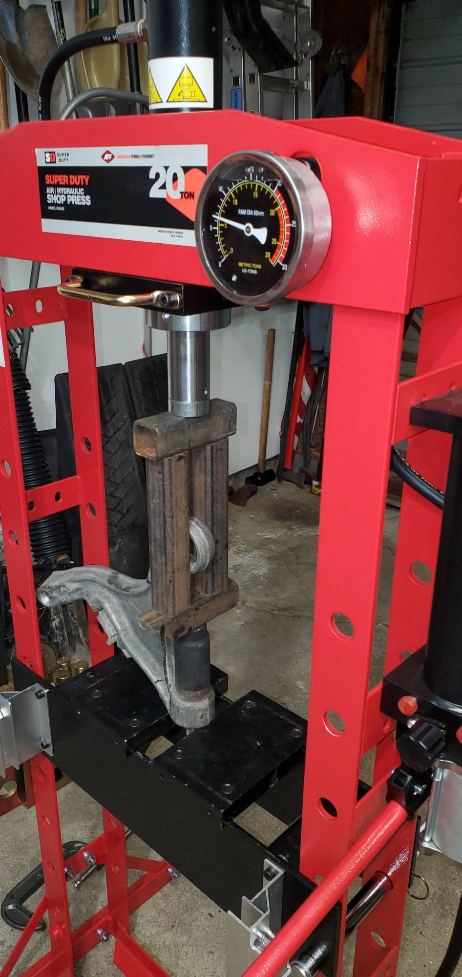

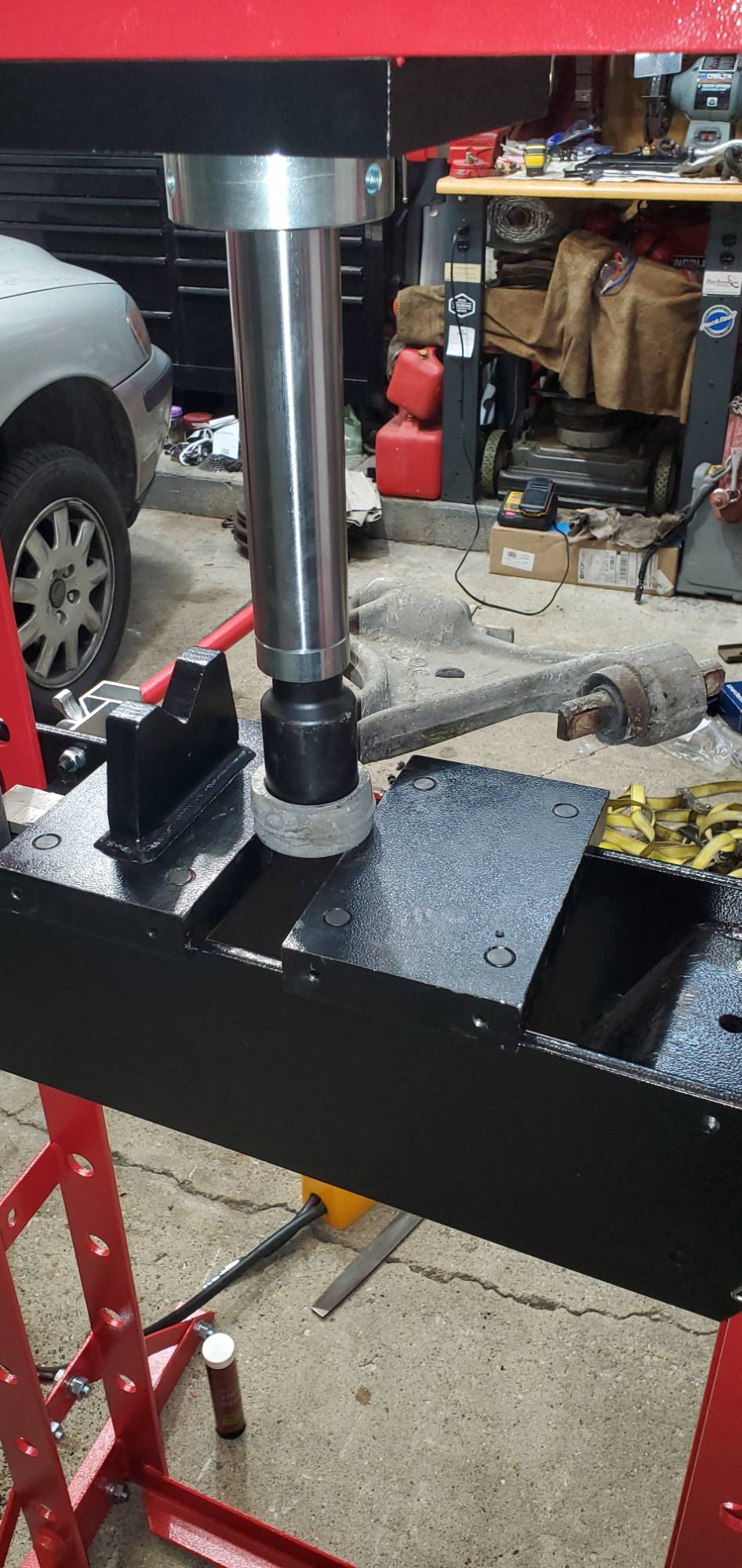

Removing the lower control arms is difficult the first couple times. Replacing the bushings is not easy unless you have a hydraulic press. Buying the 4 new bushings is much less expensive than any other option - get the OE Lemforder brand. Here are a couple pictures of how I pressed out the bushings using a friend's hydraulic press. The Harbor Freight press mentioned by VTL above would work similarly.
I used big sockets for pressing the bushings. The one bushing is in-line with the other so I used scraps of steel to get the press force around the joint that was in the way. The Vida instructions for this procedure are very detailed and helpful. Volvo has some small hydraulic press tools that are even easier to use than what I show in the pictures above.
