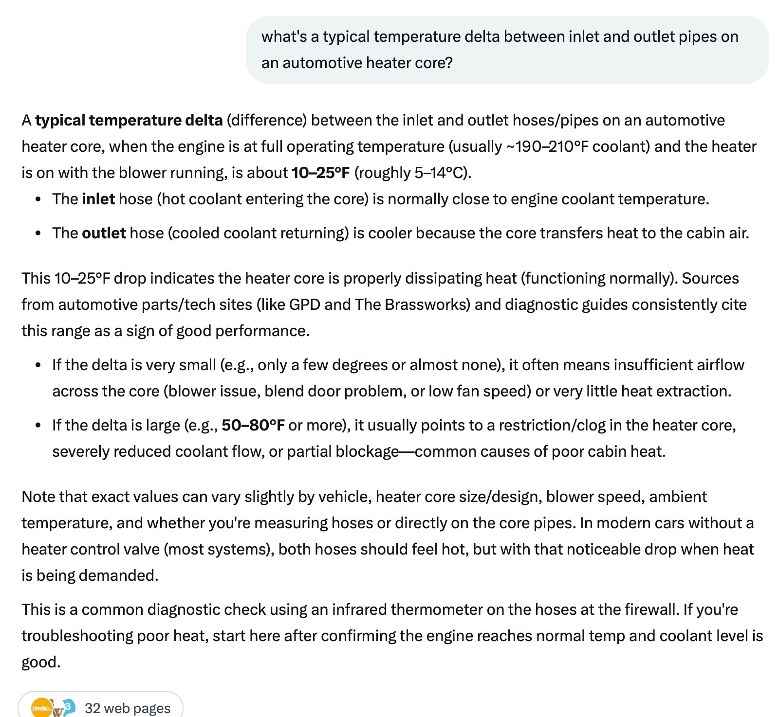

This post got me wondering what a normal temp delta is, and according to AI yours is good. I don't think it's the heater core.

As Matthew’s attachment points out, the inlet temp should be somewhere close to engine temp which would be in the neighborhood of 185-190? Benbug is seeing 140. I would be surprised if there is really a 45 deg drop in temp in the hose between the engine and firewall.
