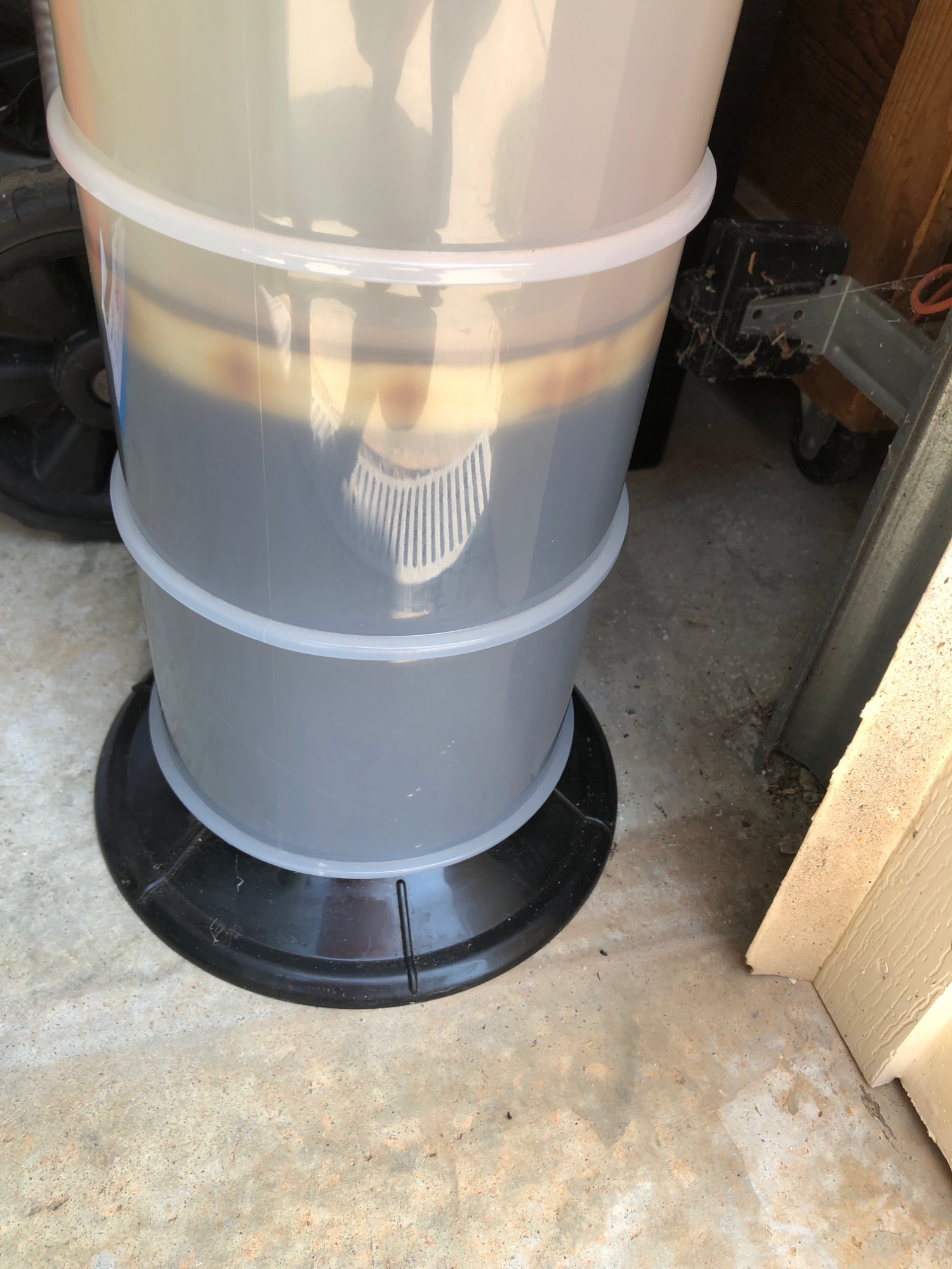

Have been extracting motor oil, transmission fluid and master cylinder brake fluids since 2019. Upgraded to an 8L unit so do not have to pour out during an oil change. Unit doesn’t extract well if it’s too full. Not having to drain the motor oil and pouring it into a container then cleaning the drain pan is well worth the extractor’s investment, not to mention the time savings and great benefit of cleanliness. Just pour into a 5 gallon water jug and it done and no mess.

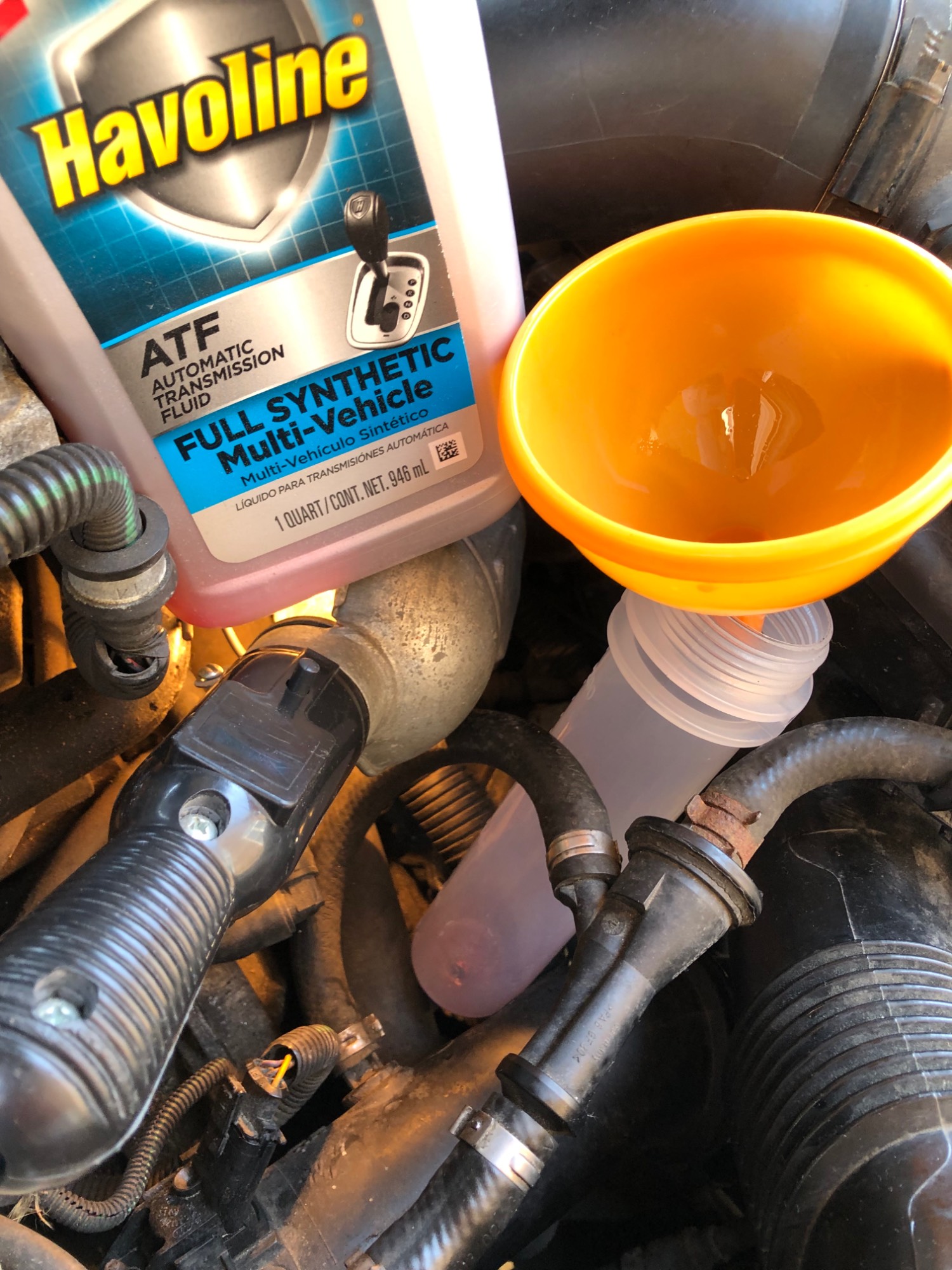

This is a transmission fluid drain and fill for the 2002 V70XC. You can continue with the Gibson if you choose. I rarely just do a drain and fill but wanted to see if the transmission was okay with the Synthetic Multi-Vehicle 3309 equivalent. The fluid is not as dirty as it looks. Using the new syringe to put fluid back in. Initially purchased it for the transfer case.
Wasn’t paying attention so didn’t realize the second section of hose is for extra length rather a different size opening. Wouldn’t need the funnel had I discovered this earlier.
