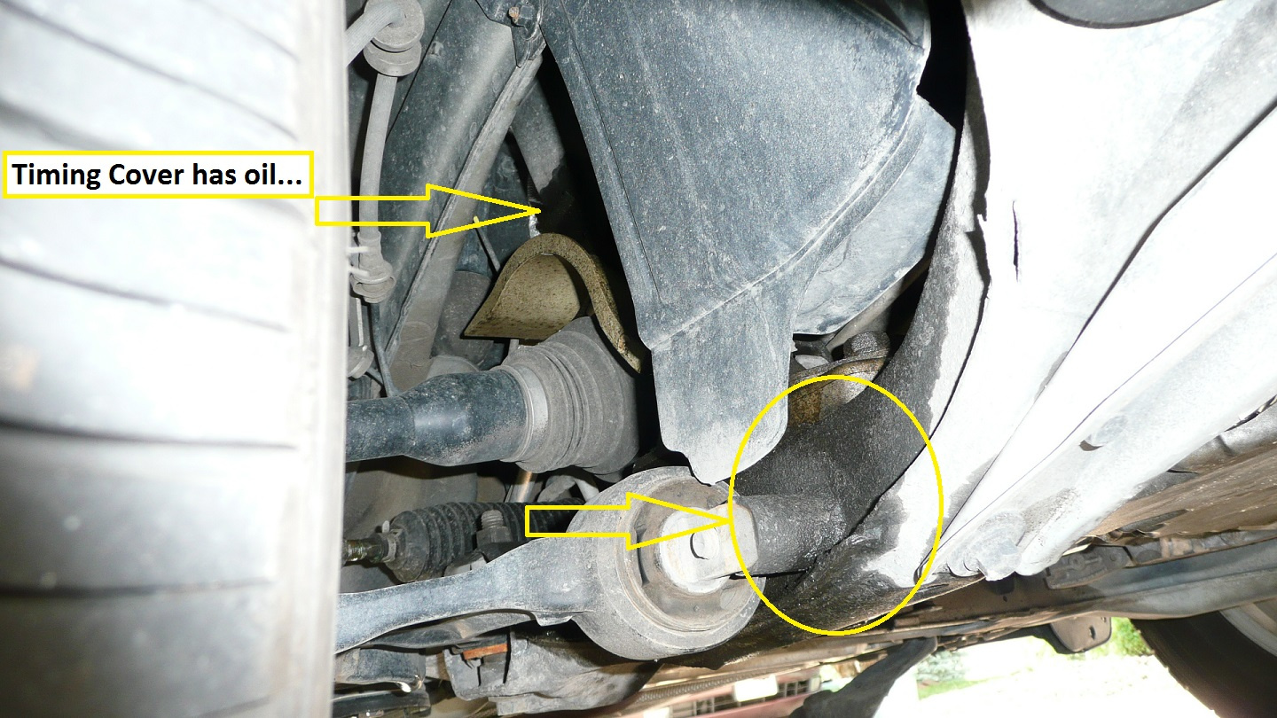

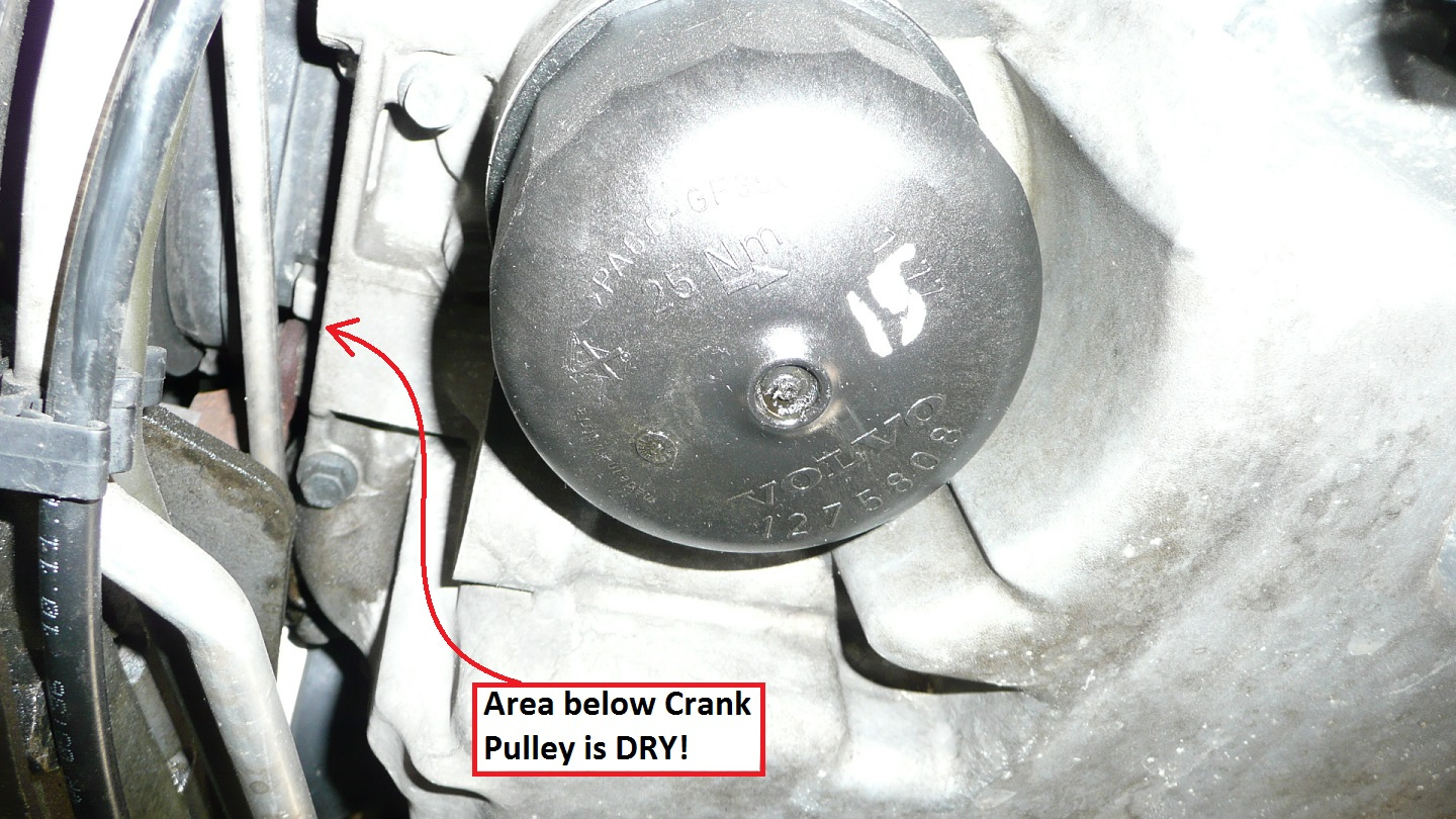

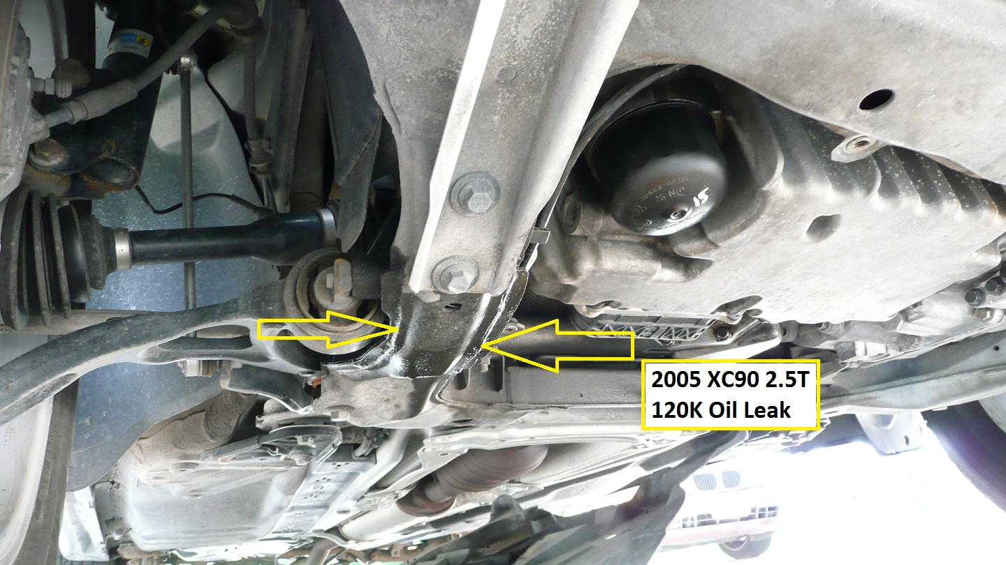

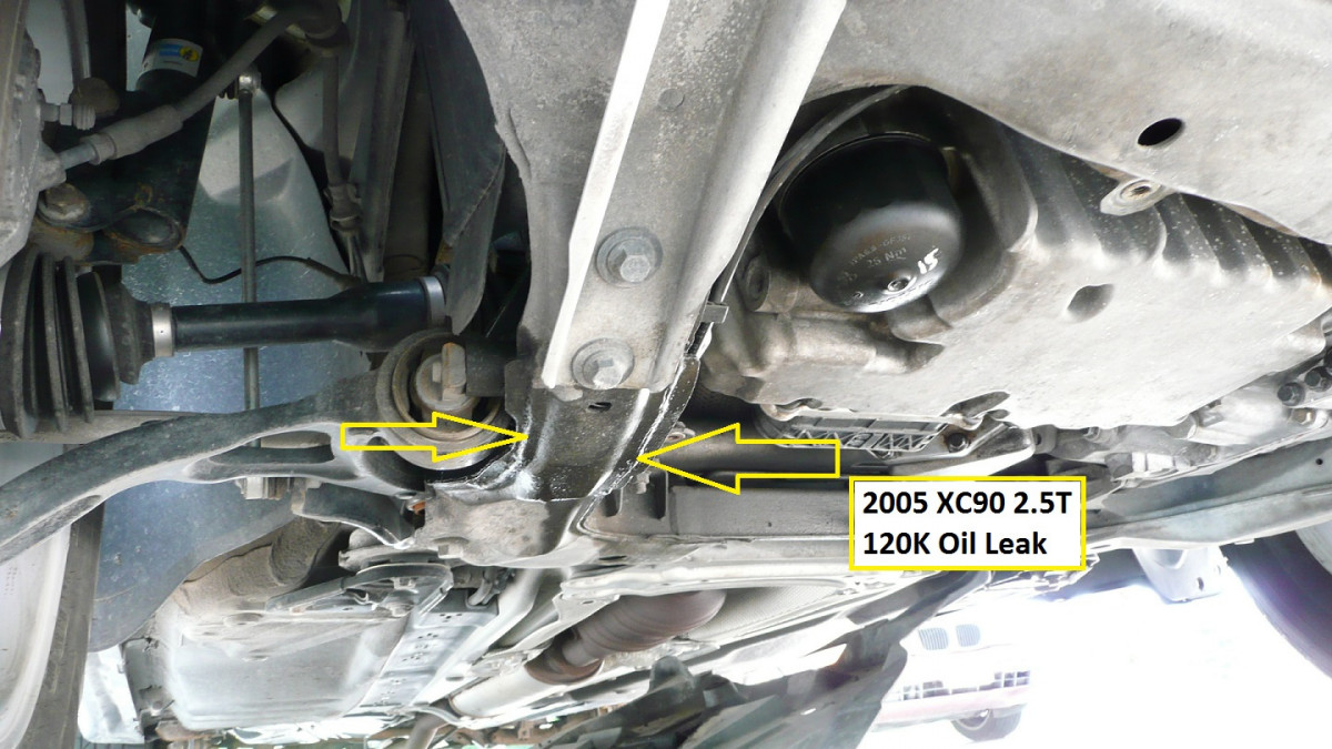

I just took some photos of my 2005 XC90 2.5T with 120K miles...
- If you have a shop change the seals, then do all 3 (cam x 2 and crank x 1) to save money later on labor.
- Since I do my own and I rarely see a crank seal leak before 180K-200K, I will replace cam seals x2 and leave the crank seal alone for now. I can always do the crank seal later w/o the need to remove the VVT hubs (and locking the rear of the camshafts)...
- Here you can see oil on subframe and timing cover. The area below the CRANK pulley is dry.
