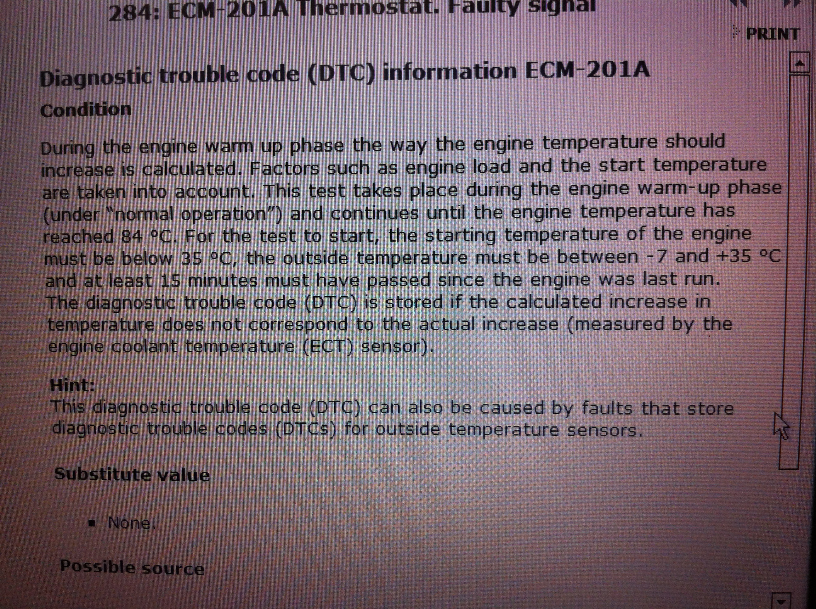

Wife's 2001 T5 (147K) triggered a CEL on Monday...saw this code and reset. After several days of similar driving it showed up again today. At this time temp gauge is getting to proper temp and heat feels fine.
What is the true failure trend of this fault? Bad thermostat, sensor, wiring, ghost?
I haven't done my research to even determine where a t-stat is located. I read the Vid Dice description that basically stated if the temp increase from cold start doesn't follow the pre-determined chart then it triggers a fault. I would assume shows slow to close as the car warms, but again (for now) internal temps seem fine. There was also mention of external temp sensor triggering the unit.
ECM-201A Thermostat- Faulty Signal
