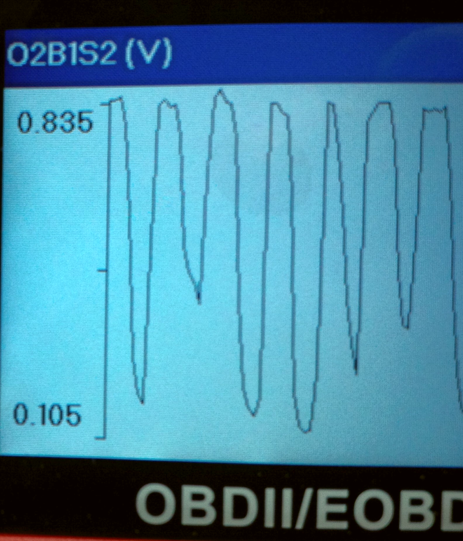

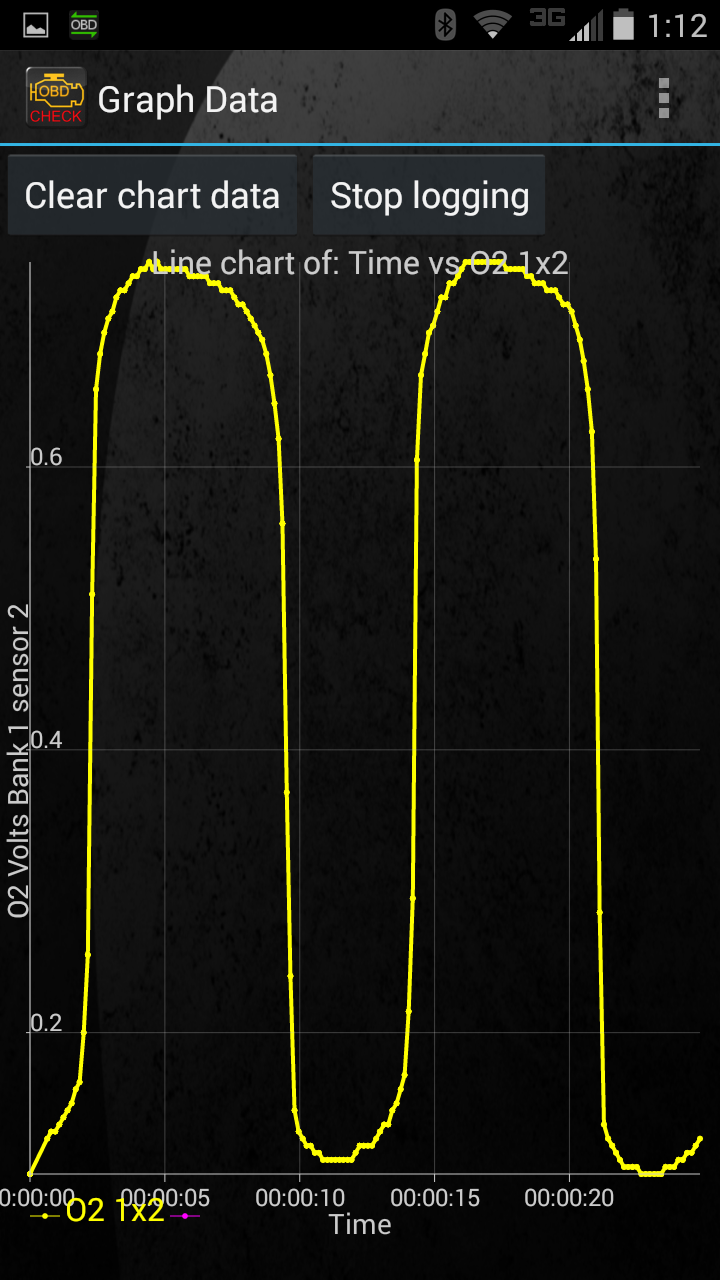

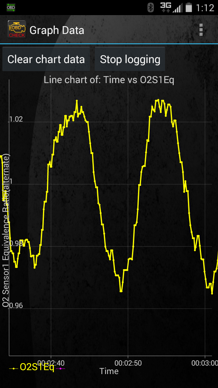

Looking good, fuel trims in single digits show that everything up to the cat works as it should. I'd try to graph o2 sensors with scanner, see if you get waveforms like attached.

Here are the O2 Sensor graphs while driving at hwy speed

Not sure why you're getting the CL fault, it's as if ECU does not receive O2 info and reverts to map, so I'd check the coolant sensor and O2 sensors circuit to make sure connectors are clean and tight.

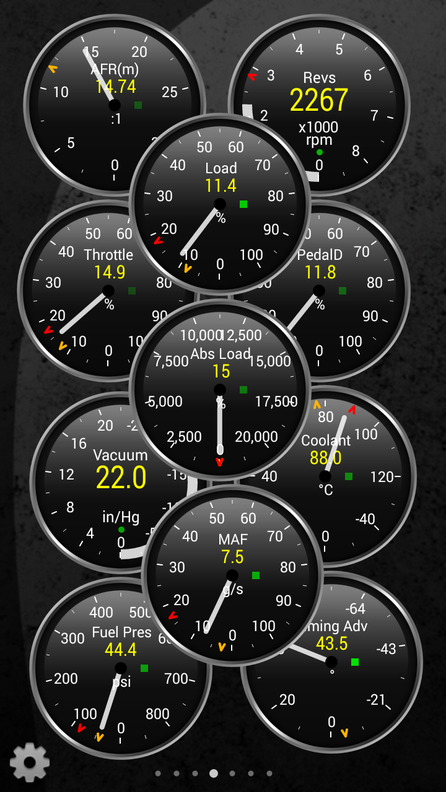

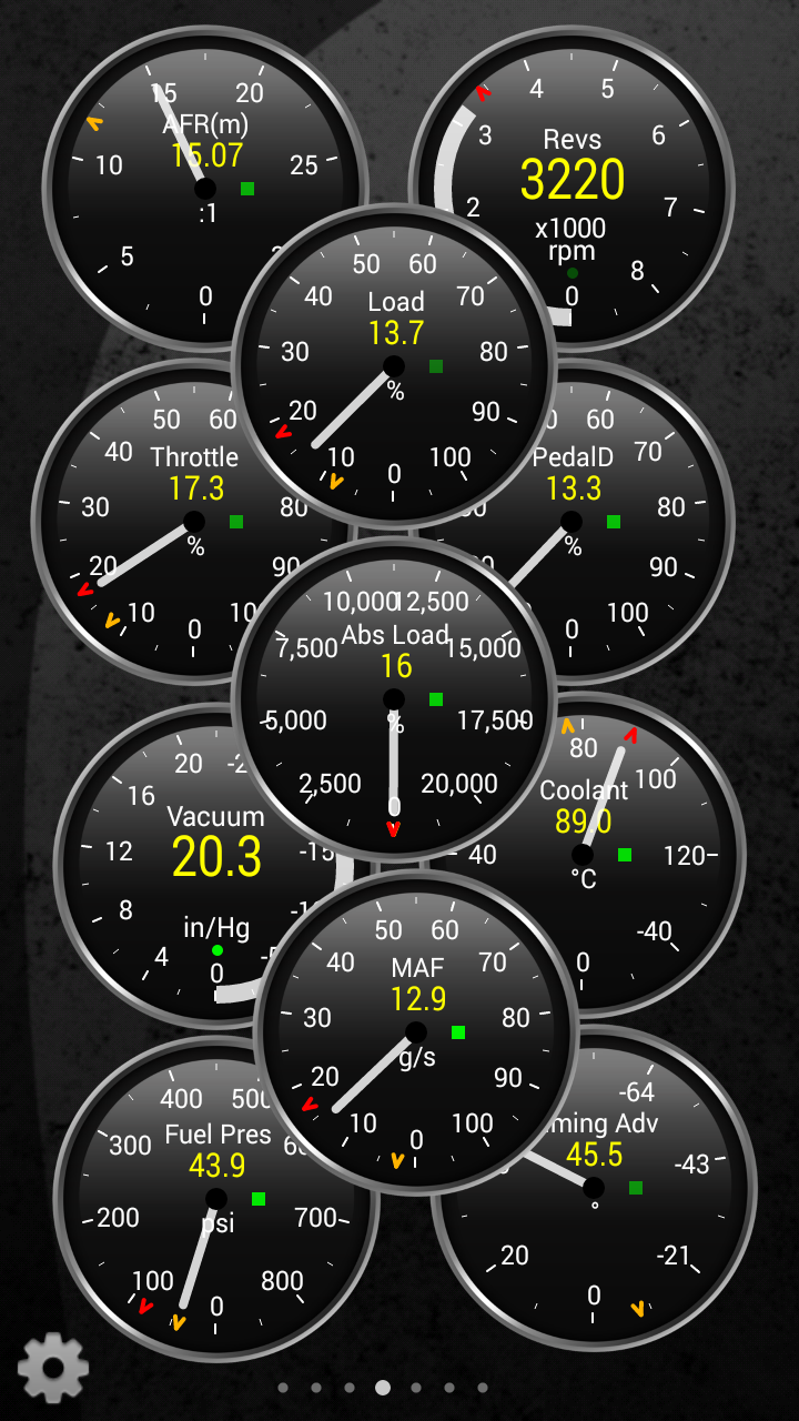

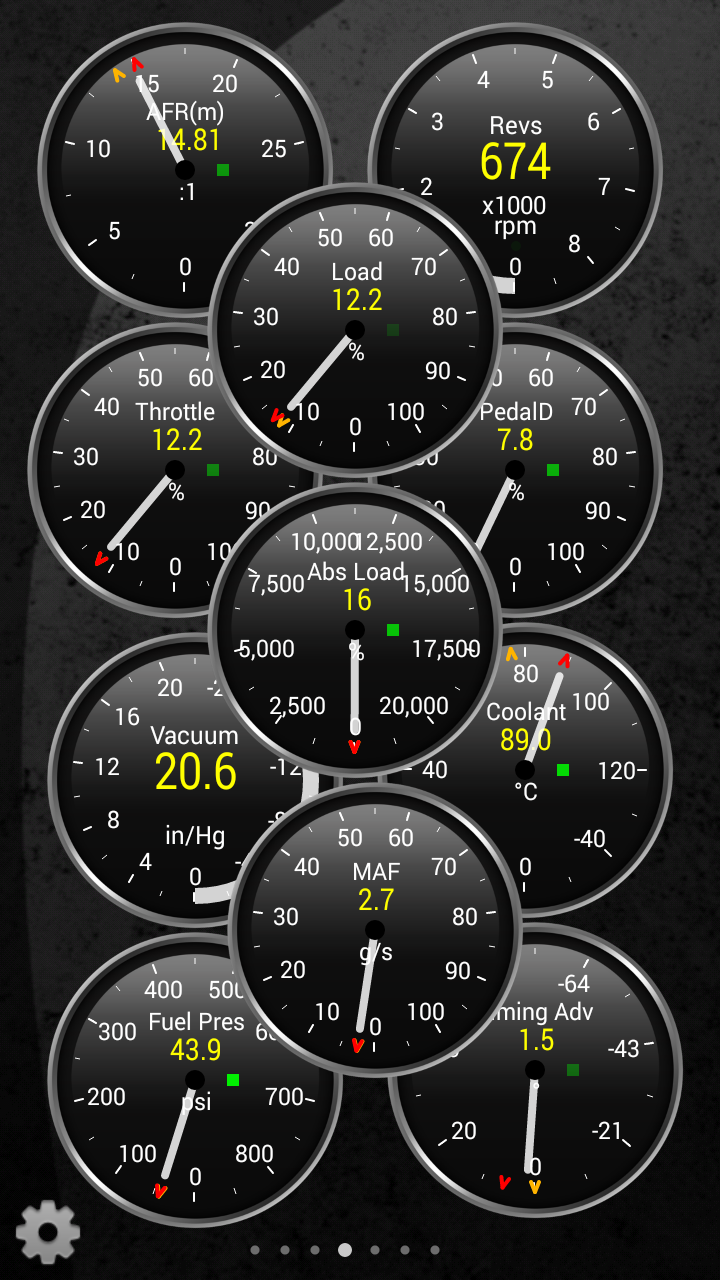

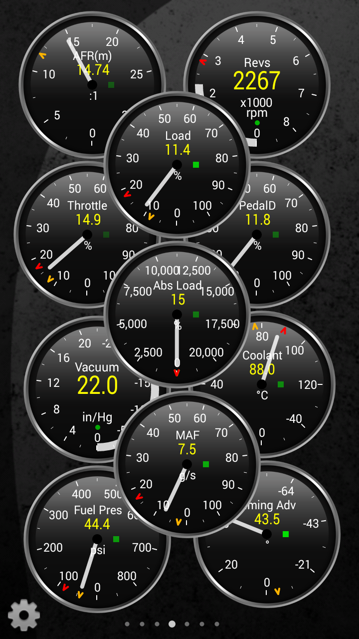

Just took a few readings on my car at idle, 2300 and 3000 rpm. Engine load stayed low at12-13%. My car's a turbo but I don't believe it'd be much diff than N/A. You may have a clogged cat based on your load readings. I attached the screen shots.
