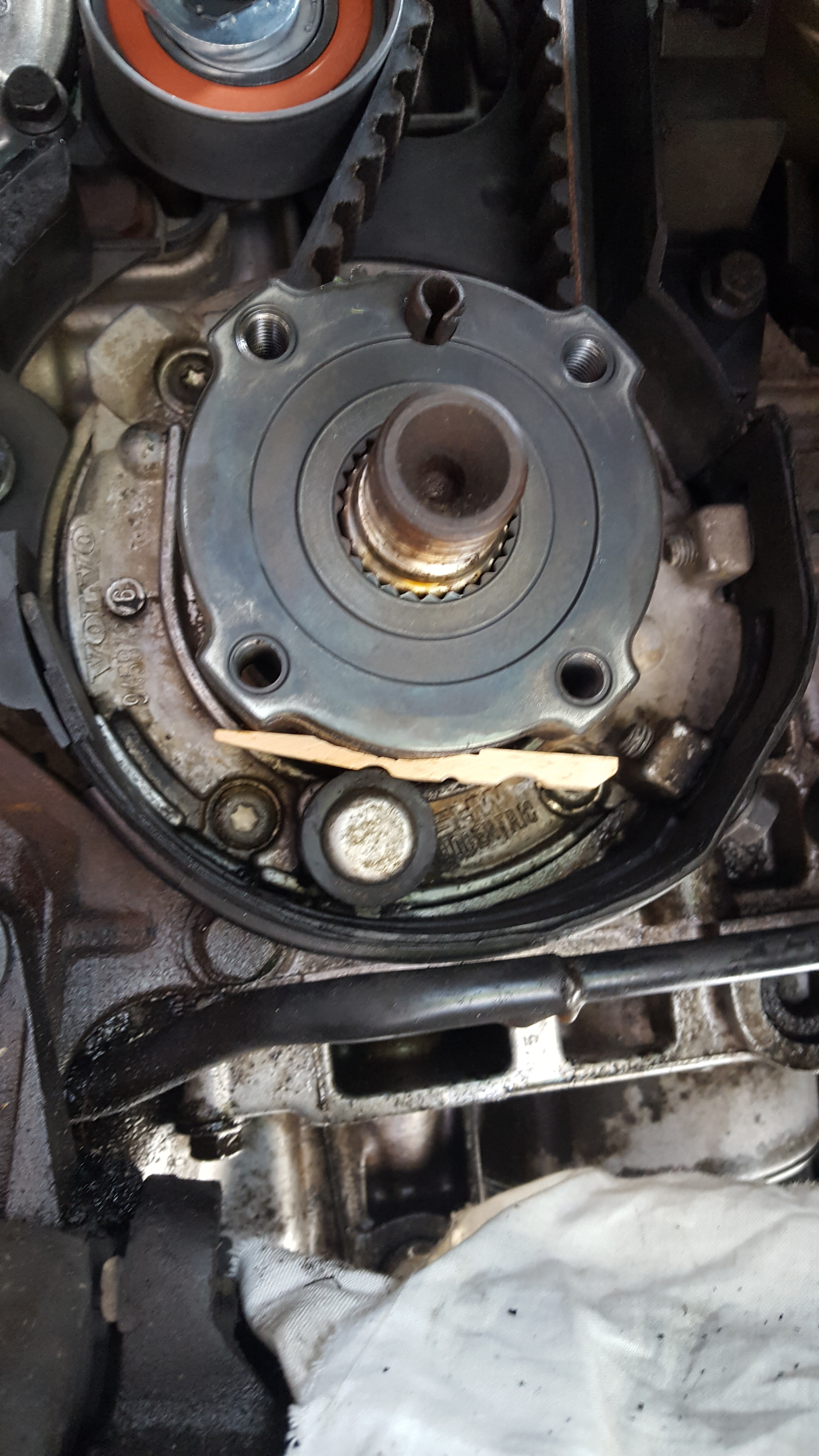

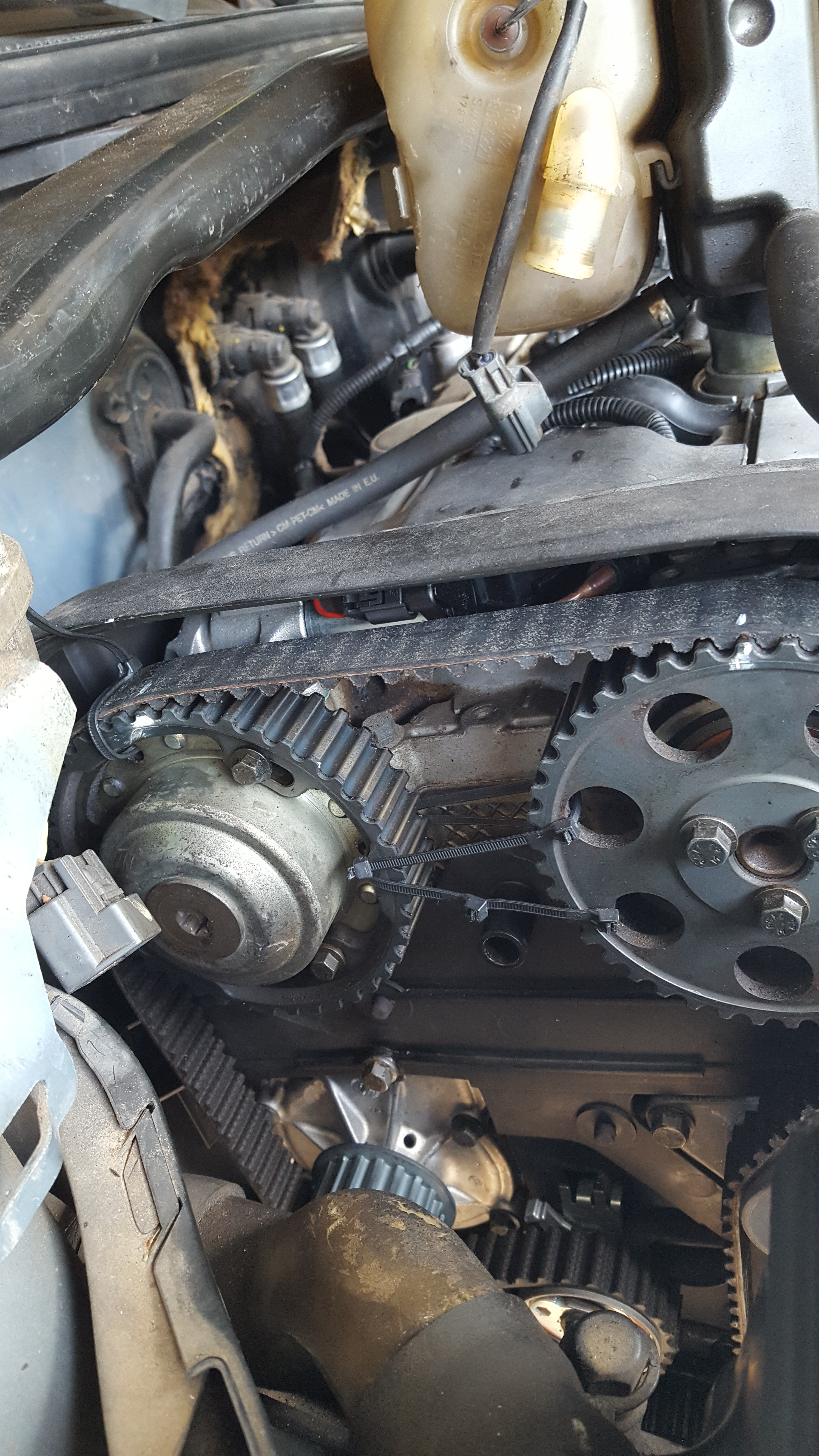

While waiting for other parts for 2001 V70 T5, I replaced timing belt, tensioner and idler pulley. I removed the vibration dampener pulley but wish I had not. Now I need a tool to hold it while I torque the bolts.
I used a combination of several posts as guidance for the timing belt. The advice to use tie wraps was very helpful. I also used tie wraps to hold the cam pulleys for limited rotation. To hold the belt in the grooves at the crank pulley, I jammed a wood clothes pin between the rubber stopper under the pulley and the belt. Tensioner was not set in these photos.

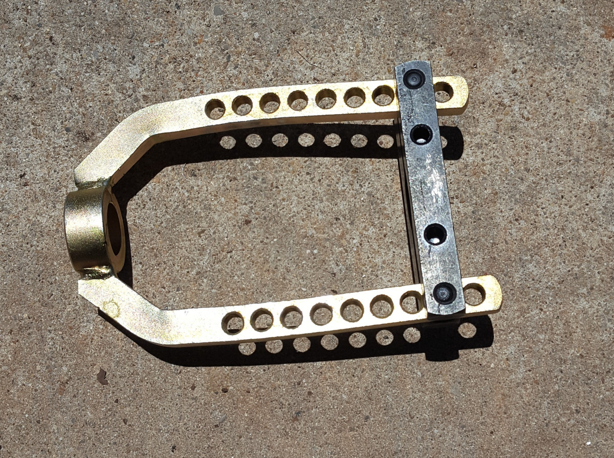

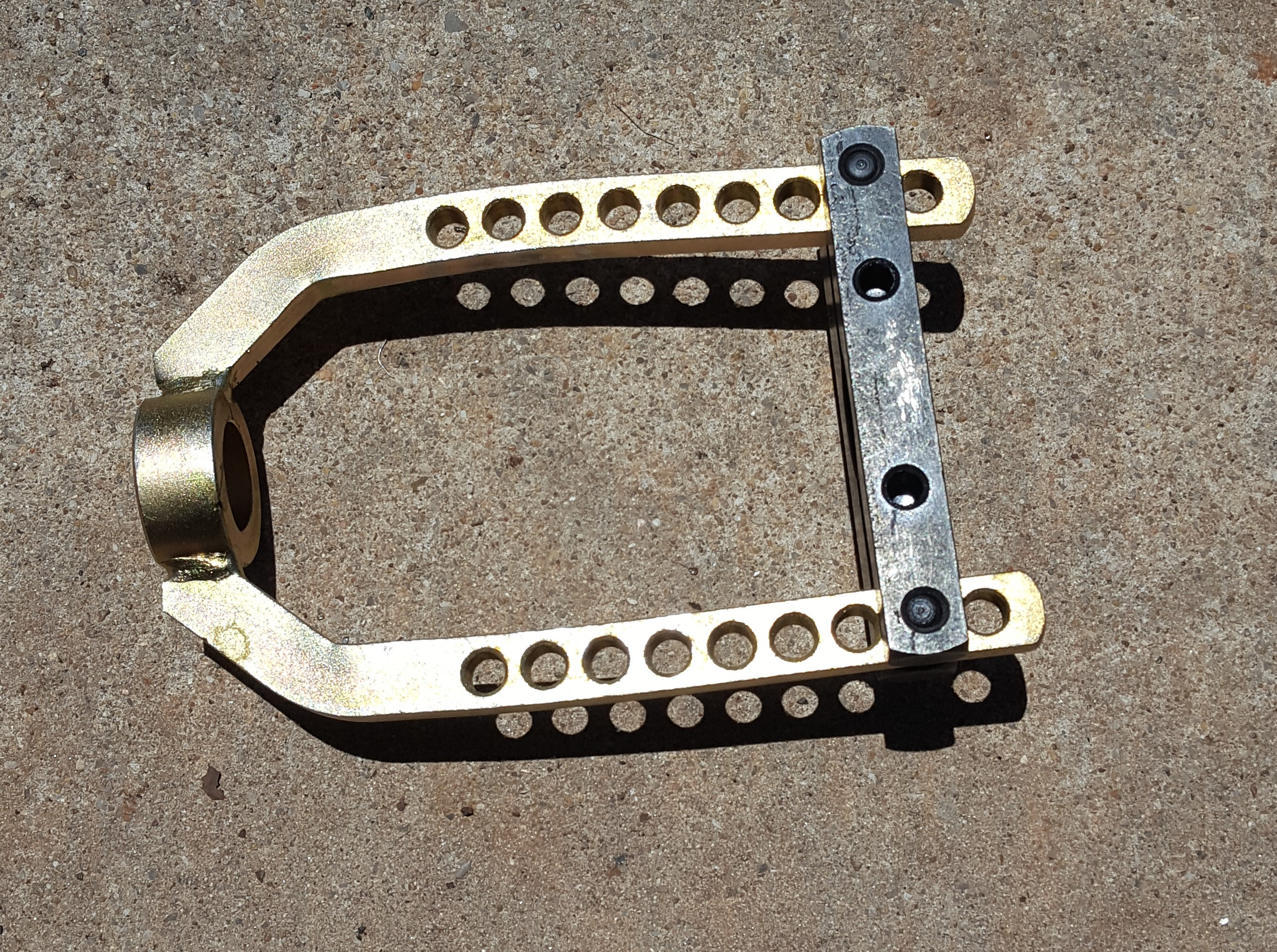

I was going to change axle boots on 2001 V70 T5. One boot was torn and others were cracking. The axle seemed ok. When I removed the axle I tried to disassemble the outer CV joint using the horseshoe shaped puller. I pulled the axle end bolt up tight and beat on the inner ball race using brass punch and 3 pound hammer. No go. I got a longer ratchet bar and tighened some more. I had to retighten the clamp on the shaft to keep it from slipping. Then I noticed the puller was getting distorted. I decided I needed to buy new axles - this one was not coming apart. This was a cheap replacement axle from 30K miles ago. Finding the boots to fit was going to be hard anyway.
