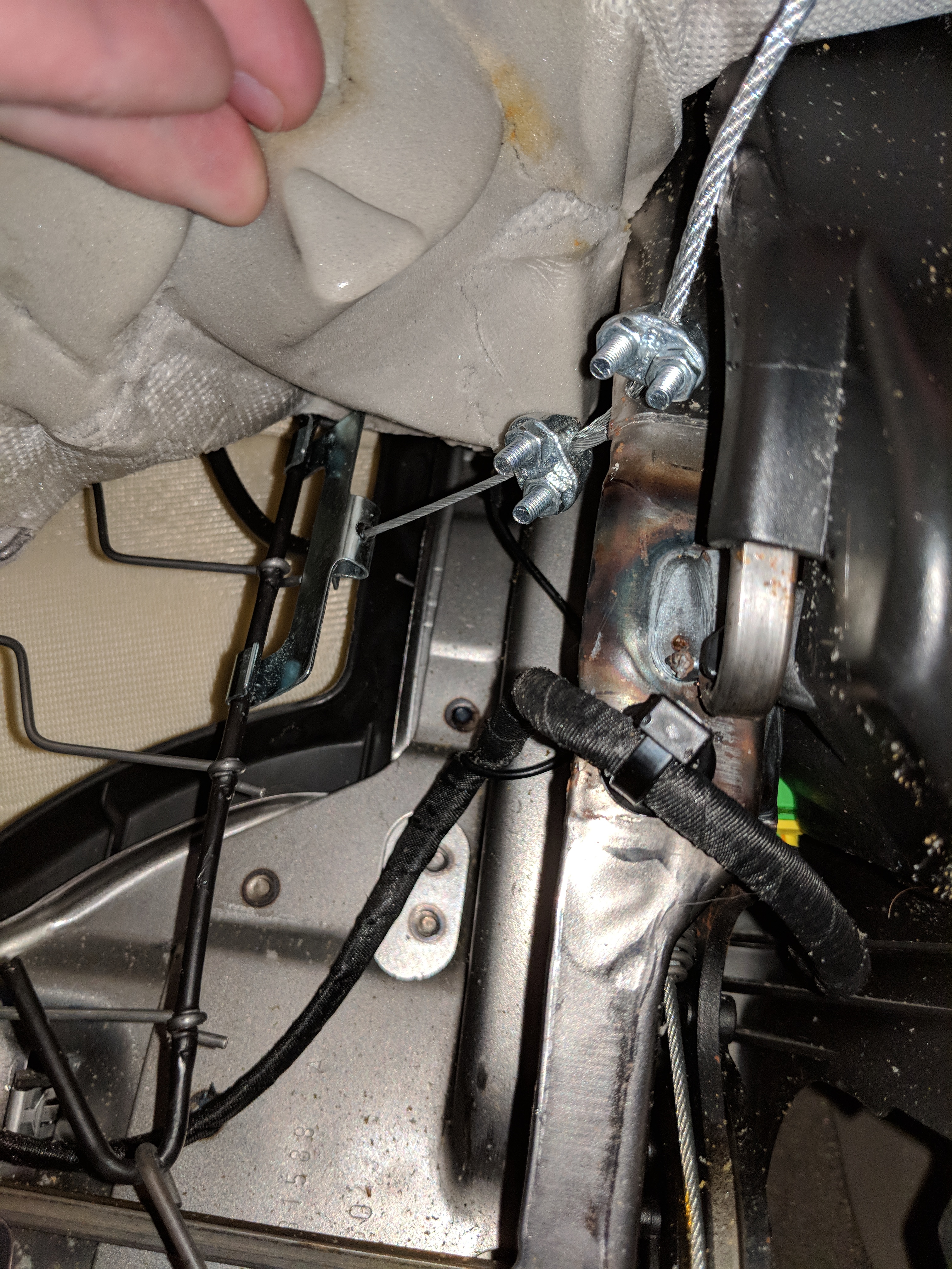

I see what you did there. If anyone like me is afflicted by this and wants to try repair, make sure you're not dumb like me - when @hu5ker555 said shimmy up the leather, he meant leather AND foam bits. Don't start clipping hog clips like me, thinking "oh I guess someone must have gotten in here before and added clips".hu5ker555 wrote: 07 Jun 2017, 10:31 On mine, one of the hooks that are circled in red had snapped. I did not need to completely remove the seat cover, and did not need to remove the entire assembly shown in the pics. If you don't mind scratching up your hands a bit, this can all be done in-situ.
Just undo the plastic bar catch at the base of the upright seat back, (leaning it forward helps) and shimmy up the WHOLE thing, foam and all. Might need to disconnect a 2-wire clip, I disconnected my battery for that part just in case. Unwind your lumbar knob all the way, you'll see the wires extend in the seat so you'll have more length to yank on. Reclining the seat back helps to see the broken clip, I've attached a picture of my broken clip. The broken dongle at the end of the wire in the middle of the frame SHOULD be attached to the hole a little above it.
I've picked up some clamps and ferrules, will update with results of wrenchery.

UPDATE: SUCCESSFUL TOMFOOLERY
1. Snipped off the offending clips
2. Loosened the lumbar assembly with the plastic knob all the way
3. Grabbed some intense little clamps + more steel cable
4. Threaded some new steel cable through the original anchor holes, then
5. Clamped it to the OG cable and
6. Clamped the new cable into the hole + snipped the excess.
Pictures are of right side of seat when viewed from the front.
