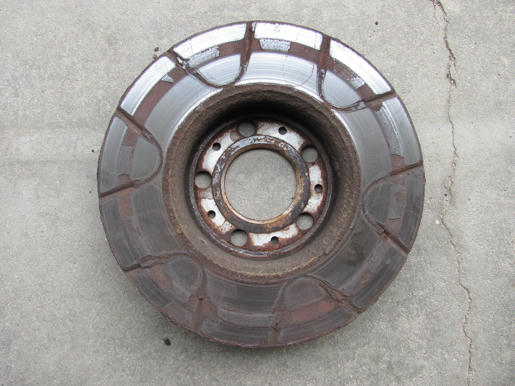

Hi guys,
I am busy replacing multiple parts on my latest purchase, an XC70 2005.
I found these front rotors, I was unable to understand who manufactured them but I need your opinion on what to do, basically either throw them away or replace them?
They are still within min. thickness, 26.00mm but I am concerned to see so much rust.
By the way, I will put on new ceramic pads:
https://www.fcpeuro.com/products/volvo- ... no-8634921
As always, your opinion is much appreciated.
Thank you!
Alex

Never seen that pattern before. Based on the rust, easier to replace them then cut them.
Your choice of pads is good.
Good luck.

Those are slotted rotors, not uncommon.
Rust is normal.

matthew1 wrote: 12 Jul 2017, 16:20 Those are slotted rotors, not uncommon.
Rust is normal.
Hi,

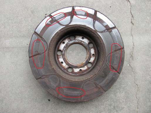

rust is normal, but I have never seen the coating peeling off like this, that's why I am concerned to put them back on.
Alex

On close up these discs are pretty knackered.
Sorry can't identify for you. It appears that where the slots were machined material has loosened and scored the disc. Nothing wrong with standard discs for your vehicle. Textar discs are the non Genuine choice of repairers over here; not certain if they're available over there. You certainly have Zimmerman and Brembo which are well known. Others may want to chime in on what has worked well....

That line of rust is not normal wear, it shouldn't be there. I'd replace the rotors but I'd first inspect the calipers work properly.

The rust chunks in the machined slot fall off and get stuck between the pad and rotor. This is common with slotted rotors. I would stay away from slotted rotors unless you remove wheels and wire brush the slots every few miles.

agree with precopster - there's no compelling technical reason to use slotted or cross-drilled rotors, and those rotors are knackered and need replacement.
If you want slotted for aesthetics that's one thing, but they will not make your car "stop faster".
I've had success with Bosch rotors, and those are cheap and readily available in N.A.
