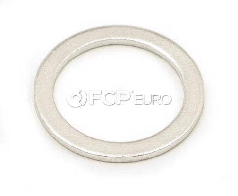

I know we're supposed to use this:
https://www.fcpeuro.com/products/volvo- ... v50-v70-xc
But a few years back, my brother went to get his oil changed and it took over ten seconds of a 1/2" impact wrench to remove the bolt. (Yes, I know. Never use an impact... But, when you pick up a used car, you never know what condition the oil drain bolt is in...) I take care of all the family's oil changes, but no matter how much I torque this thing (25ft/lbs+), it still leaks. I really don't want to go too high and break anything. I think the aluminum gasket doesn't "crush" enough to cover the drain hole which is probably warped.
Is there a copper or rubber and copper gasket we can try there? Has anyone ever had a similar problem?
I was searching through the database and I read that one person was able to fix a smilar leak by installing a Volvo drain bolt which was a little longer... I think we'll give that a try, too.

Oddly enough, the aluminum gasket on our cars gives me a satisfying bite when it yields to its deformation. I've never had a leak in either the trans or oil pan.
If the longer bolt doesn't work you can buy a tube of Permatex Ultra Black (advanced formula) gasket maker. The tube I use also says, "ultimate oil resistance". I use it on a Honda which was overtorqued (stripped) by a quick change oil place. It works like a charm. I lay a bead of the stuff at the base of the bolt's head and run it in.

Torque won't solve leakage if it is deformed.
Drain the oil and check the surface for flatness. You might be able to file it flat if its close.
Definitely try a more crushable Copper gasket , gold and Indium will work too, but you have to be a Doctor to afford those - wait - you are a Doctor...
I did try the Volvo plug with Oring on my 1999 and it leaked - I think I still have it if you want to give it a try.
