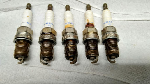

I thought it was time to replace the spark plugs which were 100K old, so last Saturday, I replaced the original Volvo sparks with the NGK 7092.
The old sparks were really worn, besides #3 #4 and #5 were soaked with oil... #2 and #5 were just worn.
I think the reason why #3 #4 and #5 were soaked with oil is because 6 months ago I realized the PCV hose was broken, I replaced it but there was plenty of oil next to the ignition coils location. I cleaned everything but I guess the oil might have gone down the threads of the sparks.

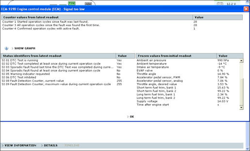

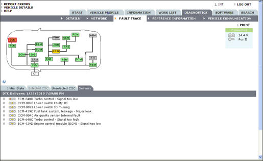

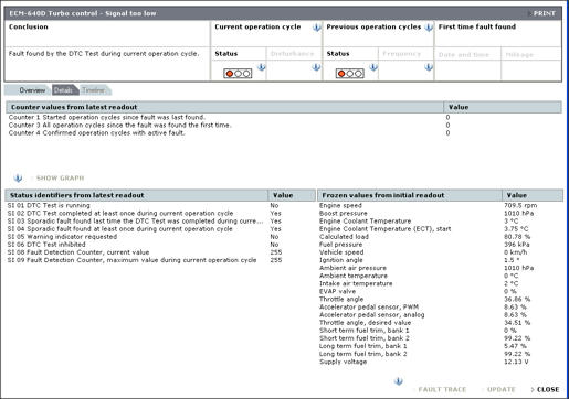

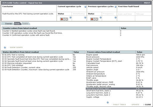

I was convinced something was wrong with the ignition coils, but the VIDA errors say something different.
I was able to start the car again one more time while I was plugged in with VIDA, the engine stayed idle for about 10 minutes, then it stopped.
I understand the meaning of the codes, but I do not know where to start from.

The reason of the errors was the low compression, due to my negligence, the intercooler pipe was completely disconnected on the back of the engine.
Most likely the reason is because when I tightened the clamp, I did not fully push down the hose in the connector, so it popped out.
Once I realized the issue, I was (and still I am) pissed off with myself, I am always very careful on everything I work on, in addition, I removed/re-hooked that hose multiple times in the past, never an problem... I cannot explain this stupid error.
I removed the spark plugs, made them 0.030", no oil on any on them.
Did a VIDA check, clean.
