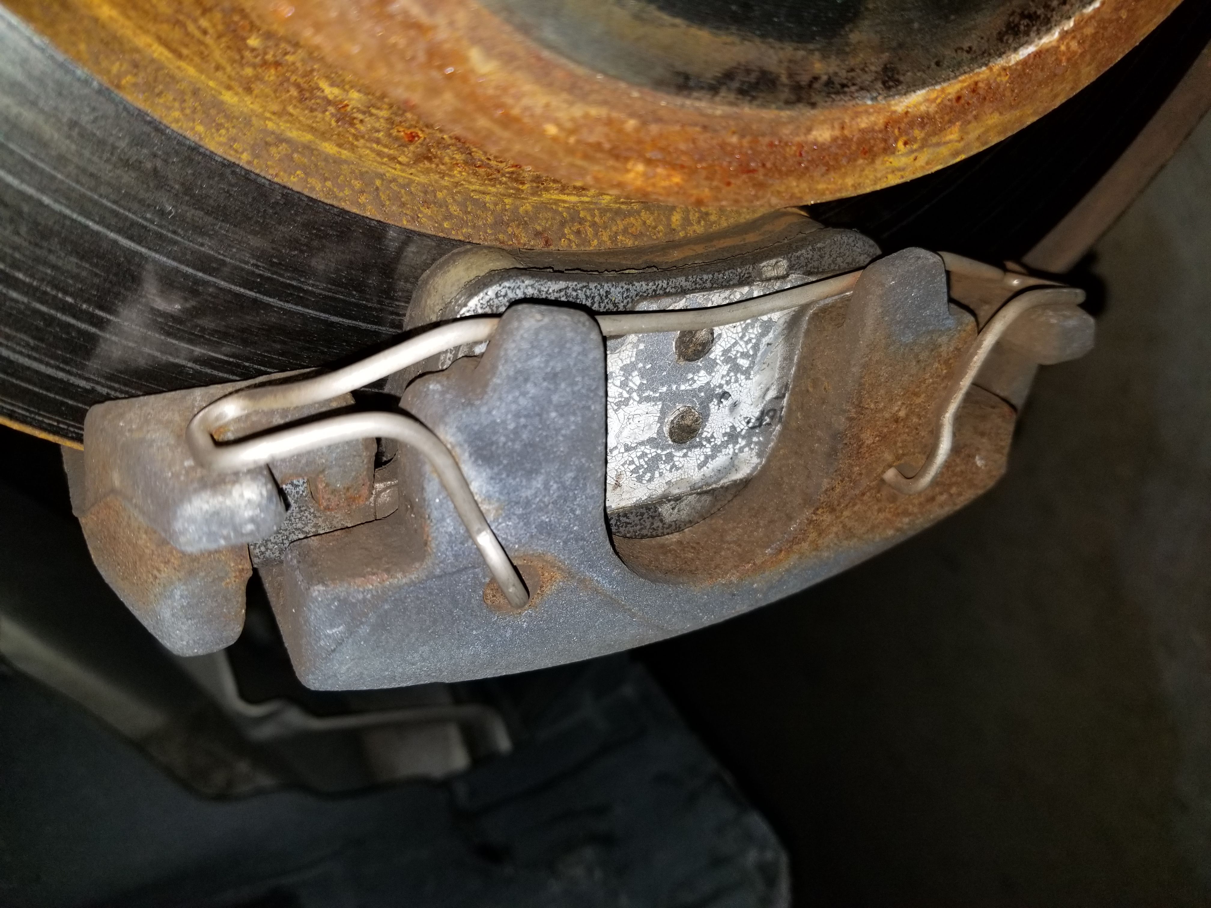

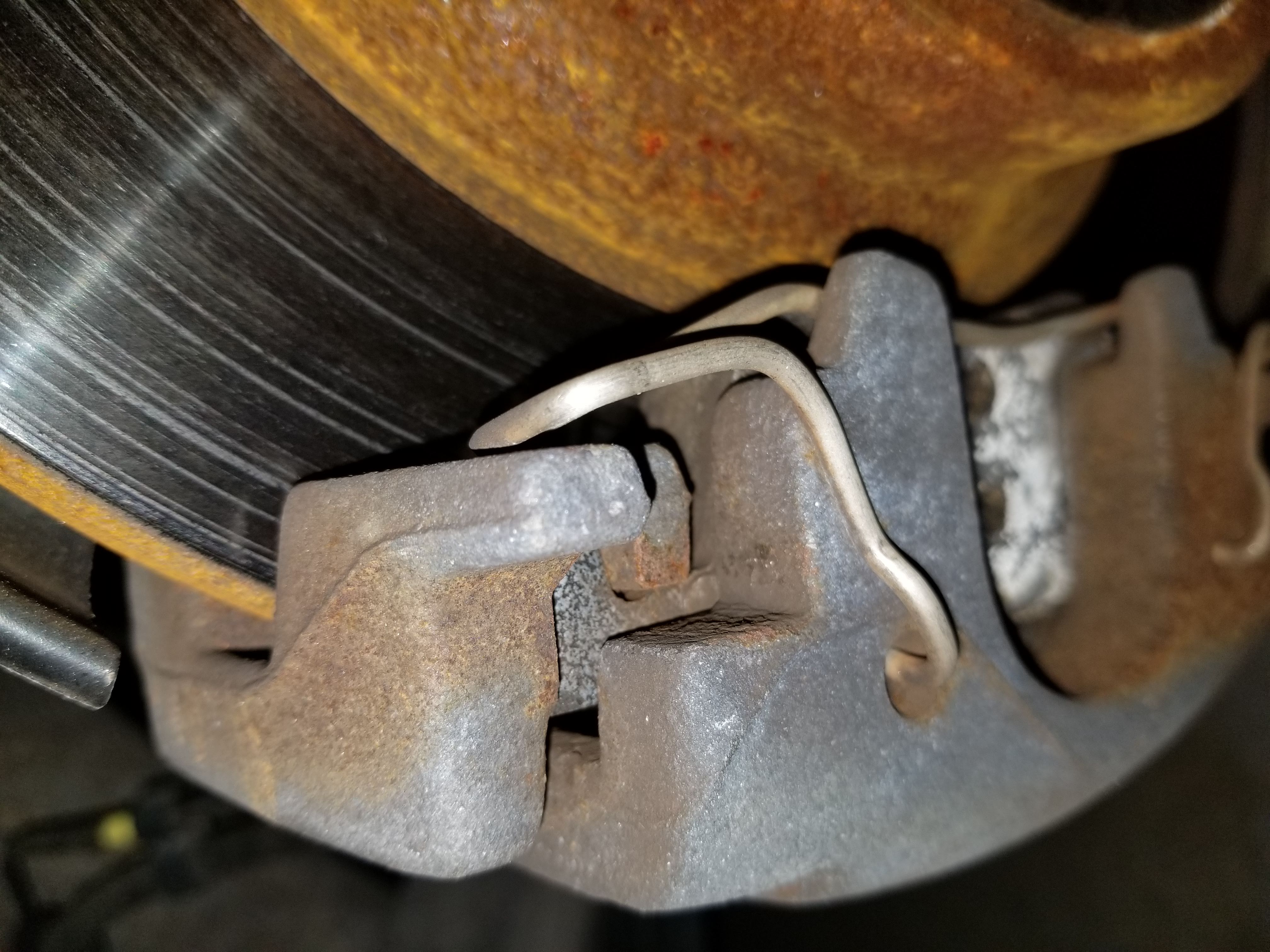

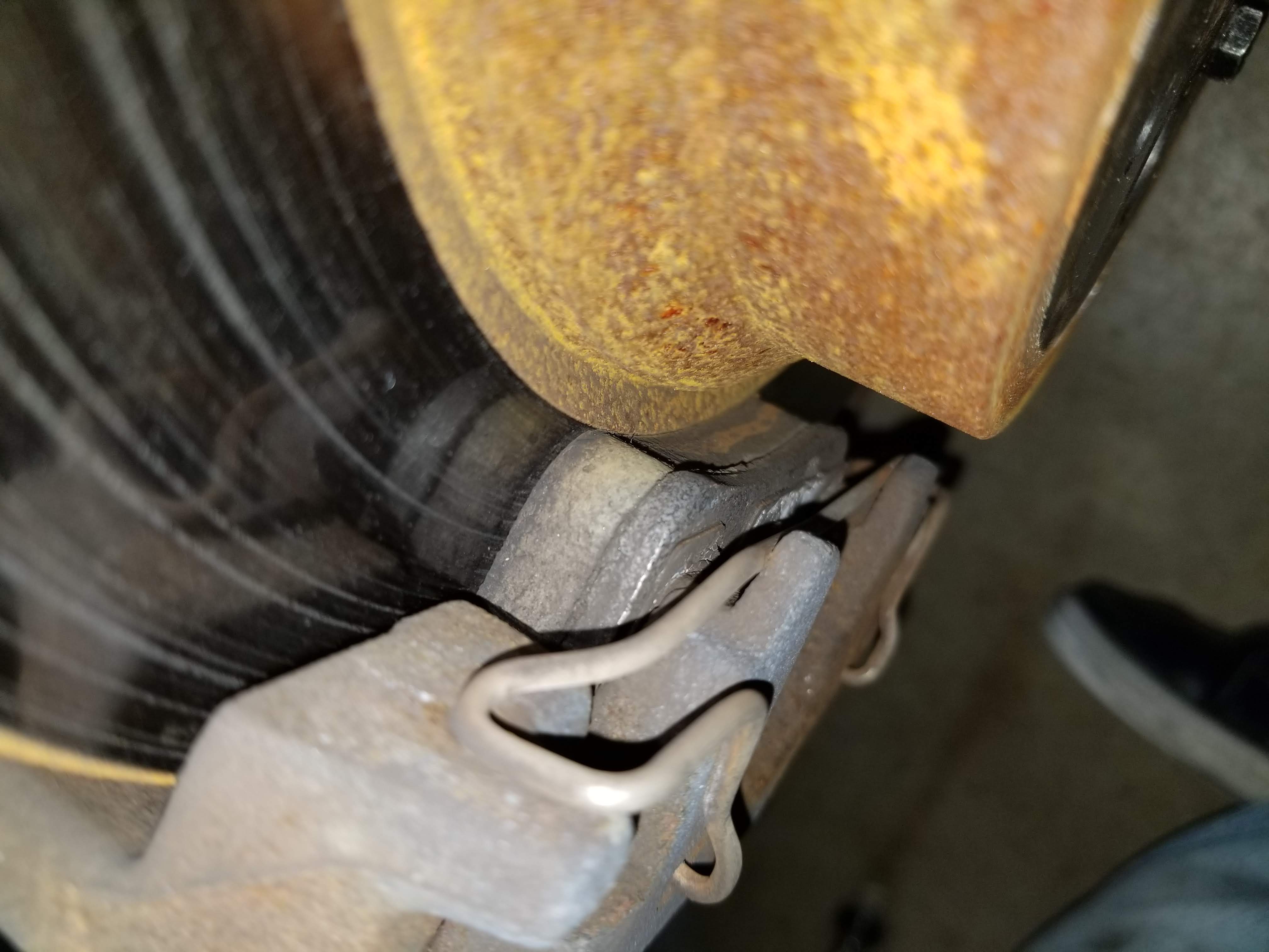

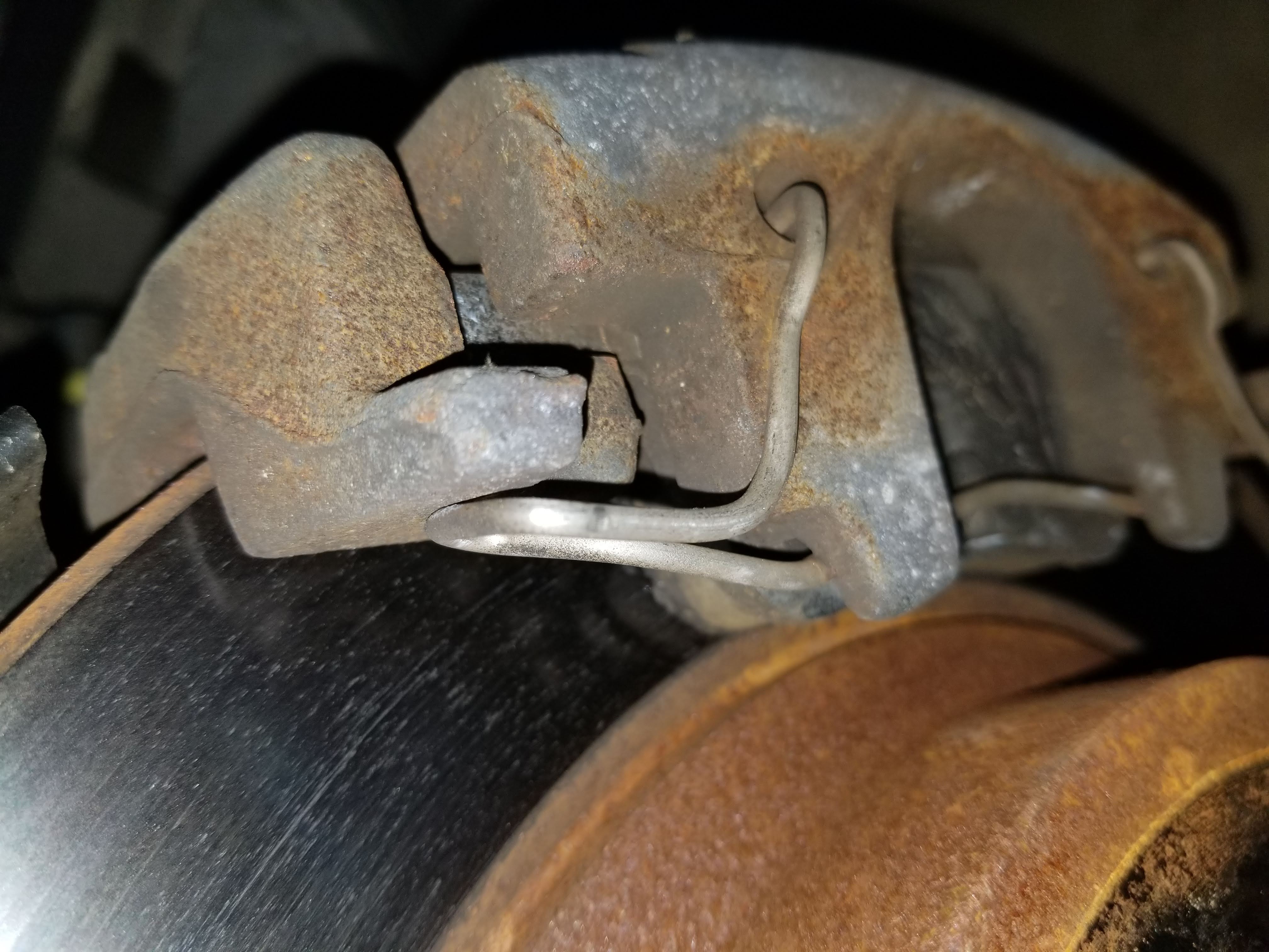

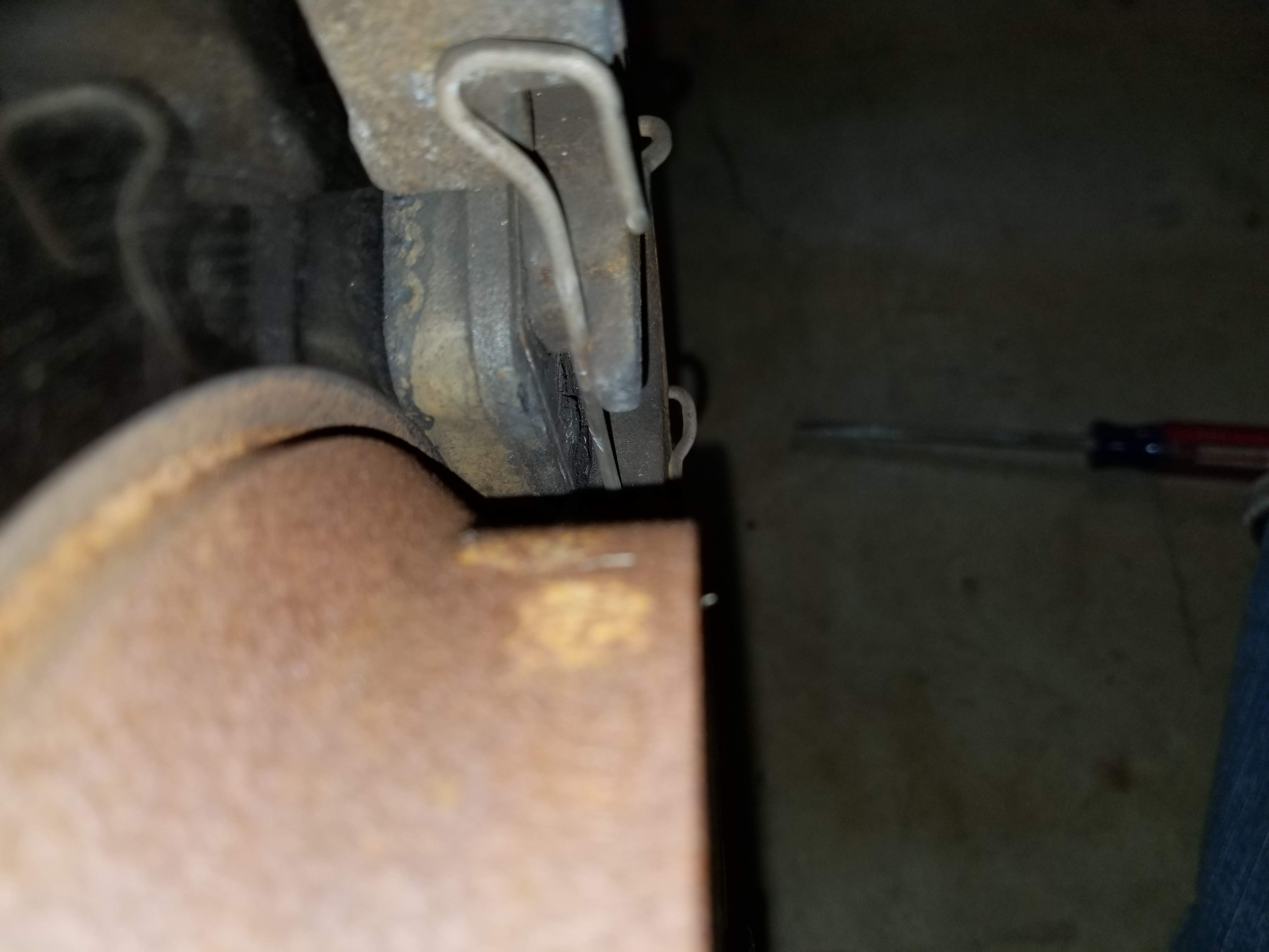

At the recommendation of a post I read here, I checked my brake caliper spring installation. They all seem fine to me but figured I'd let some experienced MVS guys weigh in. The rears seem to be sitting a little strangely/at a slight tilt (most obvious in the very last picture) and they lack the rubber bumpers that the fronts have, but I remember that's how they were earlier, not sure if they're supposed to have those rubber bumpers like the fronts do or not, or if that would even matter. Pics below.
So my thoughts are maybe replacing the master cylinder will help, or my caliper springs aren't actually good to go? Any and all thoughts/suggestions are welcome, including those that just tell me I'm crazy and the brakes are fine. Thanks all.
Front passenger side spring:
Rear passenger side spring:
Rear driver's side spring:
Front driver's side spring: No pic but looked exactly the same/mirror of passenger side.

Im not familiar with your year, but soft pedal on earlier Volvos was caused by 1 seized slide that causes the caliper to have to twist before full contact, and then it springs back leaving a large space to bridge before the next stop. You can rule out air since that cant have gotten in since when it was fine.

Pads and rotors look fine, definitely pull calipers and lube pins and the slides
