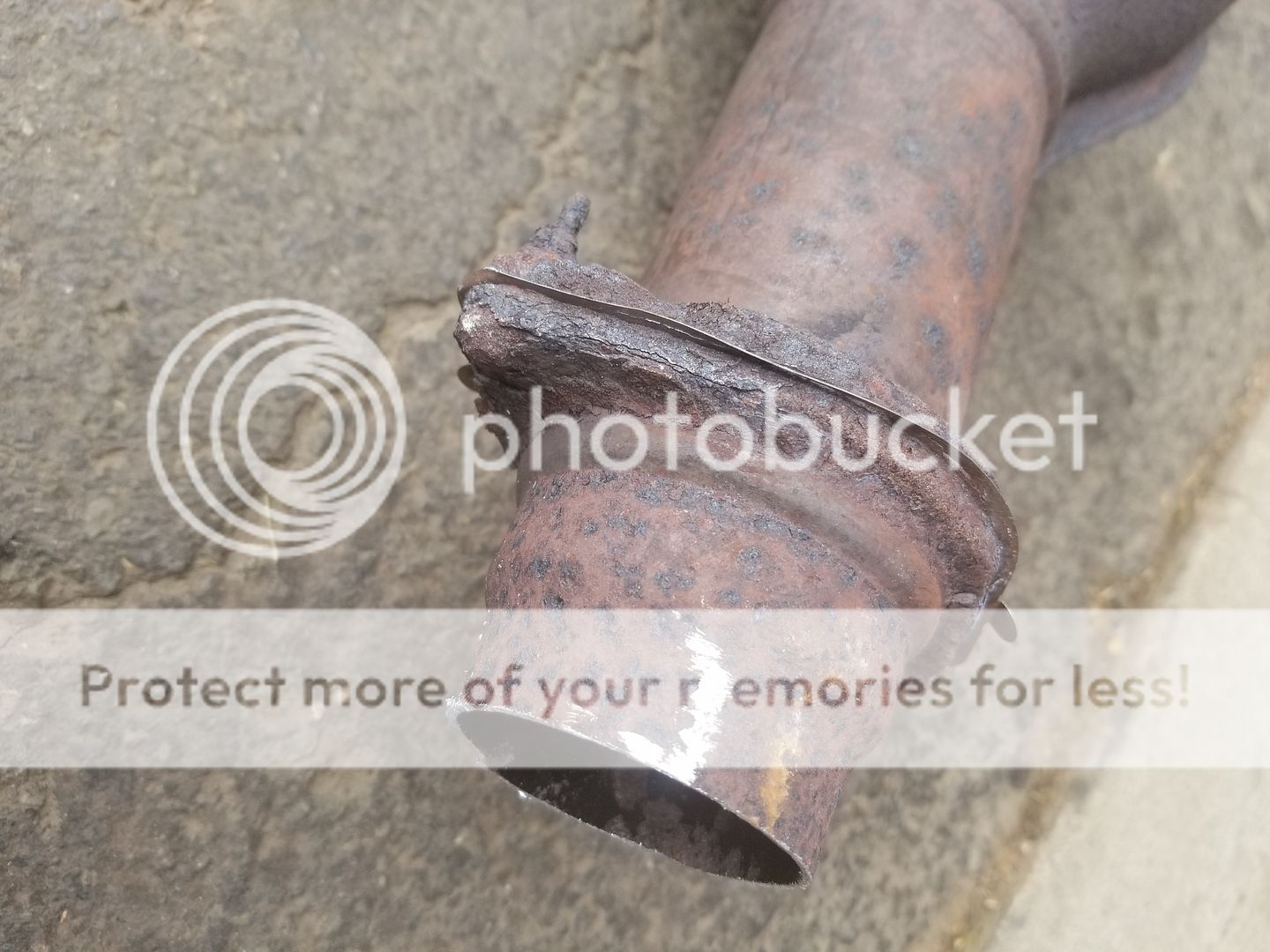

Here's the OEM catback I cut off.
No leakage before removal but it's day was coming. The rear hanging rods where rusted off and replaced with a bracket. Couldn't even save that replacement bracket.

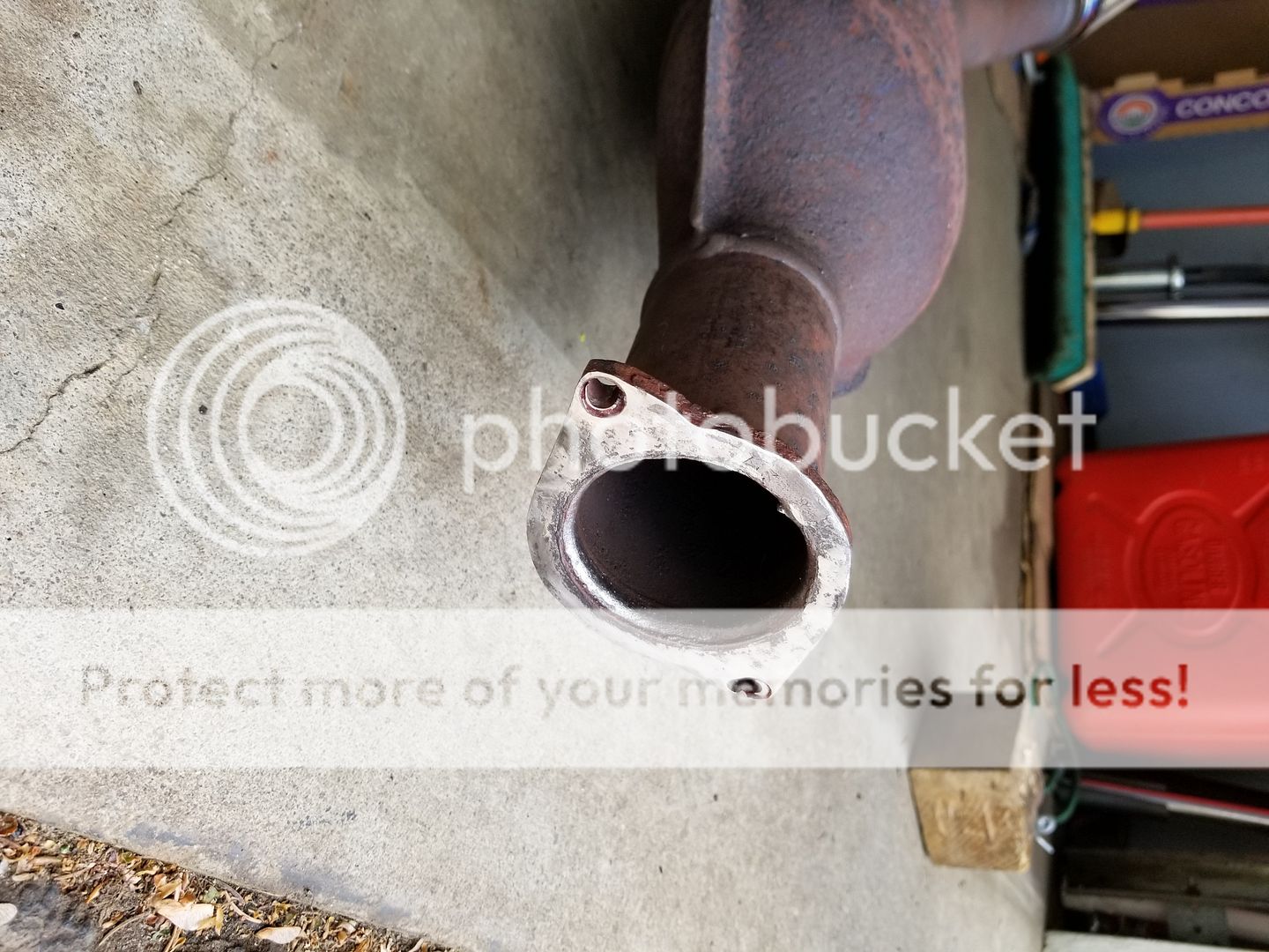

I'm saving the OEM CAT.
I tried restoring the rear flange but won't know if I'll need to cut it off and slide on 2.5" exhaust tube unless I try to install it again.

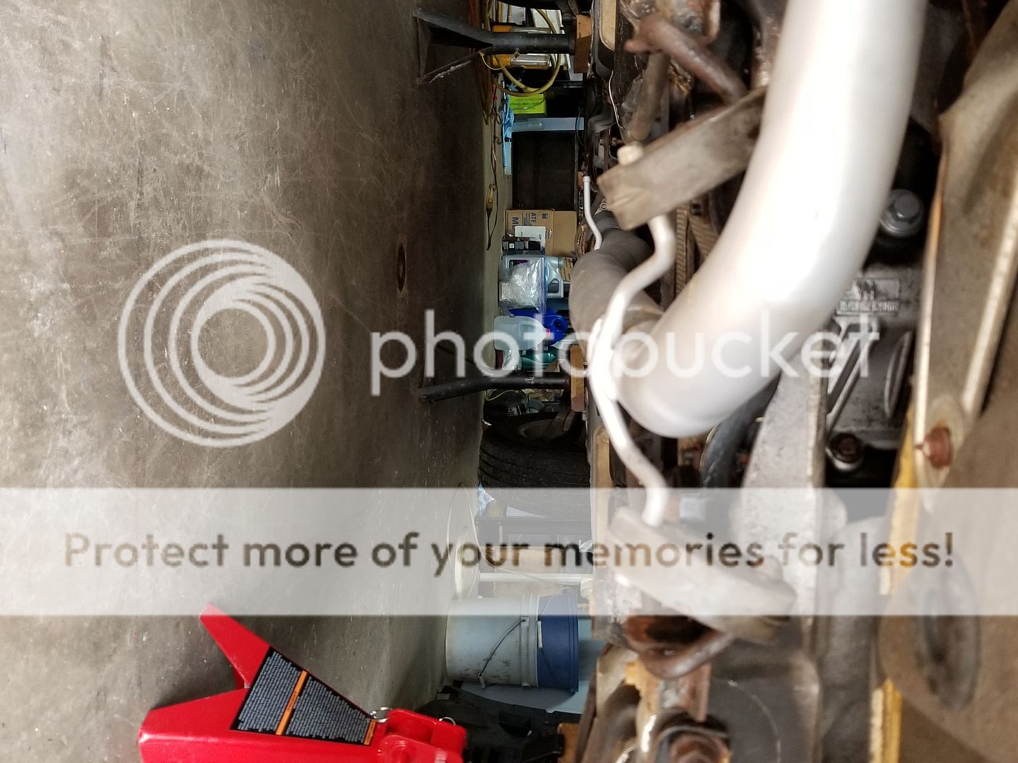

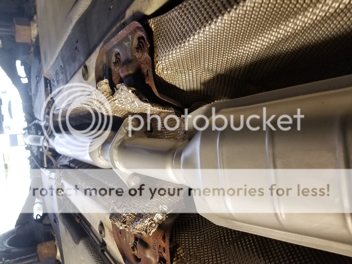

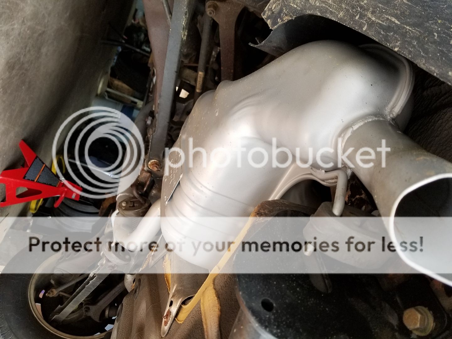

Re: Exhaust replacement on 2007 XC70  Topic is solved
Post by XC70Rider » Sun May 26, 2019 7:14 pm
The Eastern CAT and the Bosal catback all fit well.
Only drawback is the rod hangers on the center muffler aren't as long as OEM. No banging after 230 miles so it should hold.

XC70Rider
Post by XC70Rider » Sun May 26, 2019 7:18 pm
When I drove in rain I heard a loud squeal underneath. The next morning I loosened the 2 flange bolts and lowered the exhaust 1" to solve that issue. The resonator was too close to the driveshaft. :D

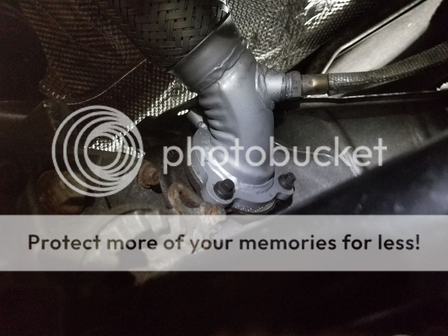

Post by XC70Rider » Tue May 28, 2019 5:13 pm
The downpipe is in good shape so I'm saving the OEM CAT. The flex section is accordion style with a braided wrap. The braided wrap is loose so I'll cut it off and replace with exhaust wrap to save the front driveshaft CV joint I just replaced.
If the Eastern direct fit CAT ever fails I'll remount the OEM CAT.
