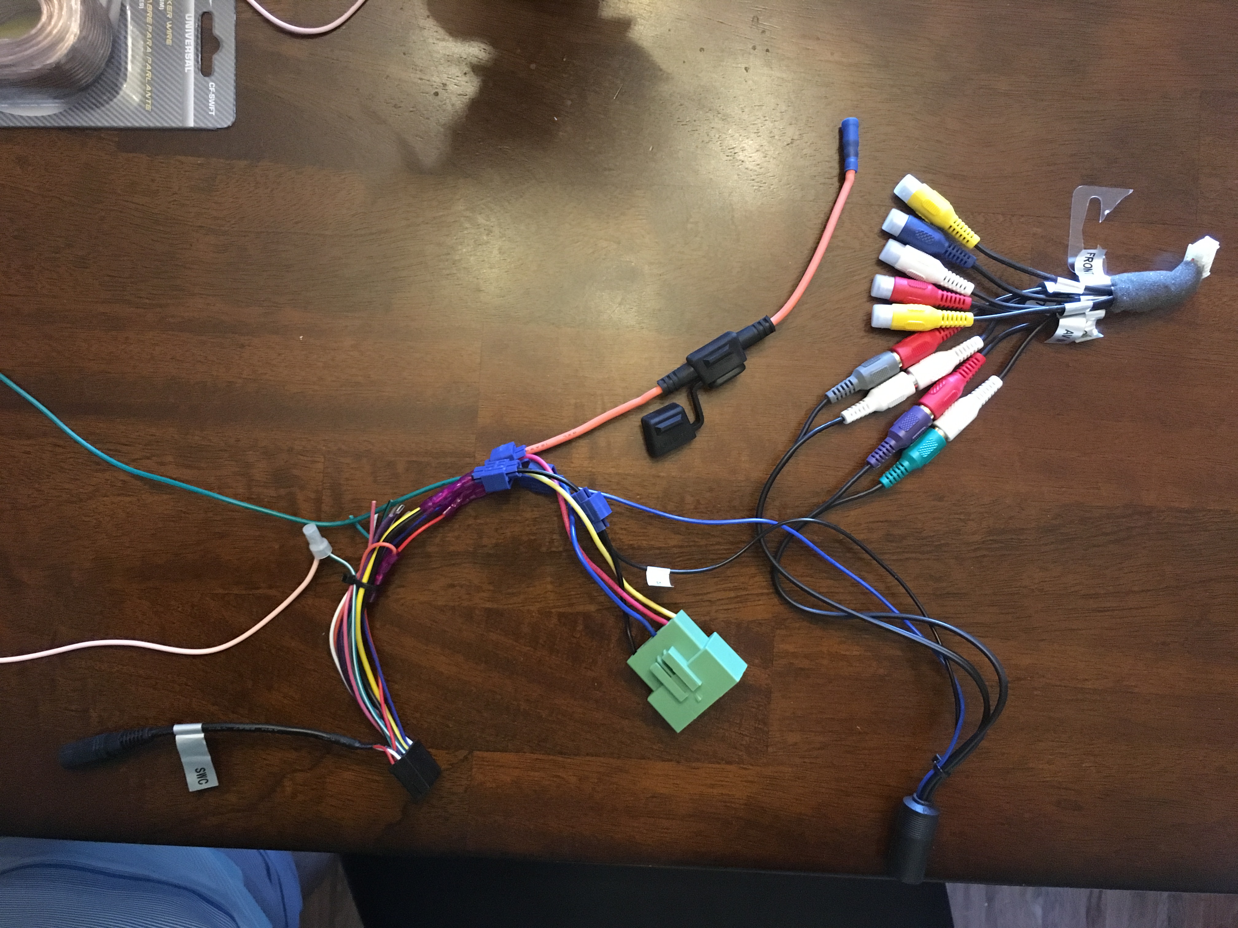

I’ve got this figured out. Here’s the harness I put together. There’s a lot going on. This picture is before the friction tape. Please let me know if you have any questions.
I’m gonna explain the taps coming off the harness:
1. Fused wire is from the switched power or remote on. This goes to the backup camera to provide 12v and protect my wire.
2. Green is a ground. It’s just for future now, but I may use it for the gps or dvd if I need it for the parking (-) signal on the radio. EDIT- Im going to use this for the ground circuit for the backup camera.
3. Offwhite non-fused is the trigger from the reverse lights for the backup camera. I’ll put a fuse near the reverse light to protect the wire coming back. EDIT- This will connect to the red wire (trigger) to the radio backup (+) on the radio. This trigger wire runs through the same cable as the backup camera so this wire doesn’t need to be ran beside the yellow rca for the camera video cable. The trigger wire in the back just needs to be attached to the reverse light (+). WHAT COLOR WIRE IS THIS ON THE FACTORY TAIL LIGHT HARNESS?
