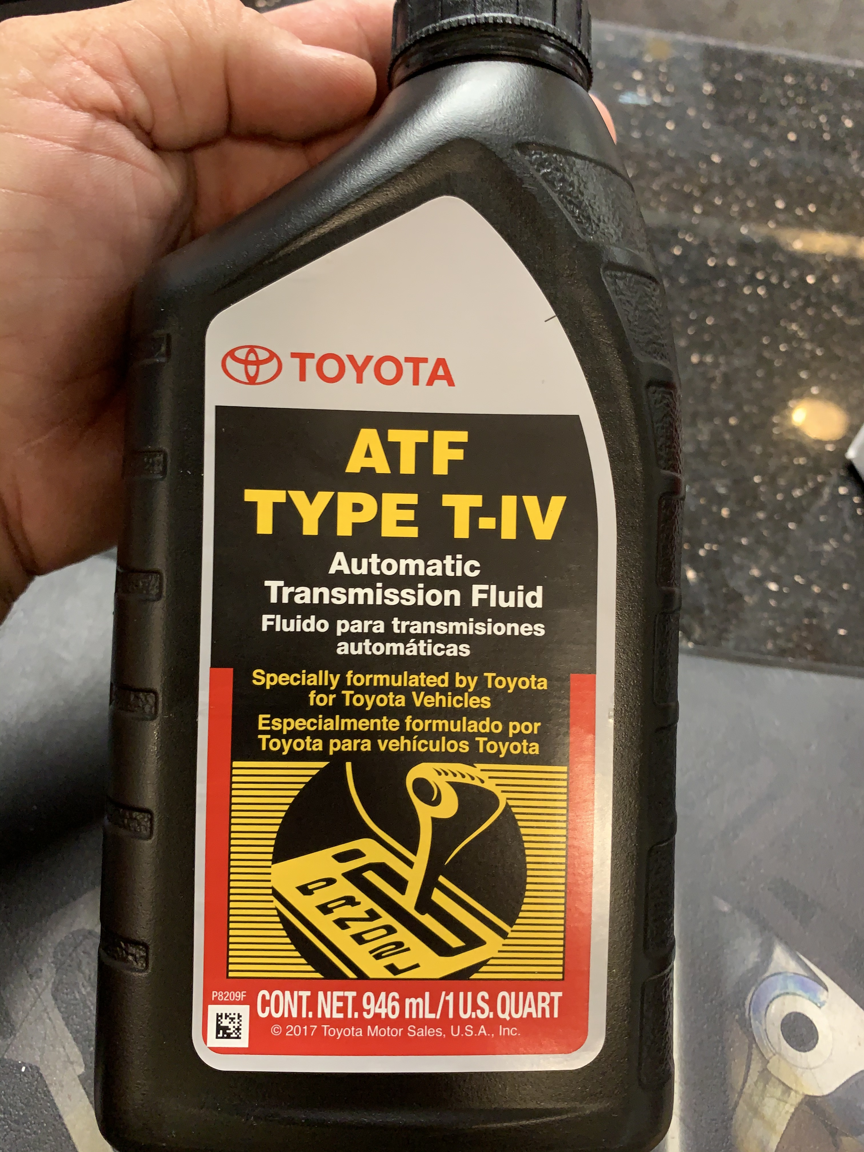

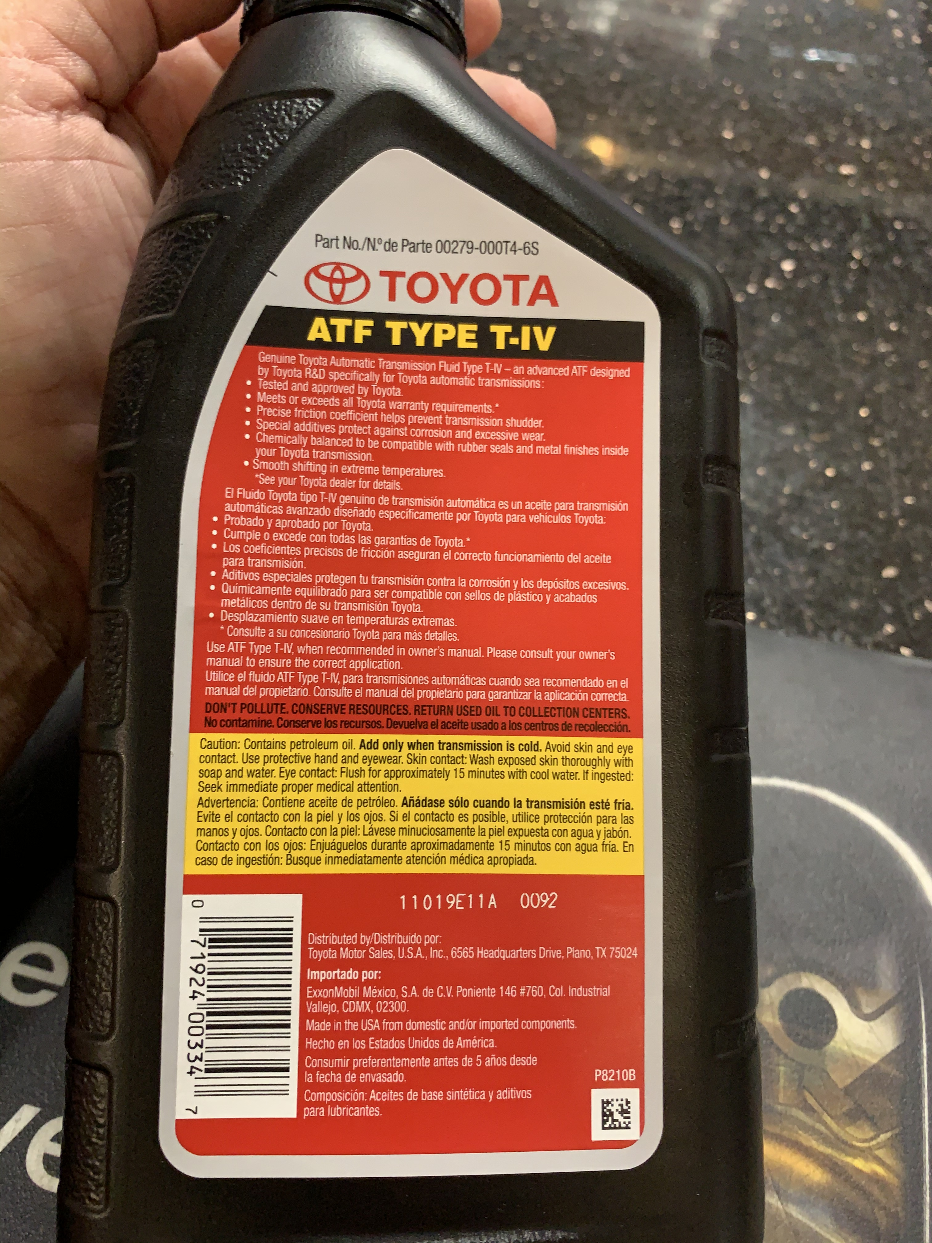

Post by adrian22 » Fri Oct 11, 2019 9:15 am
adrian22

I was just at the Toyota Dealership and there was absolutely nothing on the bottle of Toyota T-IV that showed what specification it was made to. Nothing on the box either identifies it as being JWS3309 Spec. I want to make sure this is the correct ATF FLUID.
Can you guys post a photo of the bottle front and back of the Toyota T-IV?
