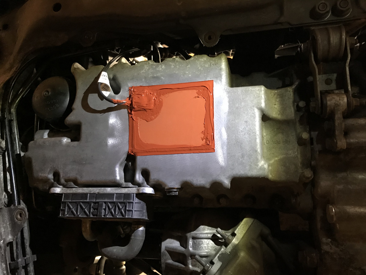

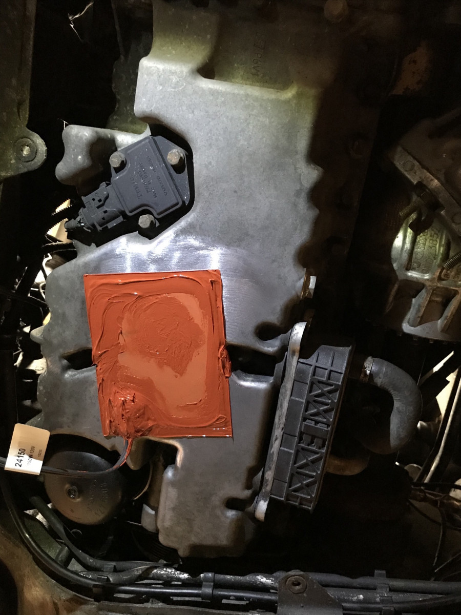

Hey VTL, what’s that your on to there?
I run the KAT’s silicone heaters on our oil pans. Seem to work great. I took temp readings of one of our oil pans last winter when it was particularly cold & it was around 63 degrees F.
I have one I need to put on the oil pan of the VR. Have to see about placement as the pan is different than that of a non-R
On the non-R just stick it smack dab in the middle of the pan as that is where the oil pickup tube pulls oil from. I use the red Permatex high temp RTV around the perimeter to prevent oil/ingress from getting between the pad & pan. These things get so hot you cannot touch them within 3 seconds of plugging them in.
https://www.fleetfarm.com/detail/kat-s- ... 0000047517
There was a period of about 2 weeks last winter when it fluctuated between 30-40 below zero, ambient, Fahrenheit, & the cars all started fine. Turned over a bit slow but started nonetheless.
Edit: added photos
