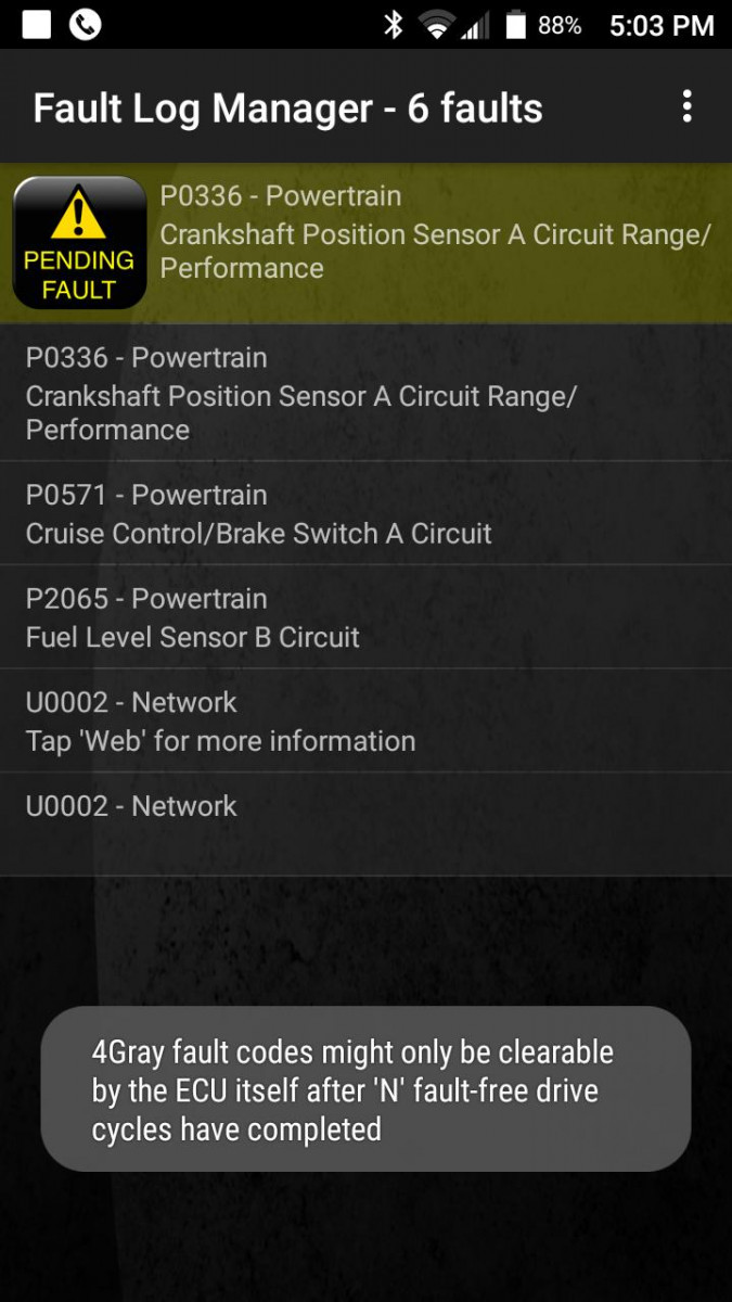

My inexpensive Bluetooth Scan Tool gives lots of codes when the car does not start. After I clear the codes and it is warm outside, the codes do not return and the engine runs like a champ…so I think all these codes are simply related to the intermittent electrical problem that I suspect.

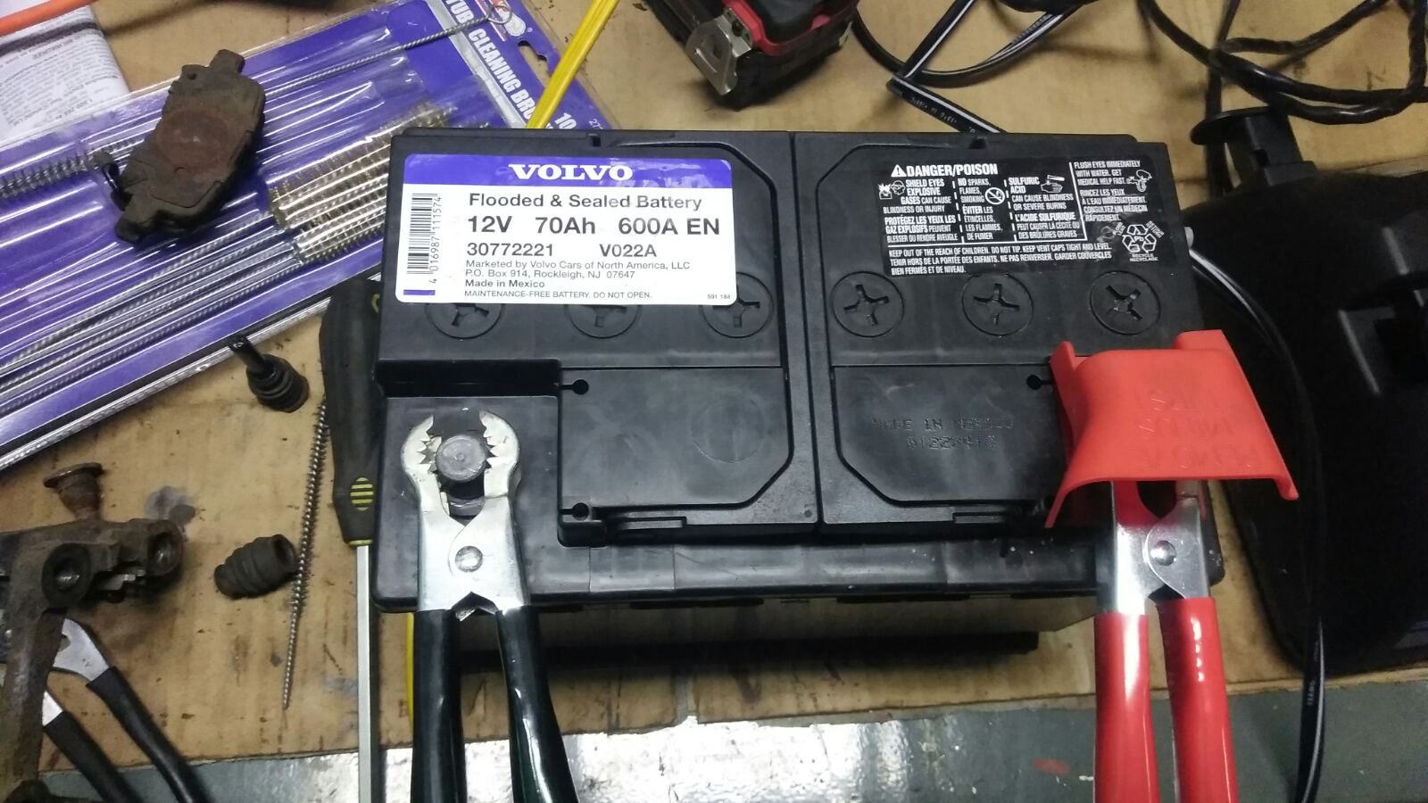

You definitely need a good battery with these cars , and12.1 Volts is dead.
Get the battery on a good 10 amp charger overnight , best for 24 hours, then let it sit for 30 minutes , then measure room temperature voltage to four significant figures. You want to see high 12.7x volts.
The electronics in a P2 Volvo don’t like low voltage and will give you trouble both starting and runn8ng if it isn’t right. Having cranking current is not a good test to for good battery performance for running,

GabrielS, Abscate makes a good suggestion to charge and test the battery now. If the battery does not pass the long charge and settle test, it can be expected to perform poorly when the temperature is colder. These cars do not like weak batteries. It messes with their minds (computers).
If the battery passes this test, then it may have a problem with battery cable damage or corrosion. But first, charge and test the battery. An older battery or one that has a history of deep discharge is suspect in no start conditions. Years ago, cars would start if they would crank over, but now the computers must have minimum voltage while cranking to be happy.

12.1v may not be properly measured. To measure the battery, park the car with the trunk slightly opened (not shut close), wait 30-40 min, then without opening any door or touching the remove, lift the trunk and measure the battery - every light in the car must be off to get a correct reading
You got 13.8v hooking the cars because the van battery was already fully charged so the alternator was on low voltage output

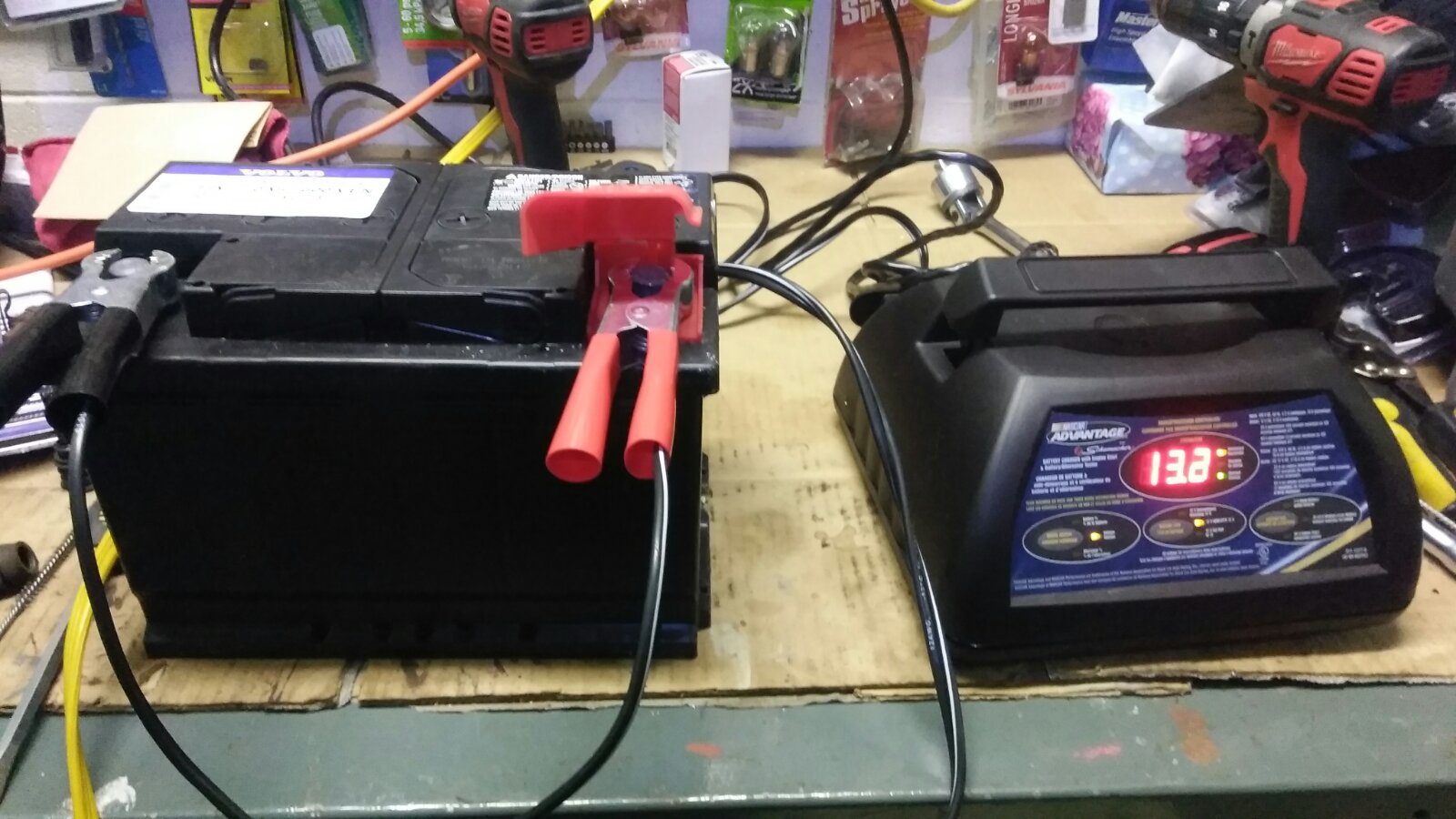

1) When I connected the Volvo battery to my wife's running van and checked the voltage across the Volvo battery terminals to be 13.8v (without touching the booster cables with the multi-meter leads)...does this not mean that the Volvo was now supplying this borrowed voltage to the computer and electronics...which should have enough to provide a proper start? That's what I assumed when I named the thread ("...Battery is good"). I assumed that my test with the jumper cables connected to a running car battery ruled out a bad Volvo battery. I now understand from your feedback that the battery is "dead" at 12.1v. I apologize however if I am saying something dumb because I am not well versed in matters of electricity or the flow of electricity. I am most certainly going to charge and retest the battery as suggested by abscate and oragex...but will wait to do it in -10 degrees Celsius or less.

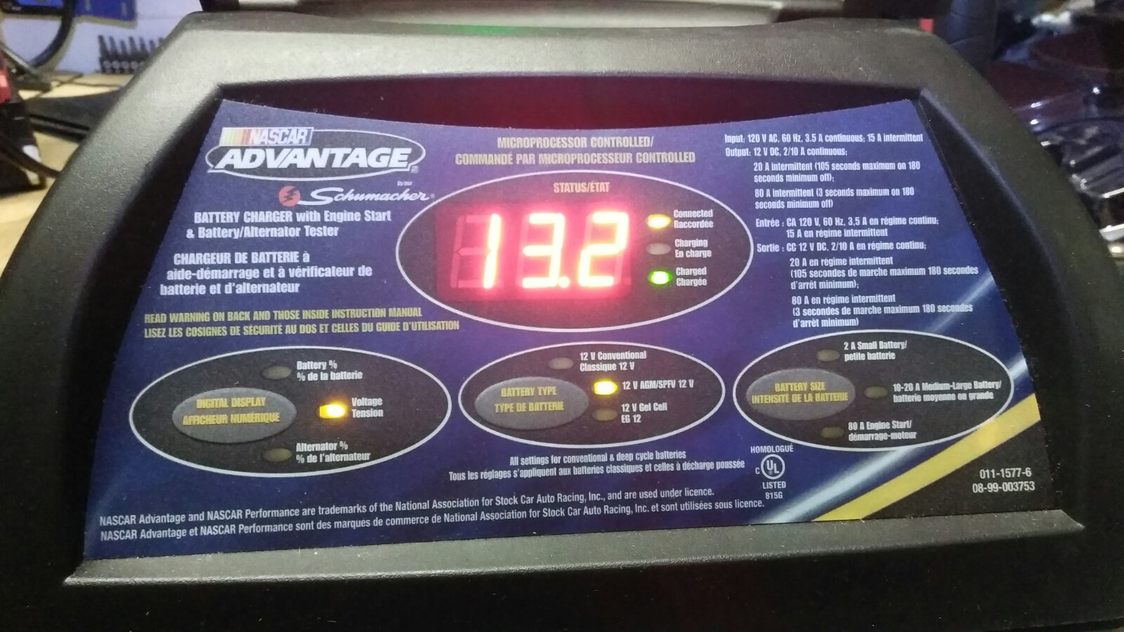

2) My Nascar Advantage Battery Charger is fully automatic microprocessor controlled (see attachments) (https://www.policeauctionscanada.com/Li ... er-134266A).
I took the battery off the Volvo today and charged it in my garage but the charging cycle was over in about 4 hours and then it switched to "charged" mode (see photos). It is also asking for a few options to set on the charger before recharging the battery. I chose 12 V AGM/SPFV 12 V for the battery type (which is what the manual says to do if uncertain) and I chose 10-20 A Medium-Large Battery for the battery size. However it does not seem to matter if I leave it overnight as the charger automatically stops charging when its smart circuitry decides it is done charging (one step closer to AI
3) When it is cold I will check again at the Schrader valve on the fuel rail. There is good fuel pressure on the valve when I pressed it today but we will see what happens when it is cold. If the pressure remains as good on a cold day it will tell me two things: a) the fuel pump works fine even in cold weather and... b) there is no water in the fuel lines that could create a small frozen plug when cold outside.
I will also check the tension on the timing belt when cold outside.
Thanks again...will keep you posted
I have to wait until it is cold to do all the checks you suggested given that the car only acts up when it is cold outside.
In the meantime I would like to pick your brains about your suggestions.

Inactually like my old analog charger more than my digital one. It’s the current you want to monitor during the process. Your old battery can also come to full voltage, thus telling the charger to turn off , at a charge state of only 10-15%.
In four hours your charger put in at most 4 hours x 10’amps or 40mamp hours, I would guess about 1/2 of that actually. Total cap of your battery is 80mamp hours, so it is holding something like 1/8 to 1/4 of a new one

I thought so too. That makes my digital charger a useless charger. I got to get me an analog charger.
In the meantime I guess my best bet is to wait for a cold day, recharge the battery to whatever capacity this useless charger can do, try it...and if the engine does not start...buy a new battery or a new analog charger and try again.
If the engine still doesn't start...then I can move my focus away from the battery...having ruled that out and having eliminated that as a potential issue.
