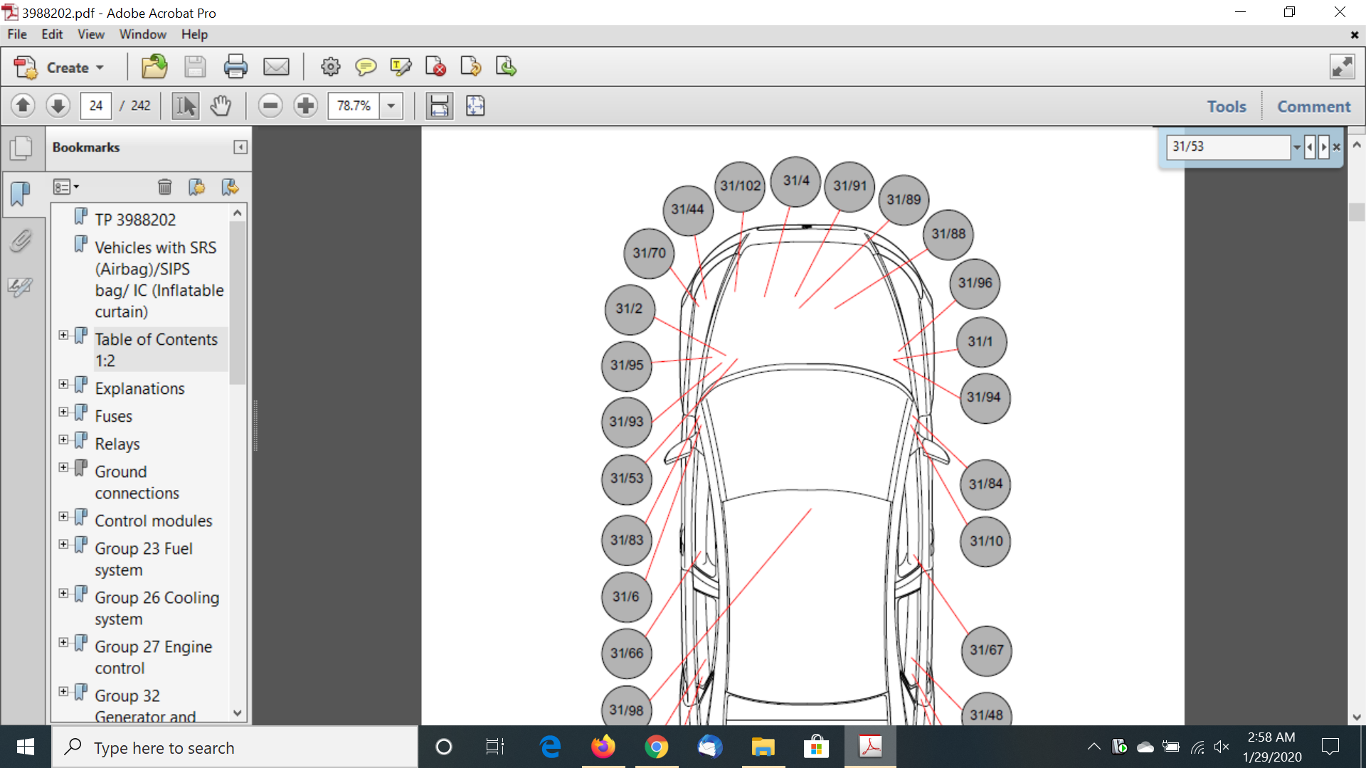

The ground cable (31/53) is on the firewall.

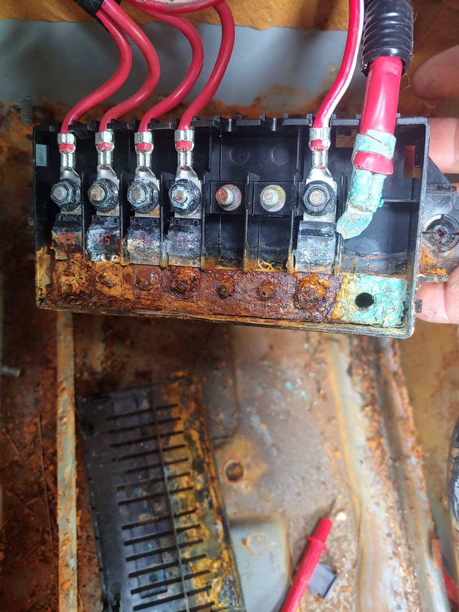

OK, so I *think* I found the issue...
Basically there is a box behind the battery with electrical connectors, and it isn't healthy.
Going to replace and see what happens.

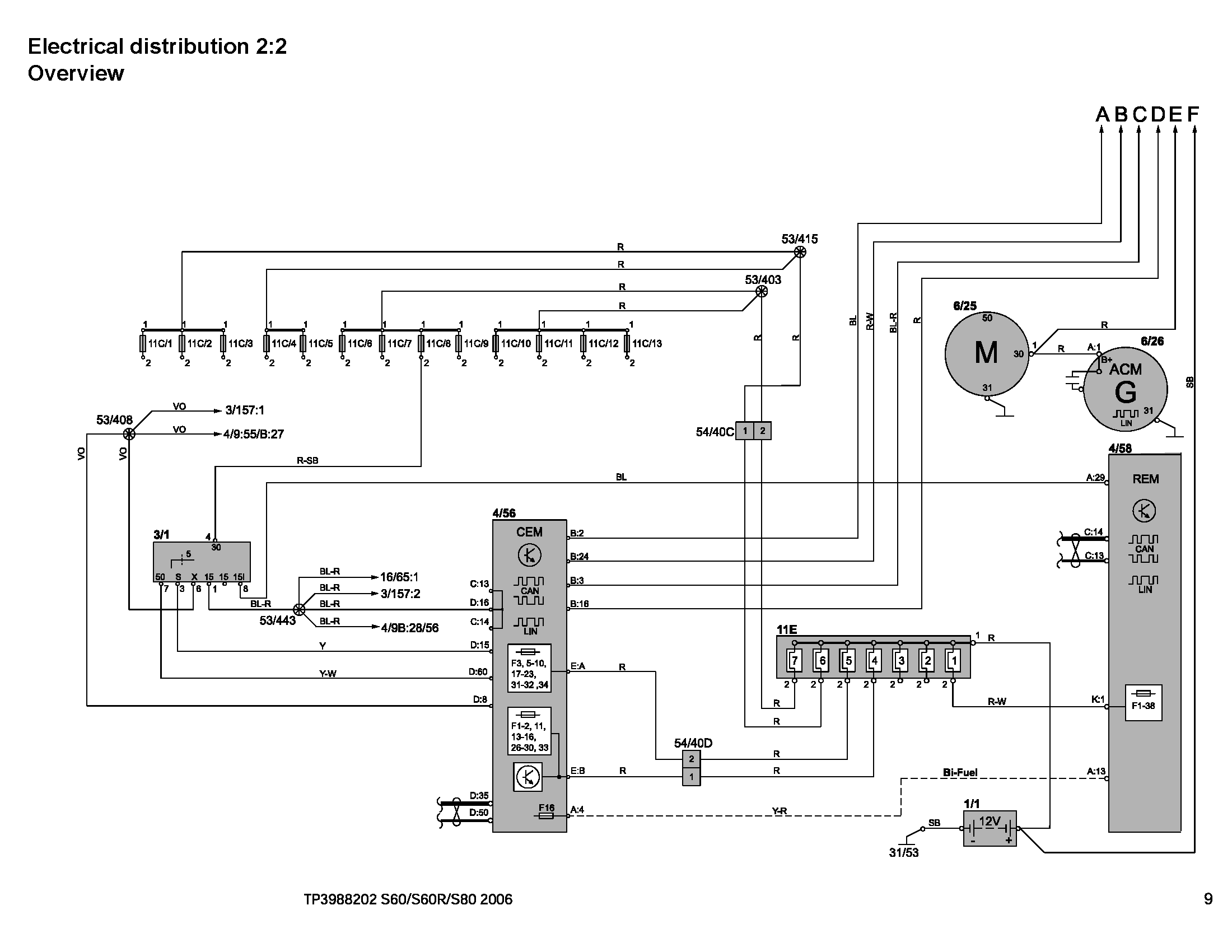

That would do it. It is fuse box 11E which feeds fuse box 11C, the CEM and the REM.

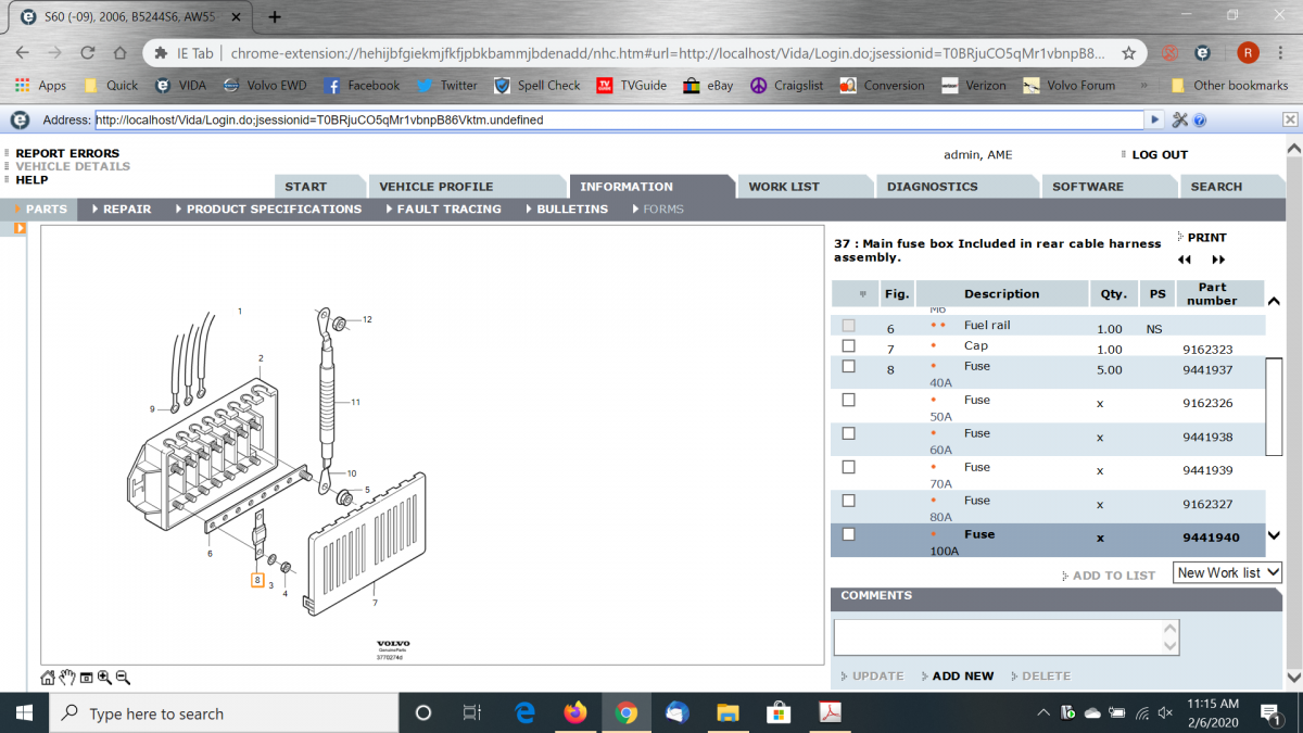

Fuse box is Volvo part number 9162321.
A new one ~$120.00 + accessories. Self service salvage yard ~15.00 for all.
You don't list where you are in Georgia but, there are at least 10 cars at LQK in Fayetteville, GA that have what you need for less then $20.00 total.
1 Wiring harness, luggage compartment 1.00
2 Main fuse box 1.00 X 9162321
3 Washer 10.00 X 986477
4 Flange lock nut 10.00 X 985865 ; M5
5 Flange lock nut 1.00 X 985866 ; M6
6 Fuel rail 1.00 NS
7 Cap 1.00 X 9162323
8 Fuse 5.00 X
9 Cable terminal 4.00 X 970793; 2.6-6 mm2
10 Cable terminal 2.00 X 976477; 0-16 mm2
11 Wiring harness 1.00 NS
12 Hexagon nut 1.00 X 987529
6 Fuel rail 1.00 NS
8 Fuse 5.00 X
- 40A Fuse 9441937
50A Fuse 9162326
60A Fuse 9441938
70A Fuse 9441939
80A Fuse 9162327
100A Fuse 9441940
125A Fuse 9441941

Welp, that was it!! After some Appalachian engineering, the car's running again.
