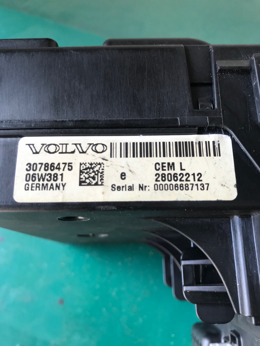

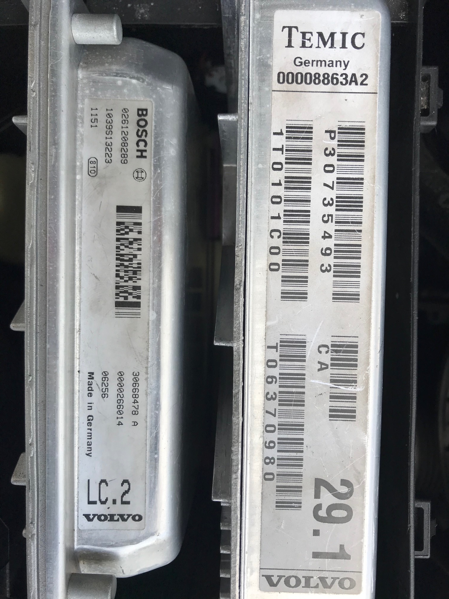

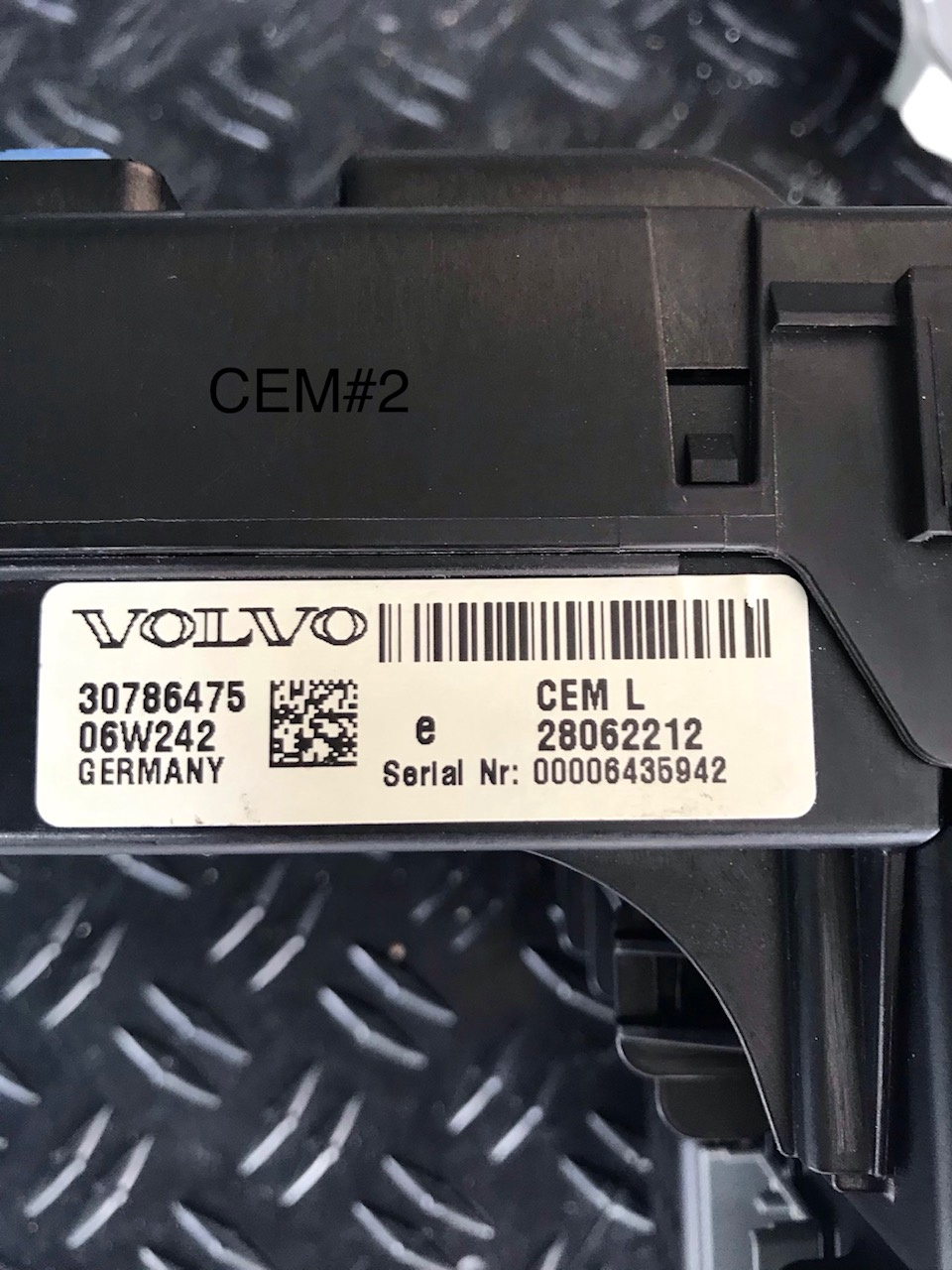

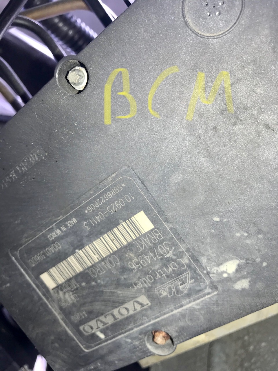

Can you take a photo of your parts and original VIN?
Also, take a photo labels from all modules you have please.
After get this info, we will offer good way for solve your "question".

I'll get the modules all out of the car and get this information. That was actually a question i had that i forgot to put in the original post - are the modules labelled from the factory to indicate the VIN they were installed in. I now assume yes.

Post by Ac427 » Thu Mar 12, 2020 5:44 pm
yagger wrote: ↑
Wed Mar 11, 2020 12:43 pm
Let start from accumulate info. Send photos please and we will see what we can do. )
Do not worry we know what we do. We can back to life any Volvo's very easy. It is our favorite business. )
Here you go

Post by yagger » Fri Mar 13, 2020 12:41 pm
Ok. I got your vin. You have a correct equipment for your car, and we can sync it. For this you have to ship to us CEMs, ECM (on your picture module LC.2) and all keys from your car. Not need to ship to us BCM!
Also one question: did somebody tried to program key to your CEMs?
