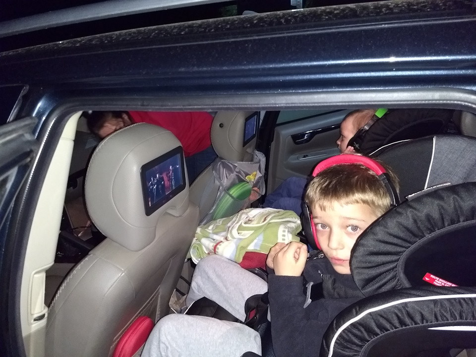

Under driver's seat: two Arduinos, one drives the display, works with CAN-bus, rear view camera, navigation. Another one controls Volvo monitors in headrest (don't remember if it was taken from 07 XC70 or some XC90...)
Later I got rid of navigation (Garmin does not work in Canada, Android smartphone was a junk, I remember most of local roads and don't need it on major highways), installed a central speaker + small amp for the better sound clarity. Speakers are Focal ISS/ICU 165, btw.
We've spent happy months traveling in the kid-proofed car. No whining, no fighting :)
Also don't like the Kenwood occupied by the kids movies, so I'm redoing it again... Now with a small Chinese HDMI/RCA player that supports tons of video formats on a 1TB disk, has a remote control and frees me the head unit on a long trips. I have this setup in Tundra, and everyone likes it better than in Volvo.
