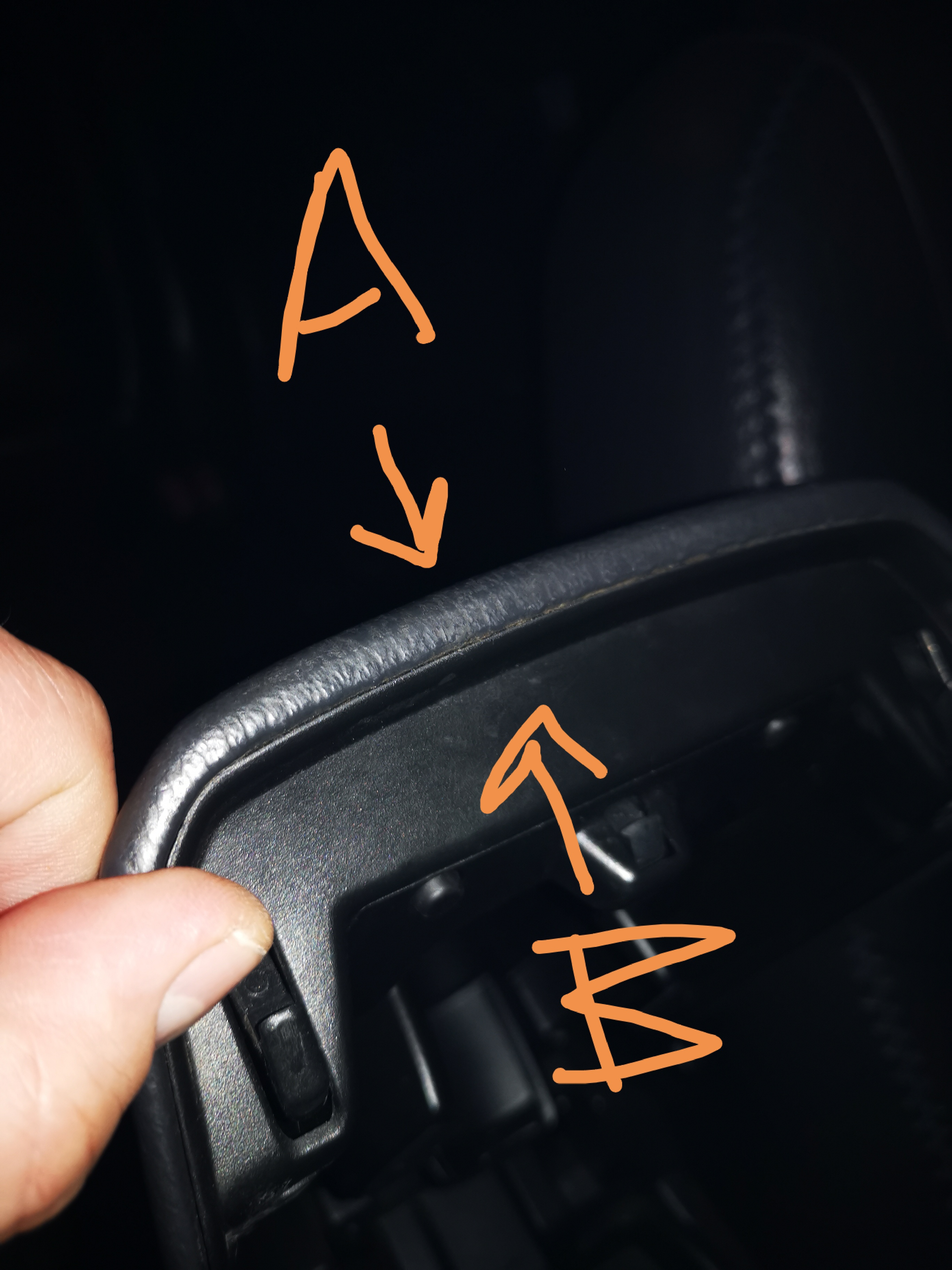

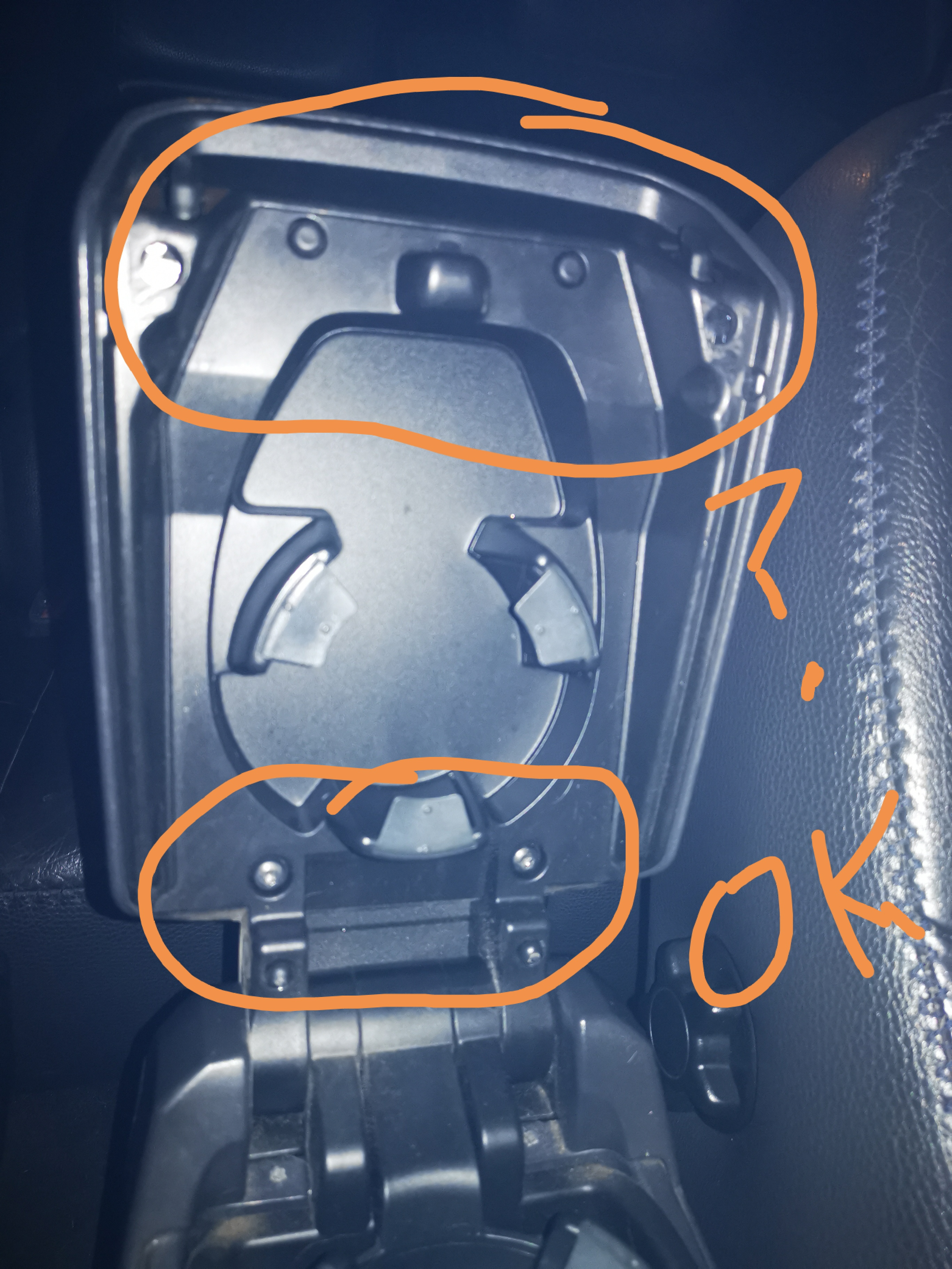

Some more photos to illustrate.
#1:
I'm trying to separate "A" from "B".
I can get the bottom two T25s off, no problem ("OK"). But there are two screws at the other end and none of the holes seem to lead to them, including the holes.behind the two rubber nubs.

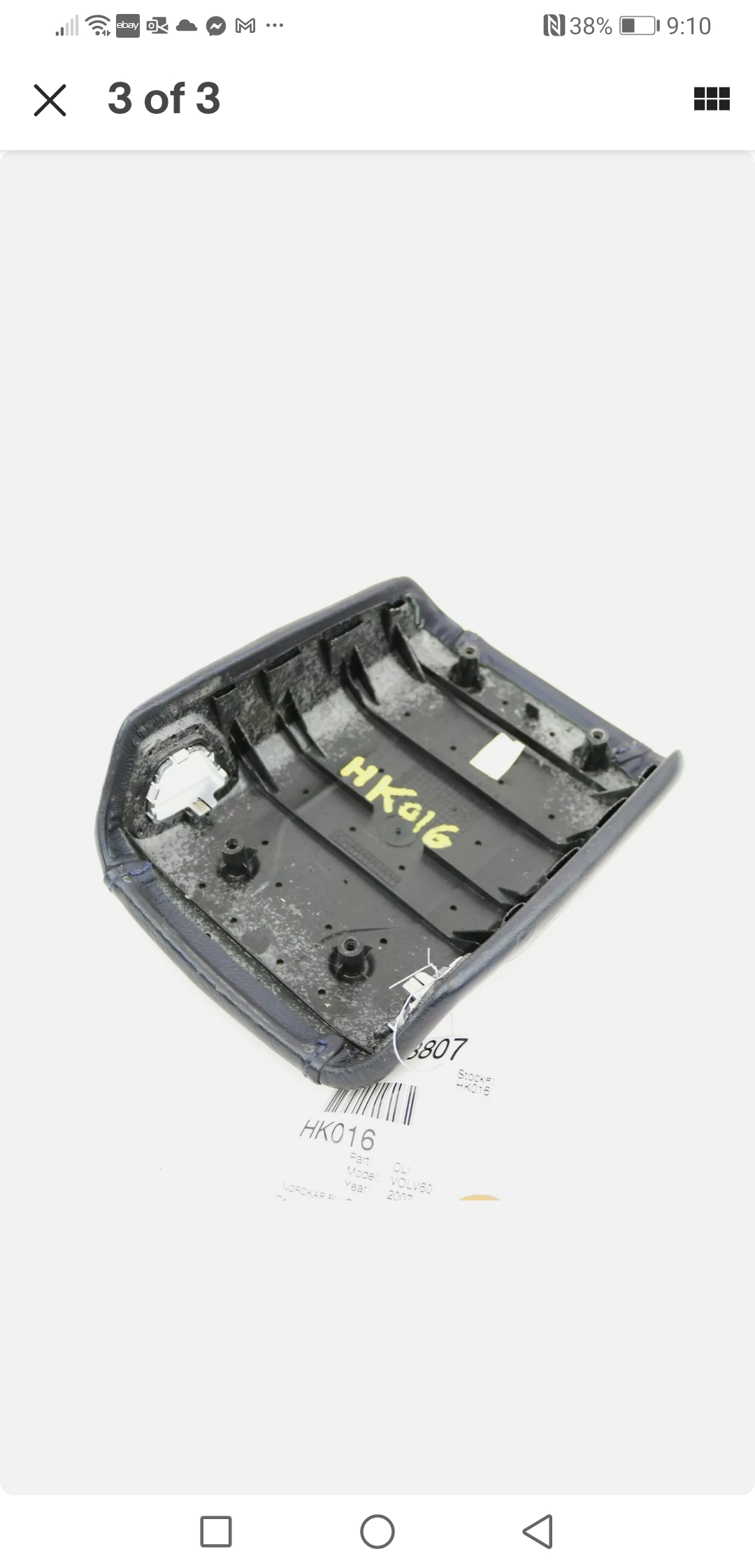

Sorry for the broken photos! Let's try again.
Here's (someone else's) photo of the piece I'm trying to remove. It's a frequent sale item on eBay and elsewhere, so obviously it's removable somehow, and as you can see in the photo, it's held in place by four screws:
Problem is, I can't figure out how/where to loosen the two screws next to the buttons. (Or in the above photo, next to the button holes.) They do not seem to be exposed.
Here is a shot from my armrest illustrating what I'm trying to get off. I'm trying to get piece "A" separated from piece "B" so that I can take off the old vinyl and replace with new vinyl that I already have here:
When I take out the two screws on the opposite side from the buttons, that end can pull away by a good inch. I'm so close! It's just those two screws by the buttons that I can't figure out how to remove.
Here is the bottom of the armrest. You can see the two screws I can get out ("OK"). But where are the other screws?
I thought that taking the little rubber nubs out on the button end would reveal them, but it just revealed empty holes. :-/
I know I'm missing something simple, but I need help to figure out what it is.
