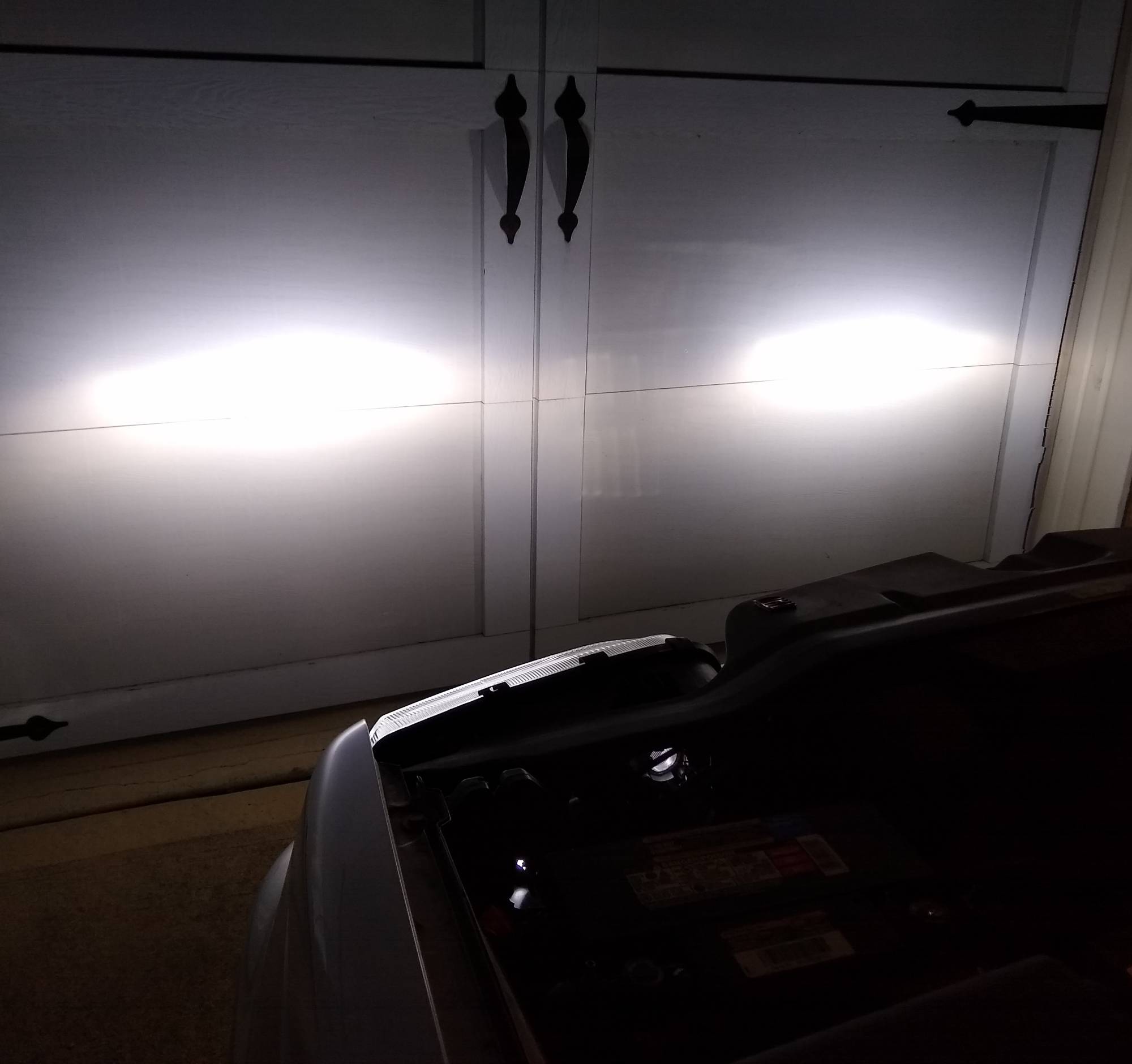

So many things but needed to tackle this. Was really in a hurry so the paint was really sloppy with runs and lint.
Even though the light was pretty bright the reflector coating was definitely bad. Imagine what the dim one on the driver's looks like inside.

I have never been patient with spray paint so had to sand the primer of runs. Painted when it was windy outdoors so lot of little debris also. The reflection was better on my Son's 08 C30 mirror cap. It should be decent if you follow the instructions and are patient. Lots of reflection for what it looked like and how it turned out. The first photo shows how dim it was on the driver's side before the painting.
Got it at Lowe's and use the primer that goes with it. Threw out the primer can already so don't have exact number. No way near the chrome on the cap.
