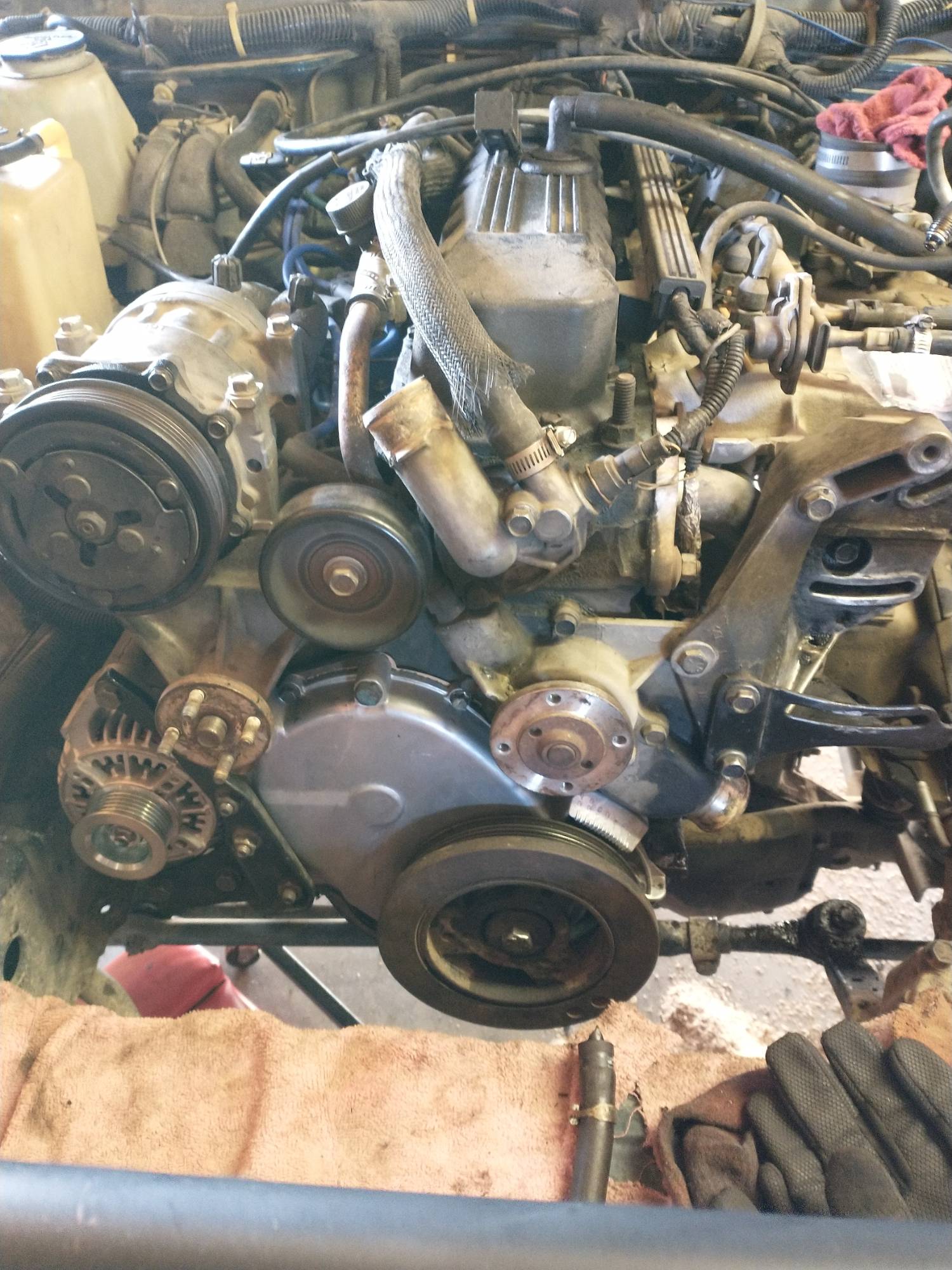

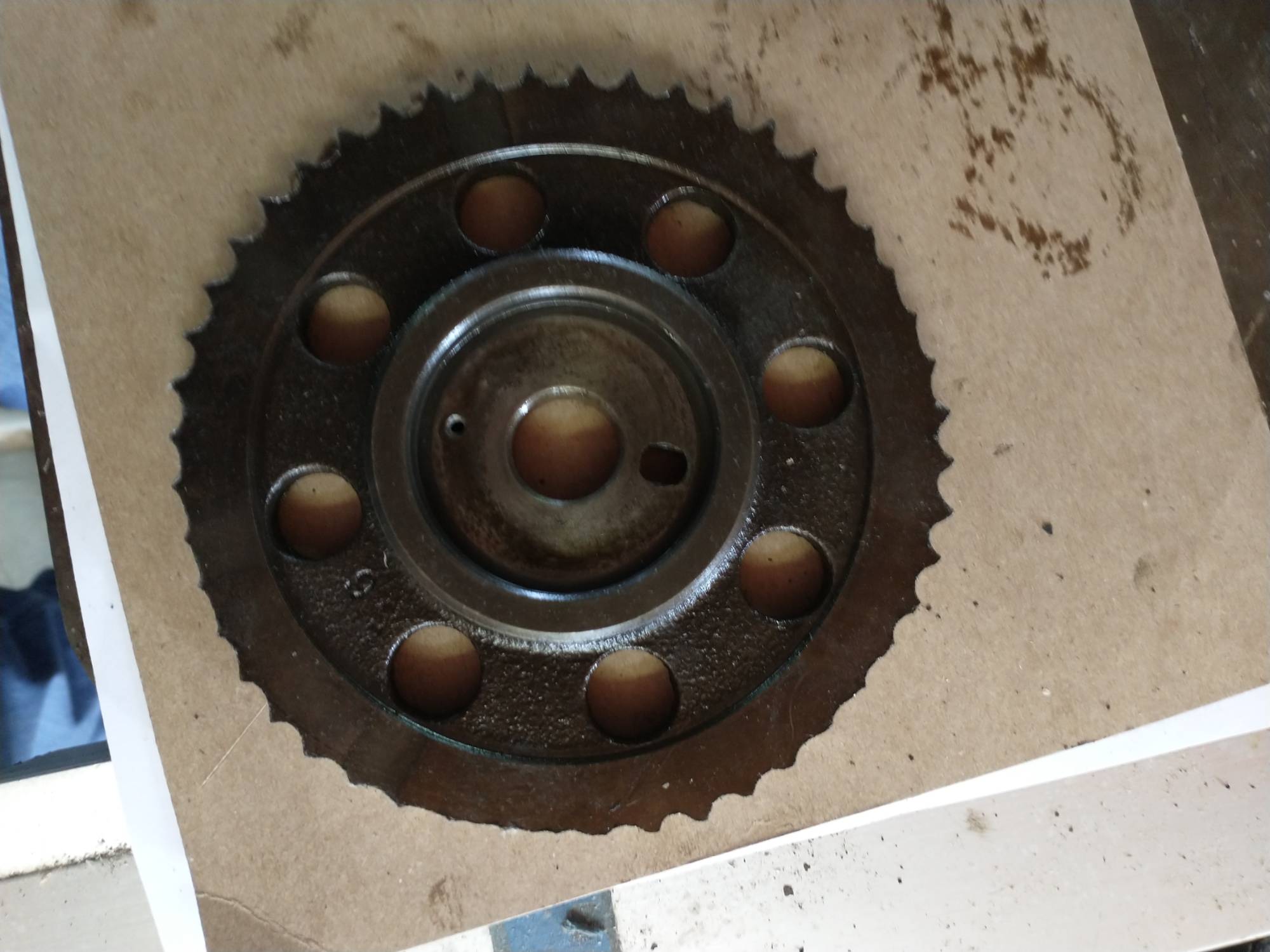

This is why I love non-interference engines. Spun the teeth off the cam sprocket of my '94 Cherokee. Just died while driving. No mechanical sound at all. Just died like the plug was pulled. Only had 150k on the timing set. Won't comment on " import " parts.
But apx 4 hours later all replaced. You just have to love the simplicity of these engines.

This one had me stumped because when I checked the rotor, it did move some because there were still some teeth left. Just not as many.
But it seemed slow to rotate. Eventually figured that regardless of movement, only explanation left was a timing chain failure. I wasn't expecting to find an intact chain, but stripped sprocket.
I can't understand why manufactures would make interference engines. My son has a Ranger with a V6. They offered two V6's for that truck. One is interference, one is not. Really ? Go figure....
