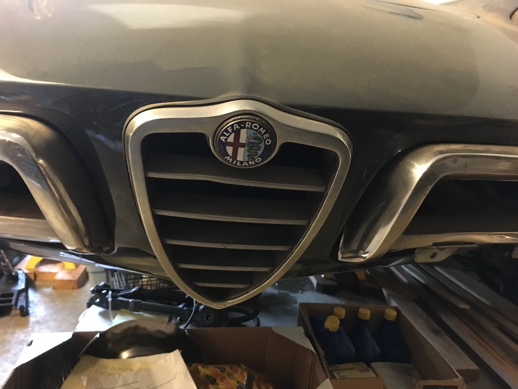

More recent... That little ridge above the badge is all metal instead of putty or flattened like happens when they fix them. Only this car had that - all later years had a smooth nose.

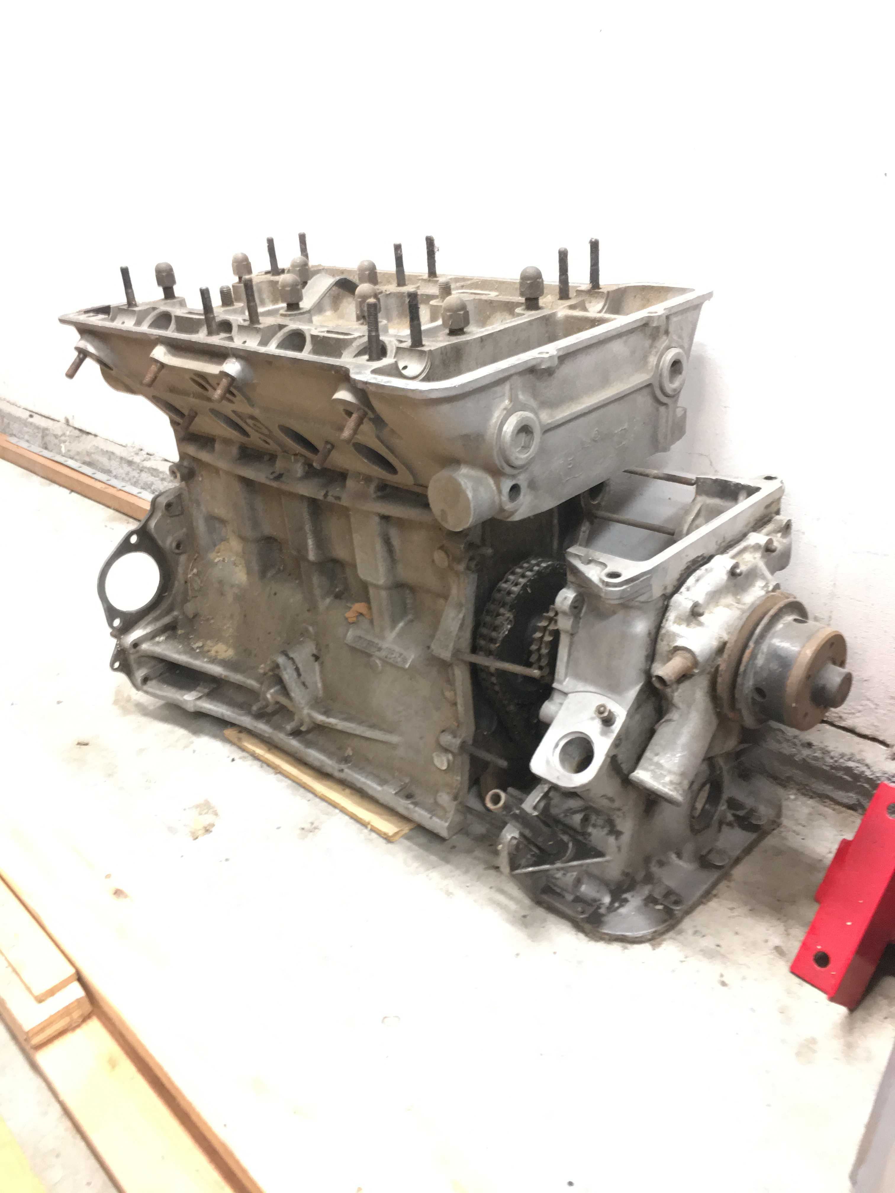

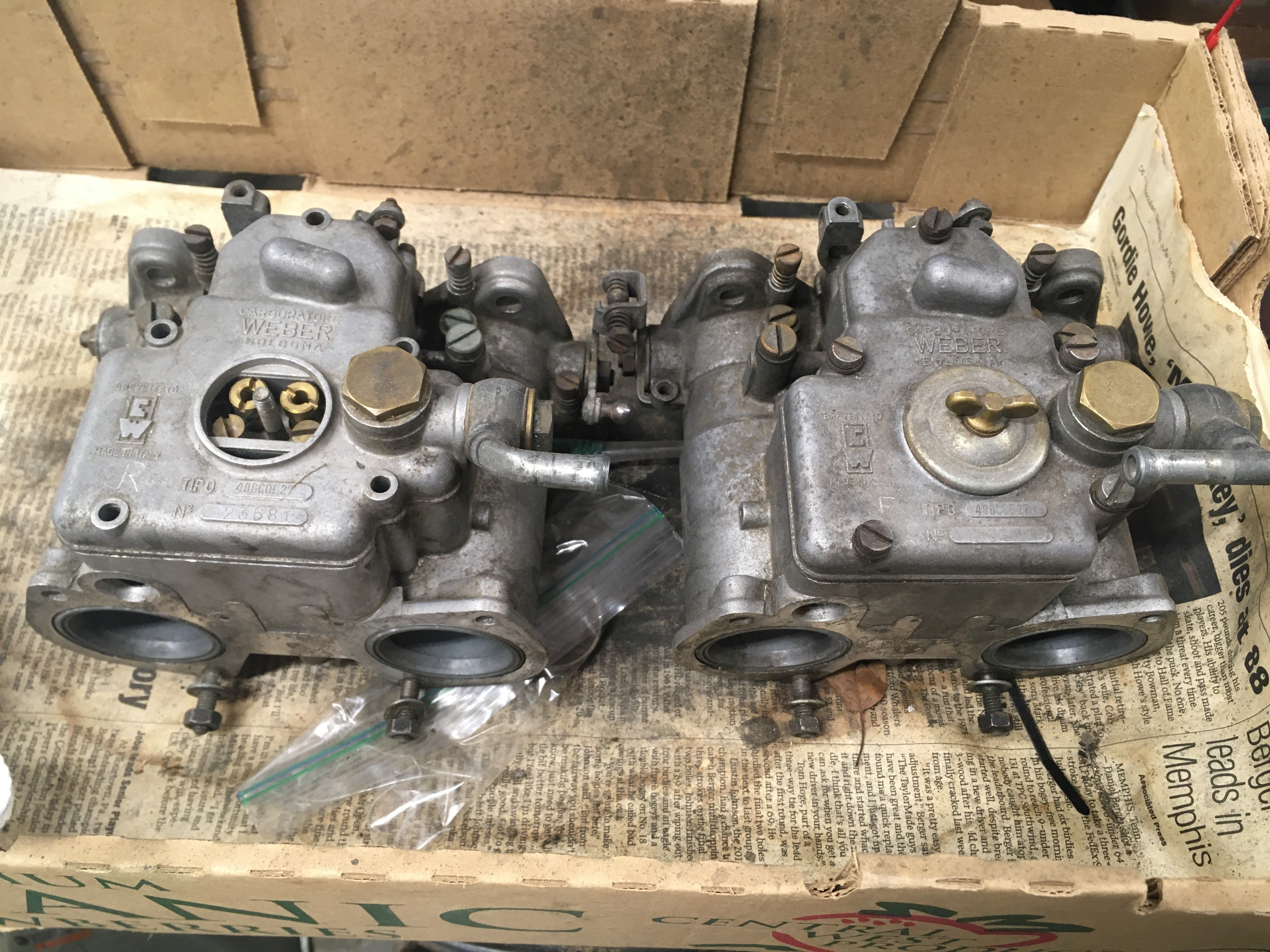

Spare engine I've hoarded...
They keep just looking at me every time I go in the garage.... "You have no idea what you're doing, do you!"

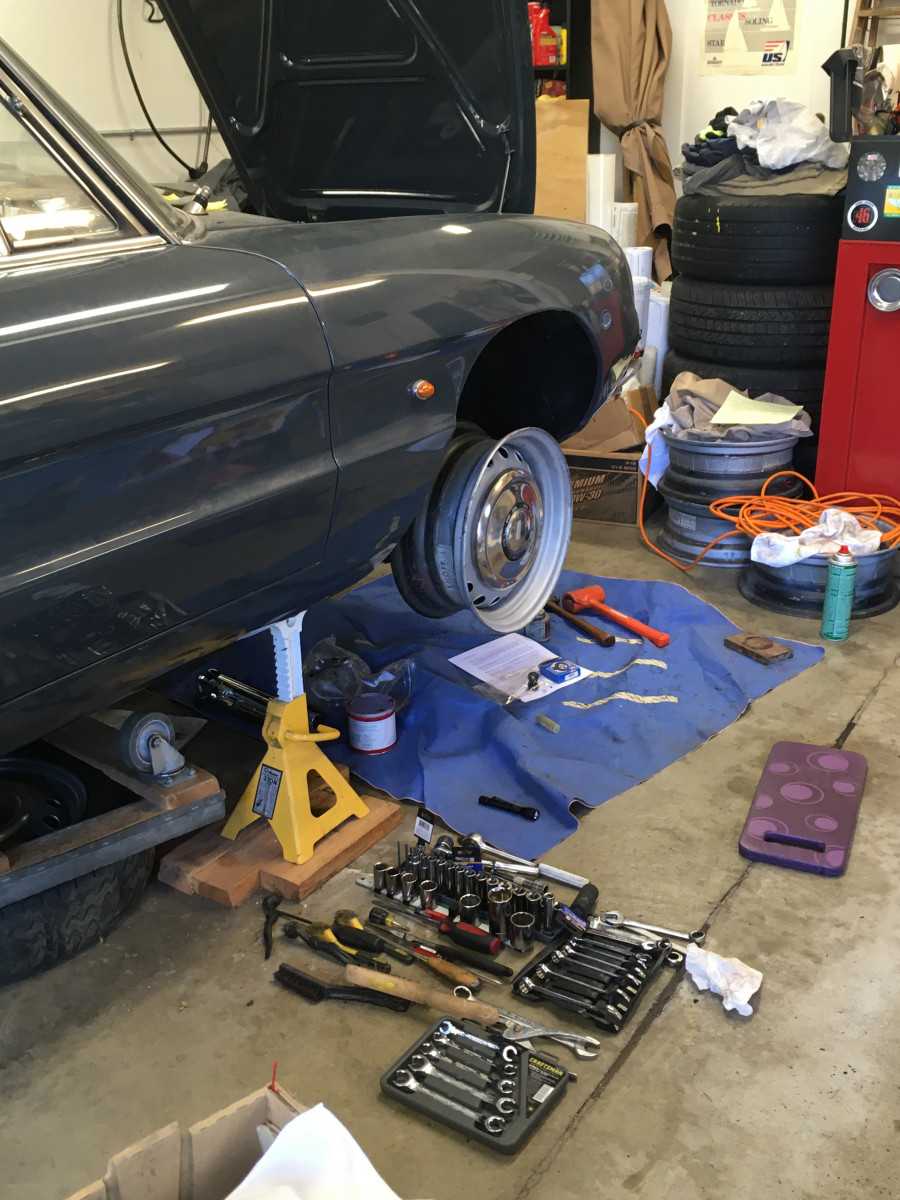

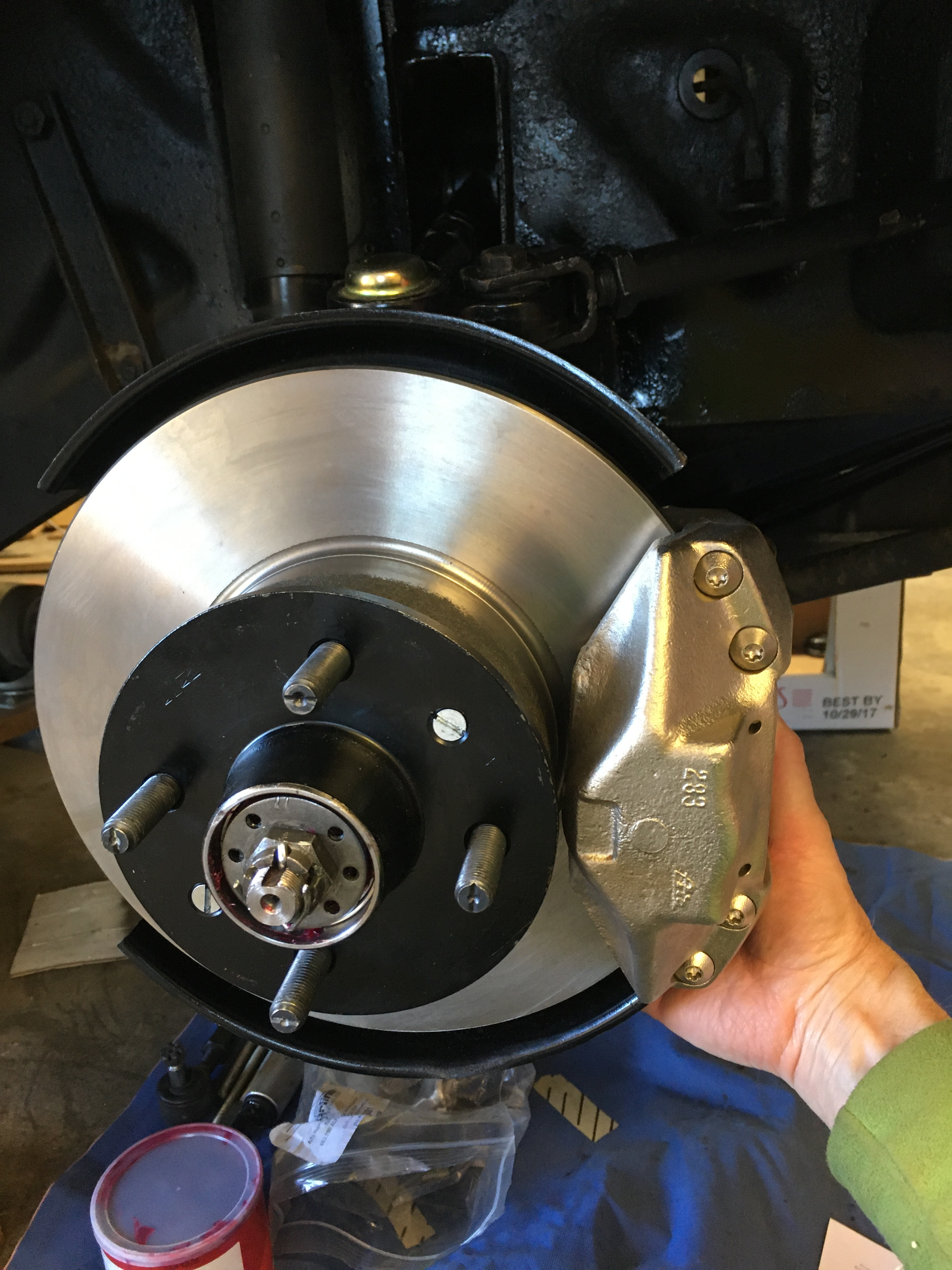

Weekend progress.

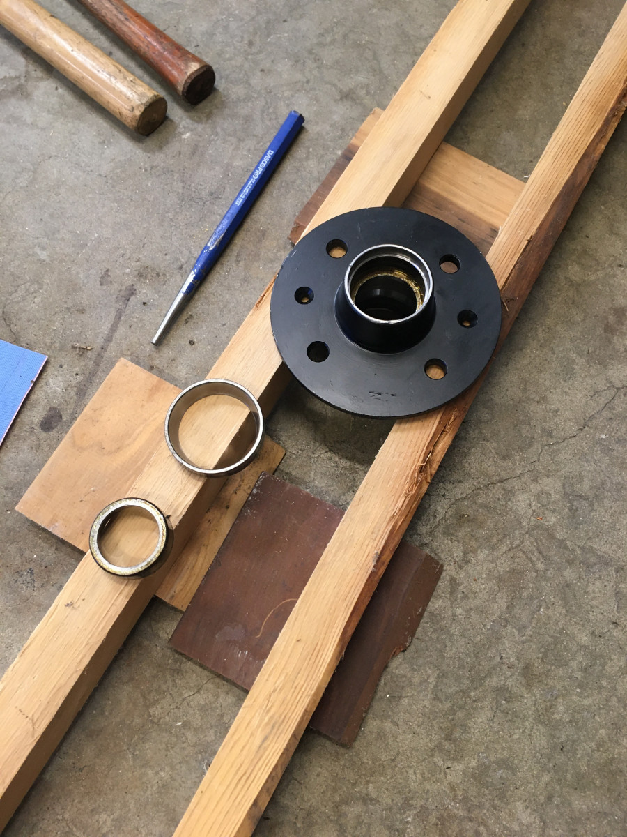

It's been a long long time since I pounded in new bearing races. I thought I was clever using the old one to get it started in the bore....but then the old one got stuck and had to come out.
Lots of good new red grease packed in, seal on, and got it together. As I was tightening and spinning, there was metal grinding and it wasn't good. I was about to start pounding the gravel shield back. Maybe I put the pieces on in the wrong order! Maybe I bought the wrong rotors!
I had forgotten to snug the rotor to the hub with the big set screws, so the rotor was just flopping around. Whew.
I remembered that the bleed screw is always UP! Went to find the right one in the box.

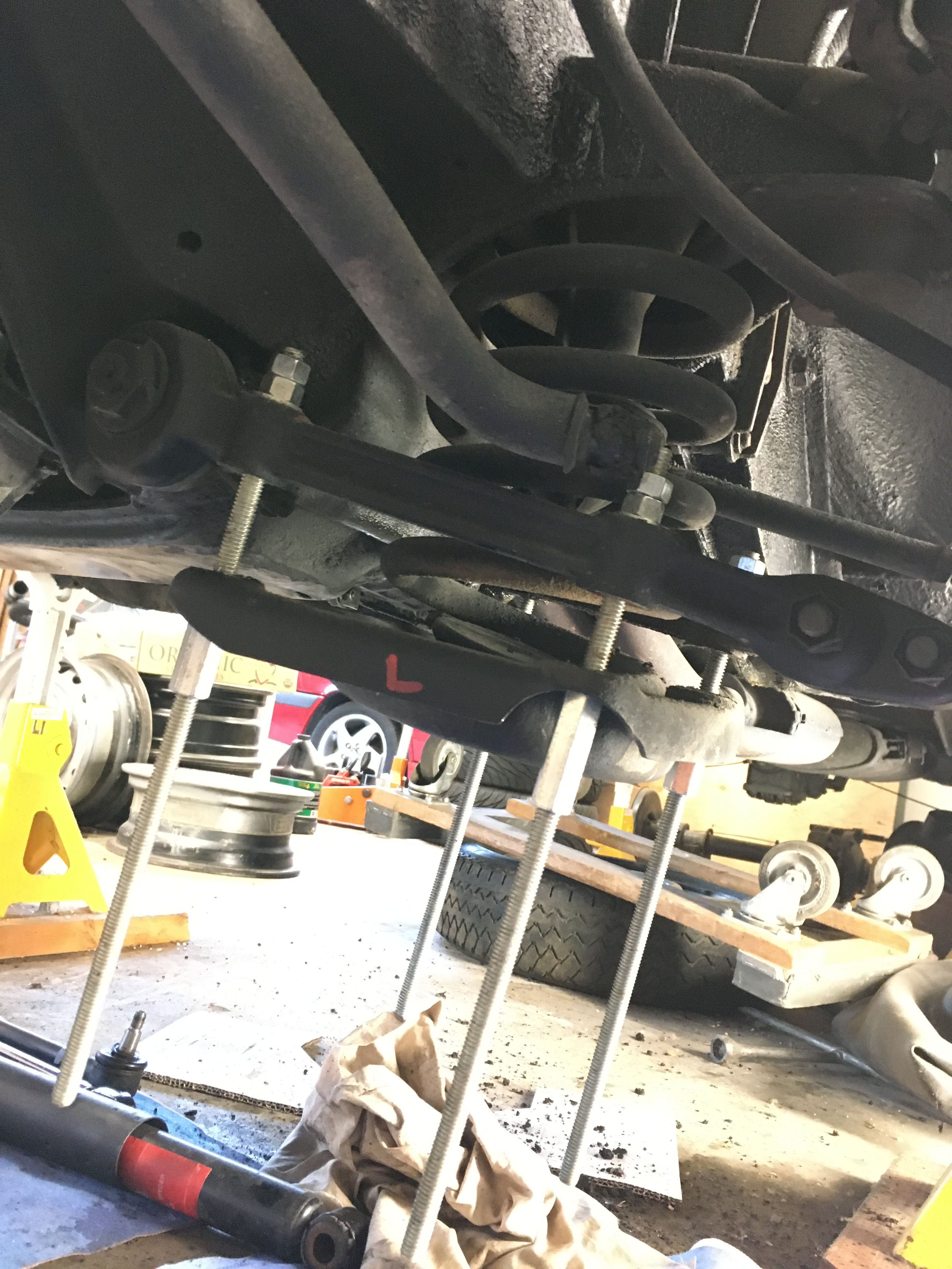

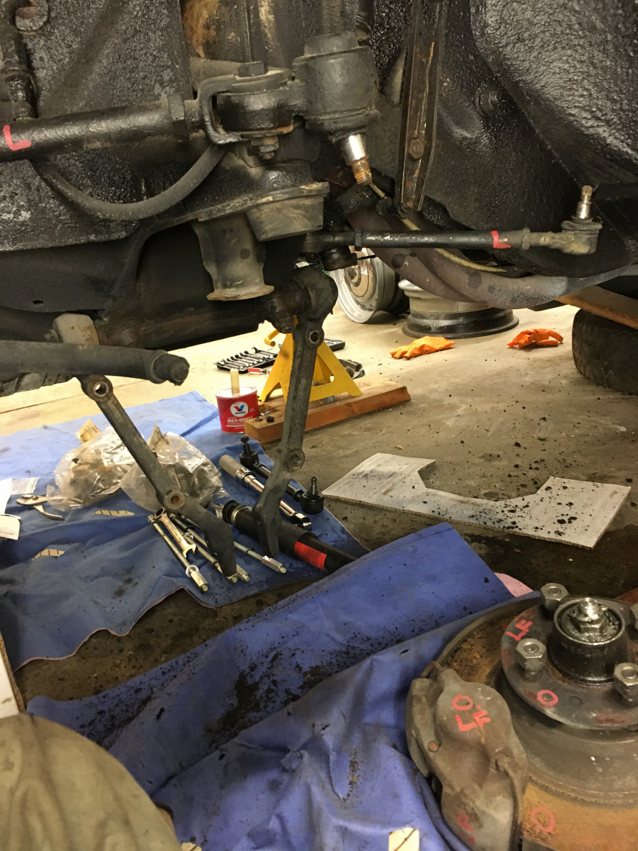

So now that it's pretty much together, I don't need the LF as a pattern, so I tore into removing everything yesterday. Beautiful day, garage doors open. My wife was gone, and I just kept working until almost 9PM and went inside exhausted. Oh...food, that's right.
Here's the spring pan coming down. Slick system, and safe. You just use a 9/16 ratcheting box end wrench on those tall nuts and buzz them down until they're slack.
Everything goes fast until you come upon a balljoint castle nut with a corroded cotter pin. Couldn't get hold of it with any kind of pliers or vice grips. Tapped a pointed awl tool into the loop and bent the tip 90º (HF, cheap). Tapped my tiniest screwdriver into the loop and snapped off the tip. After an hour messing with it and getting frustrated, I took the dremel with a cutter wheel and cut up into the nut parallel to the bolt shaft, and cut both sides of the pin off. Big long 19mm wrench and a hammer and broke it loose. Hub off, arms loose, just need to detach them from the chassis and start grinding and painting.
Couldn't resist checking out the wheel fit!..... It'll be way lower with weight on it.
