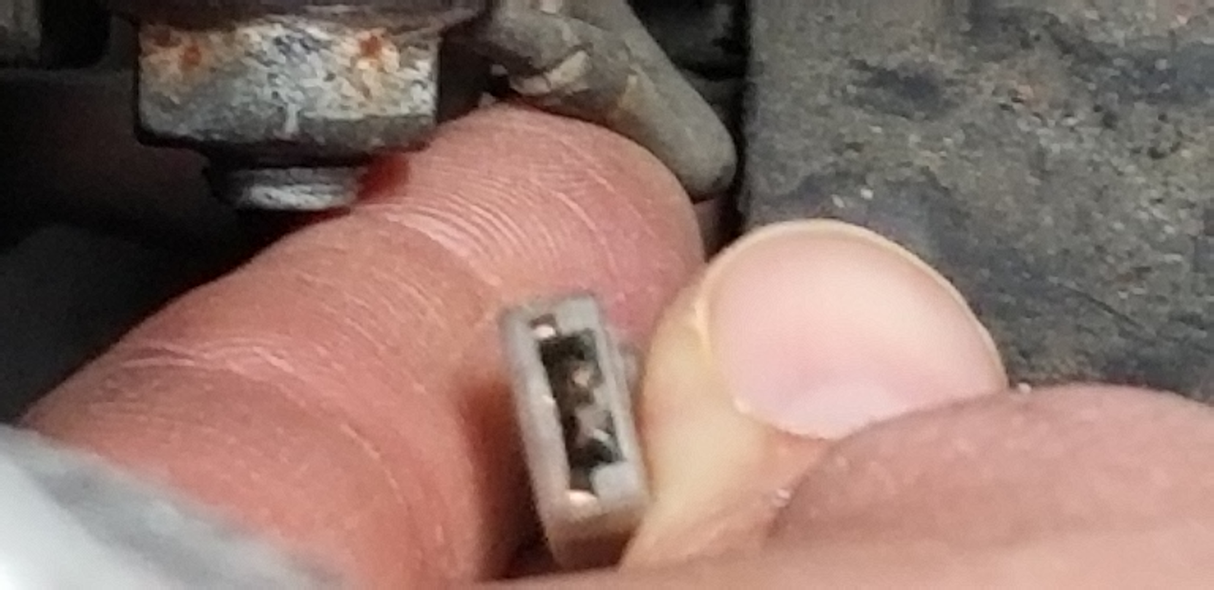

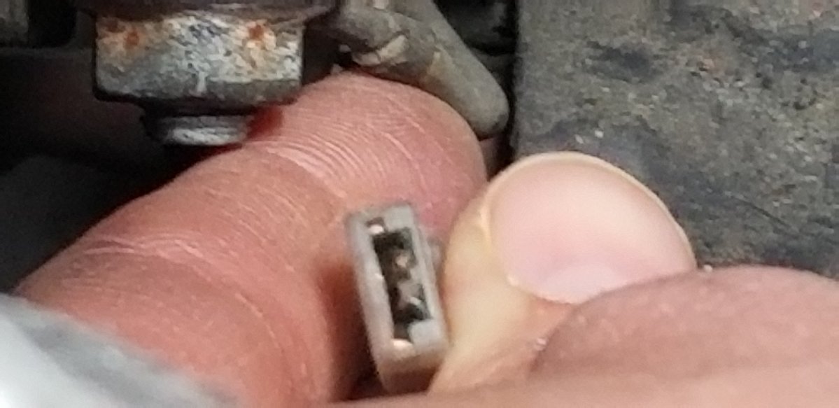

I was able to take the green wire off the starter and attach a cable from the positive terminal of the battery to where the green wire connects and it moved the starter. I couldn't tell if the red wire from the battery was warm or not. There did look to be some corrosion on the green wire connecter- inside the connector. I cleaned the post it connects to.
I did the moving through the gears vigurously (20 times) and that didn't seem to change anything either.
