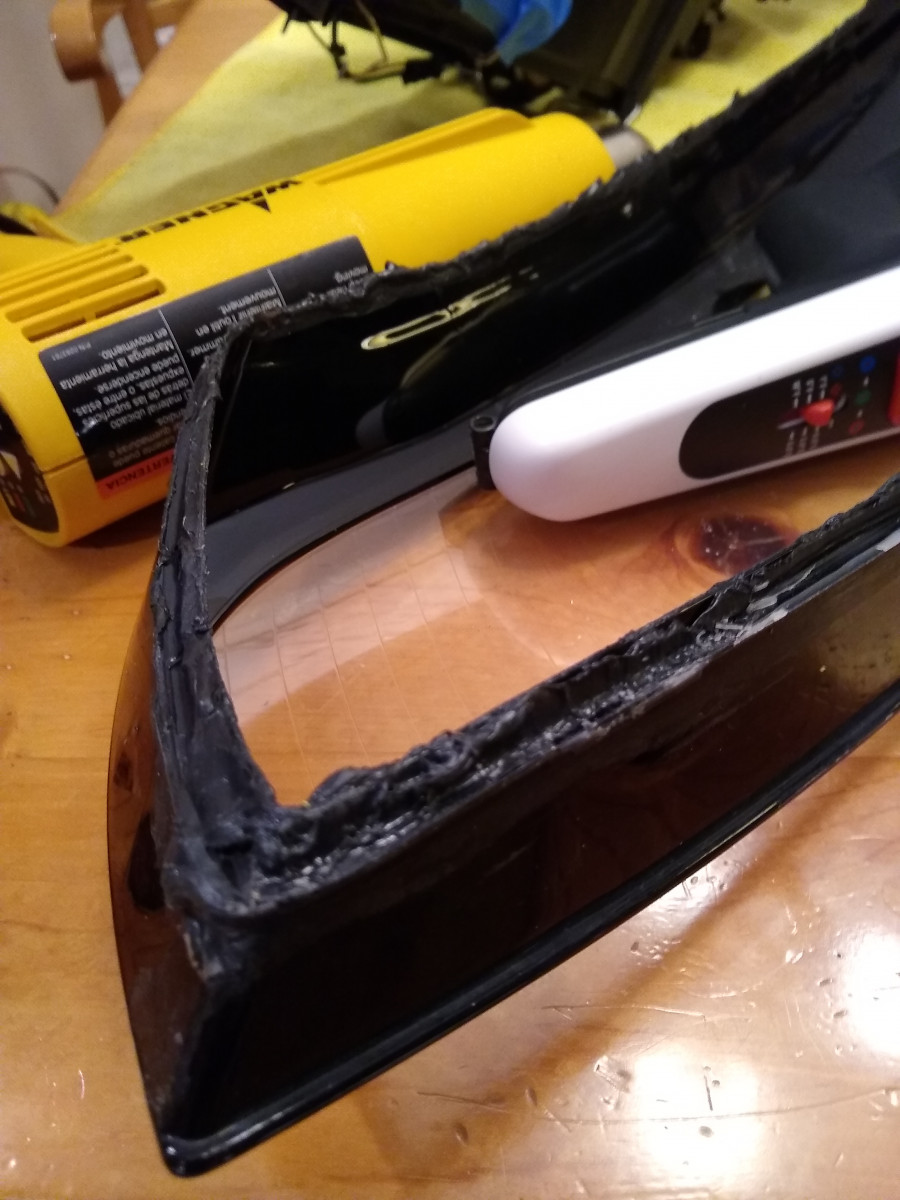

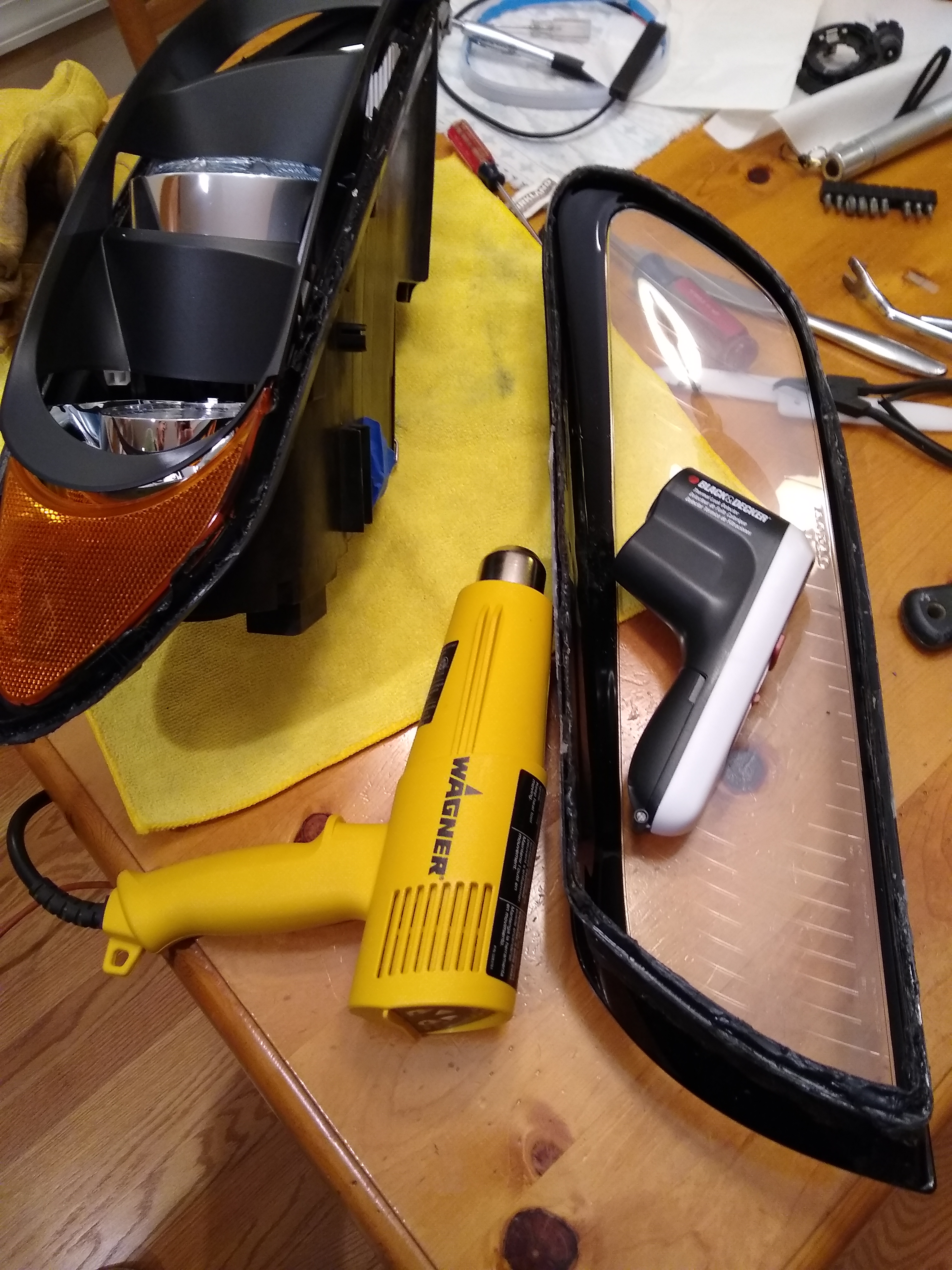

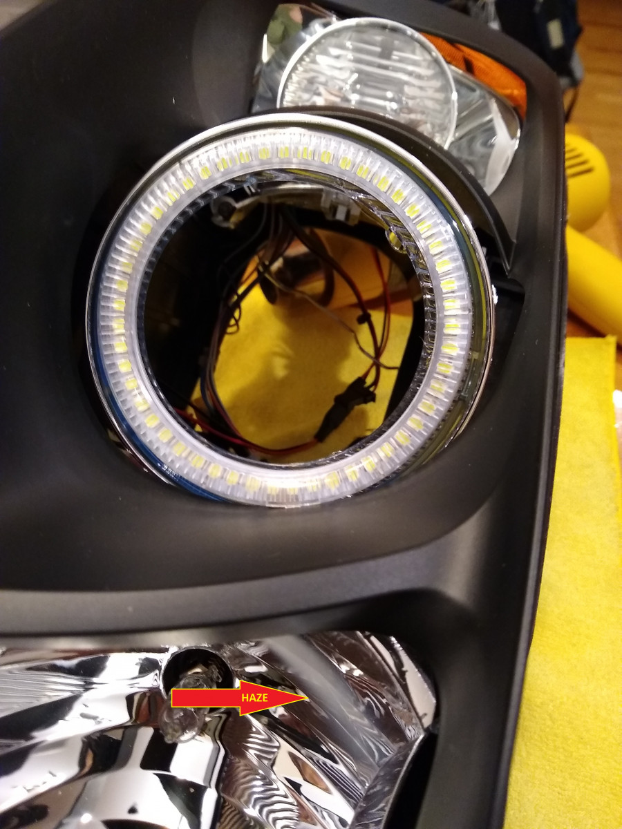

2nd method is with Avalon King. The C30 lights started taking on water. In order to clean the inside we decided to open it up. Well, putting in some Halo helped with that decision also. So far no more water or fogging inside. We also coated the entire car with Avalon King and Son says rain on the windshield is still water off a ducks feather. We do also use Tech Choice for a final wipe each time we wash the cars. Wipe the car but not dry and just spray and wipe off. This was recommended by (Thanks) Pete of MVS and it's been such a time savor and works great and as Pete says on everything. Think shower doors!
viewtopic.php?f=9&t=96620&p=568071&hili ... ce#p568071
Used the temp gun to make sure we didn't overheating the plastic. I think we set it at around 240 degrees but check some videos with people who baked the whole assembly in the oven on temp.
Heat then moved / spread the old goop around evenly and reassembled, finally silicone the top of the seam.
Use only water to dust the reflectors as some of the chrome will come off with light detergent. Don't attempt to buff or remove haze
