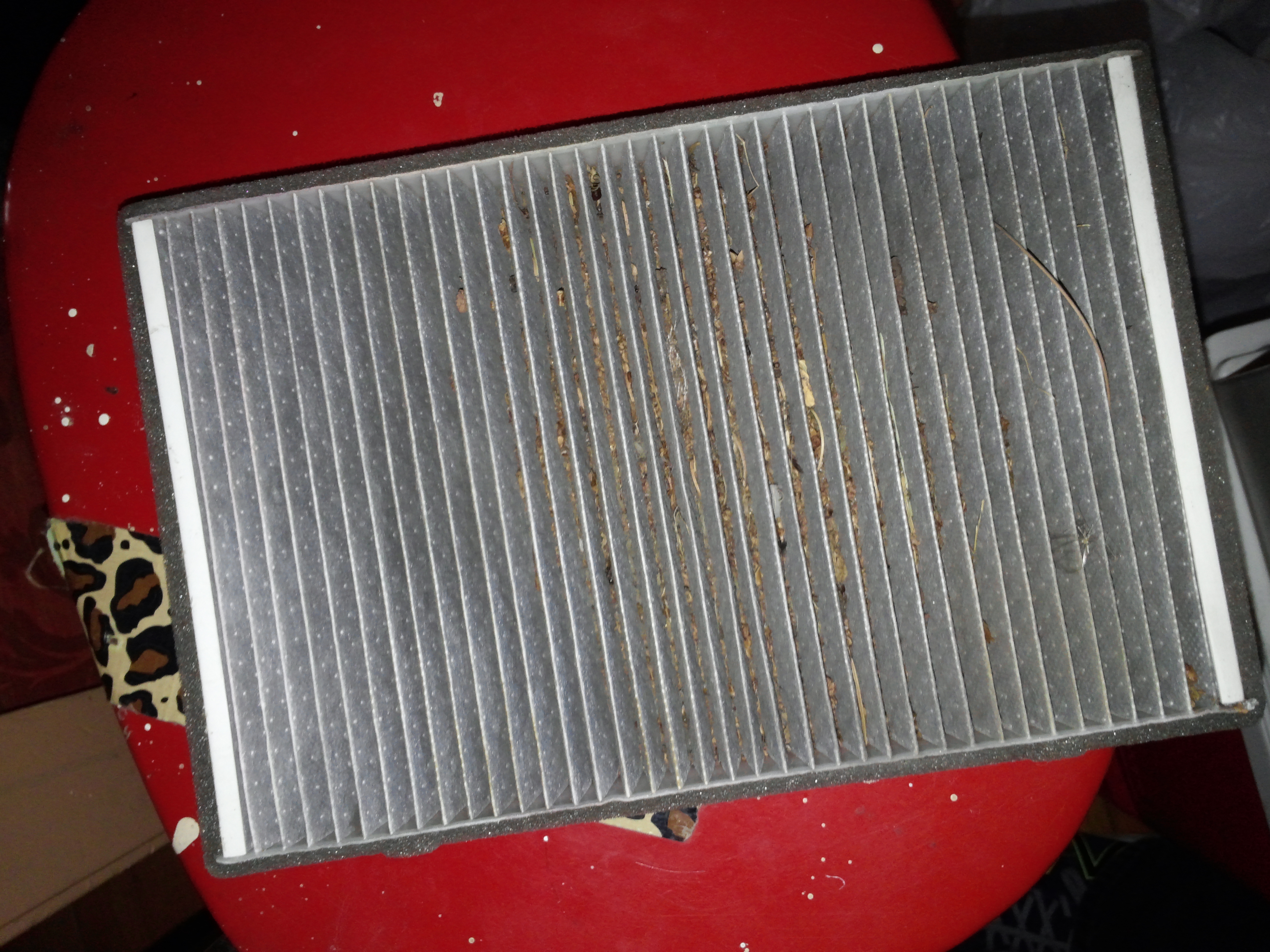

Replaced the pass. side lower engine mount, cabin air filter, siphoned the power steering fluid reservoir and added new atf. Then a swapped the radio and hvac light bulbs. Didn't realize the 7219's were too small for the hvac until I had it opened. Tried it out for a whim but no go. So i have to replace them when i get the correct size.
I did recycle the black bulb holders in the radio, which was pretty easy. Just make sure you trim them flush or upon reinstall or you'll get smoke out the front of the radio, luckily all is good after a trim and tuck of the filaments. As a chuckle here is a picture of the overdue cabin filter too. Might have made it a few more miles.
