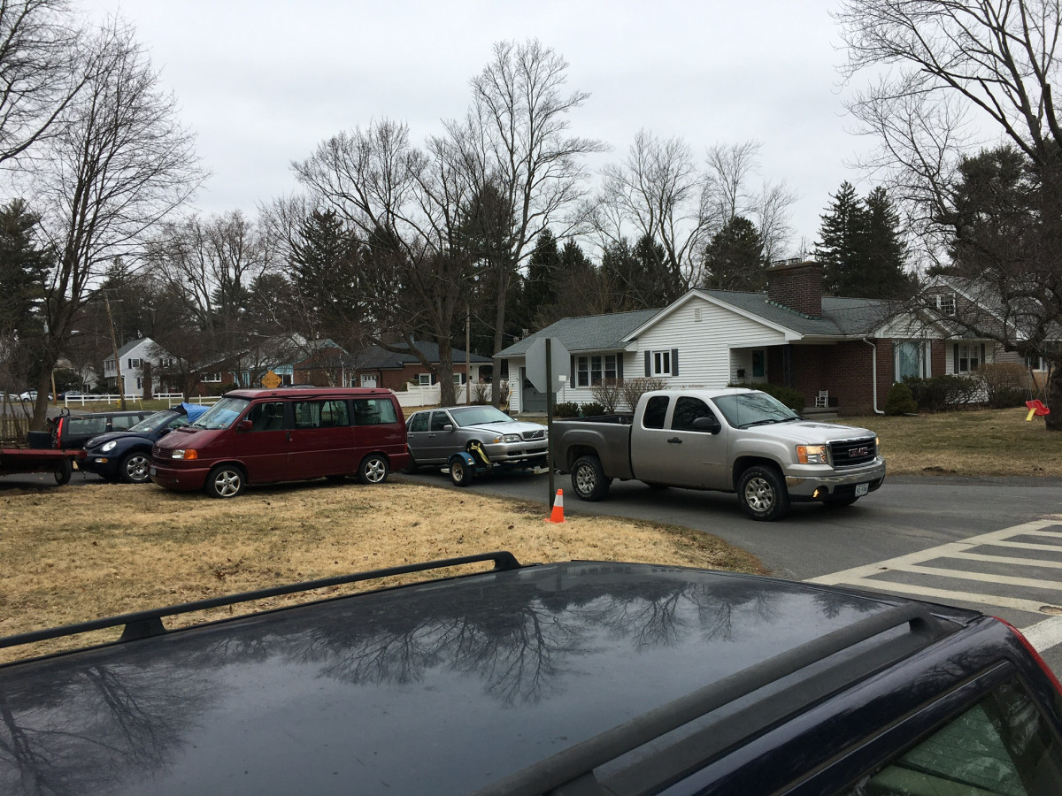

Pushed Ekaterina out of the driveway, aired up, put an old battery in to put windows up and open gas flap. My friend Mike came, we dollied up and made the short trip to the lift
Trailered nice at 60,swervy at 70

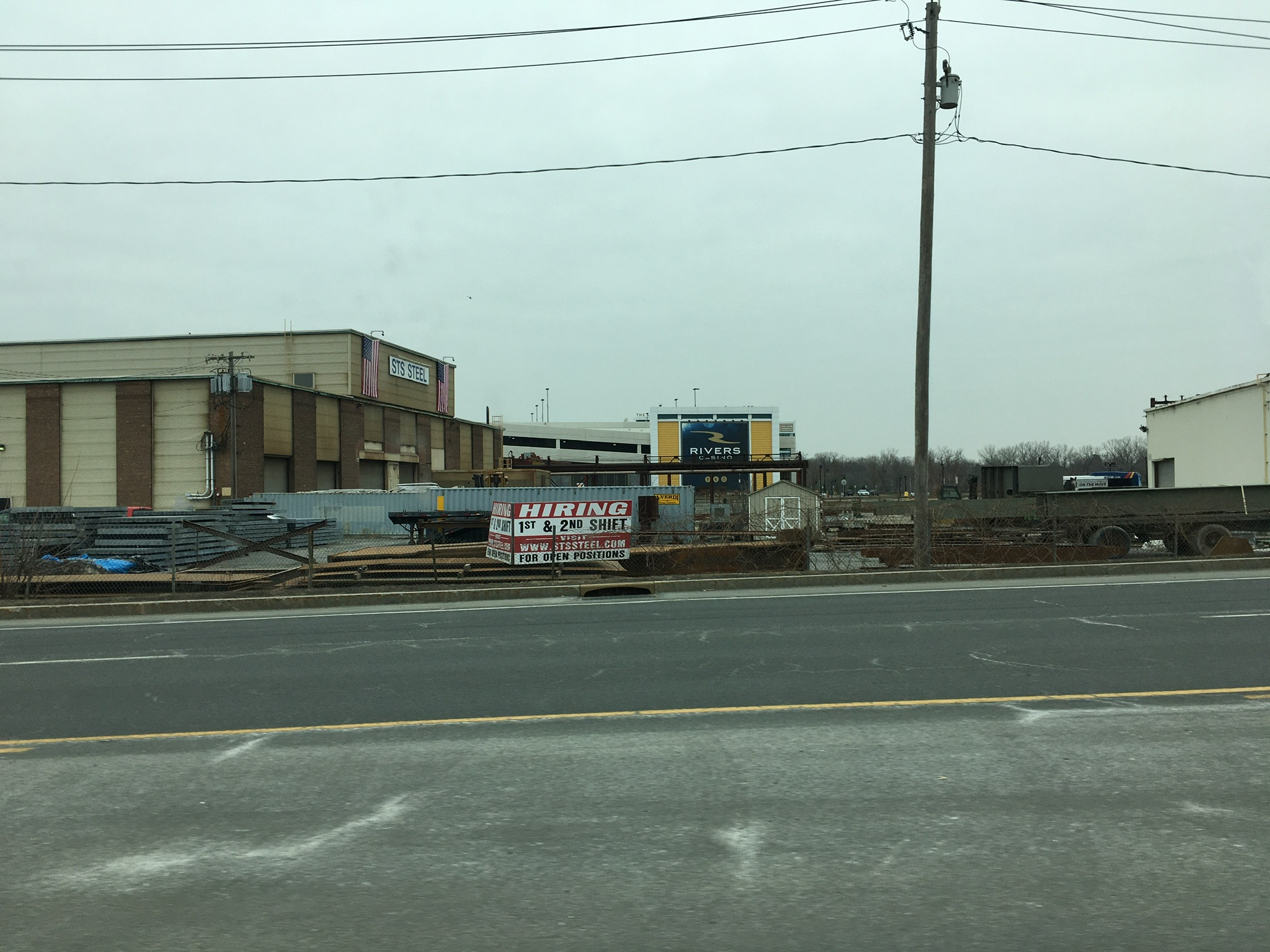

Passing STS steel, the remnants of a huge steel industry in NY

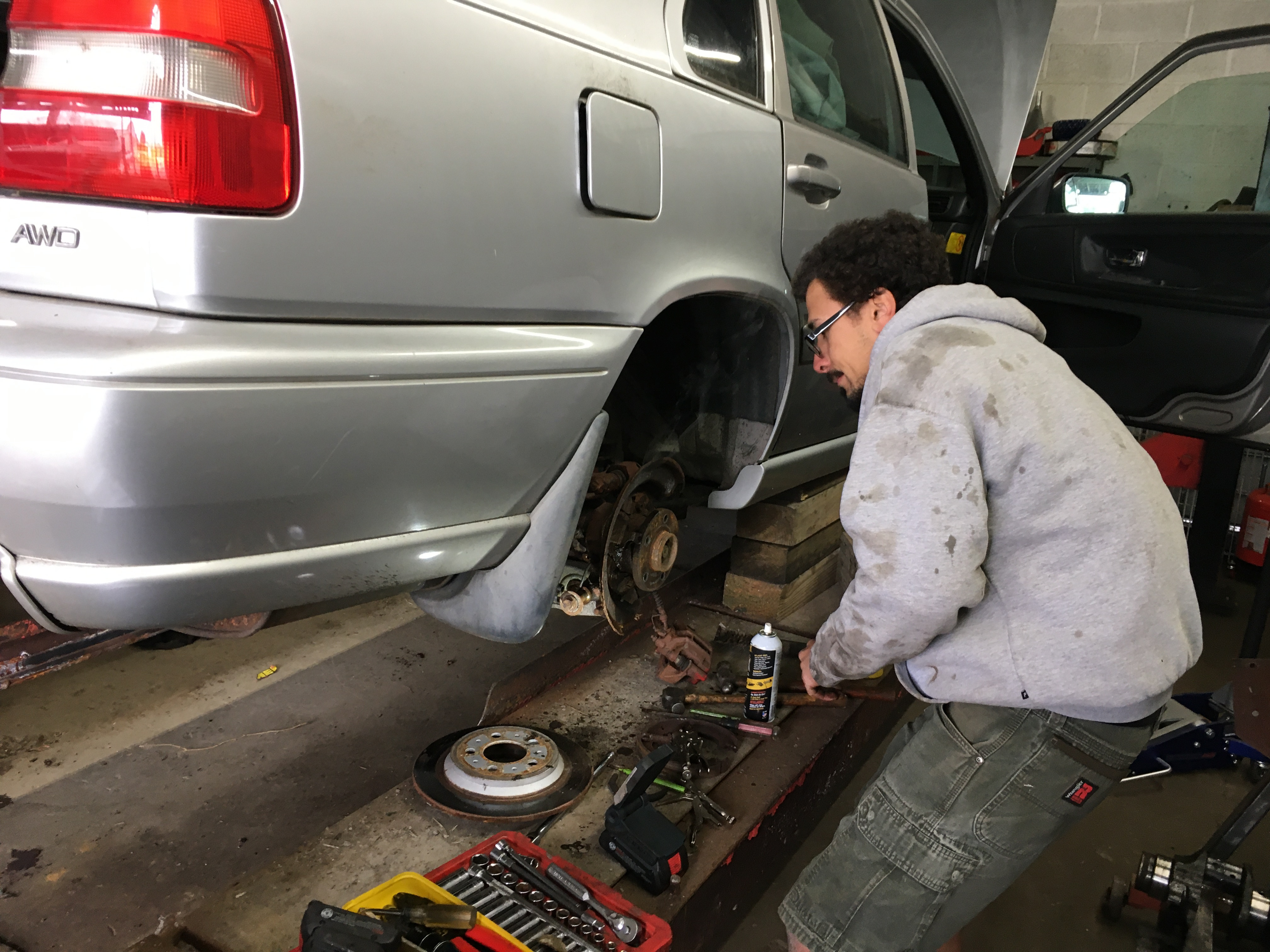

Settled Ekaterina into the Bay

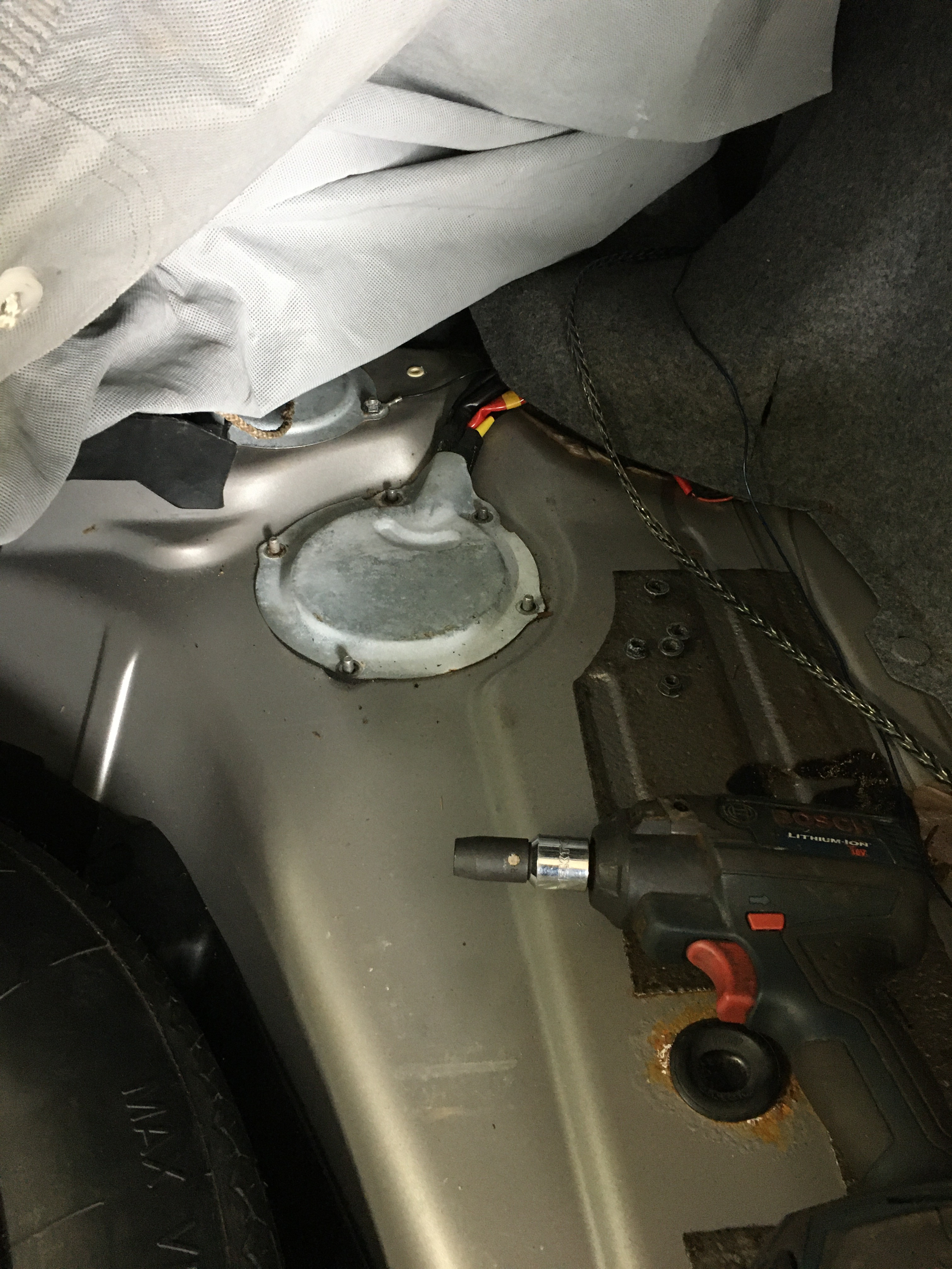

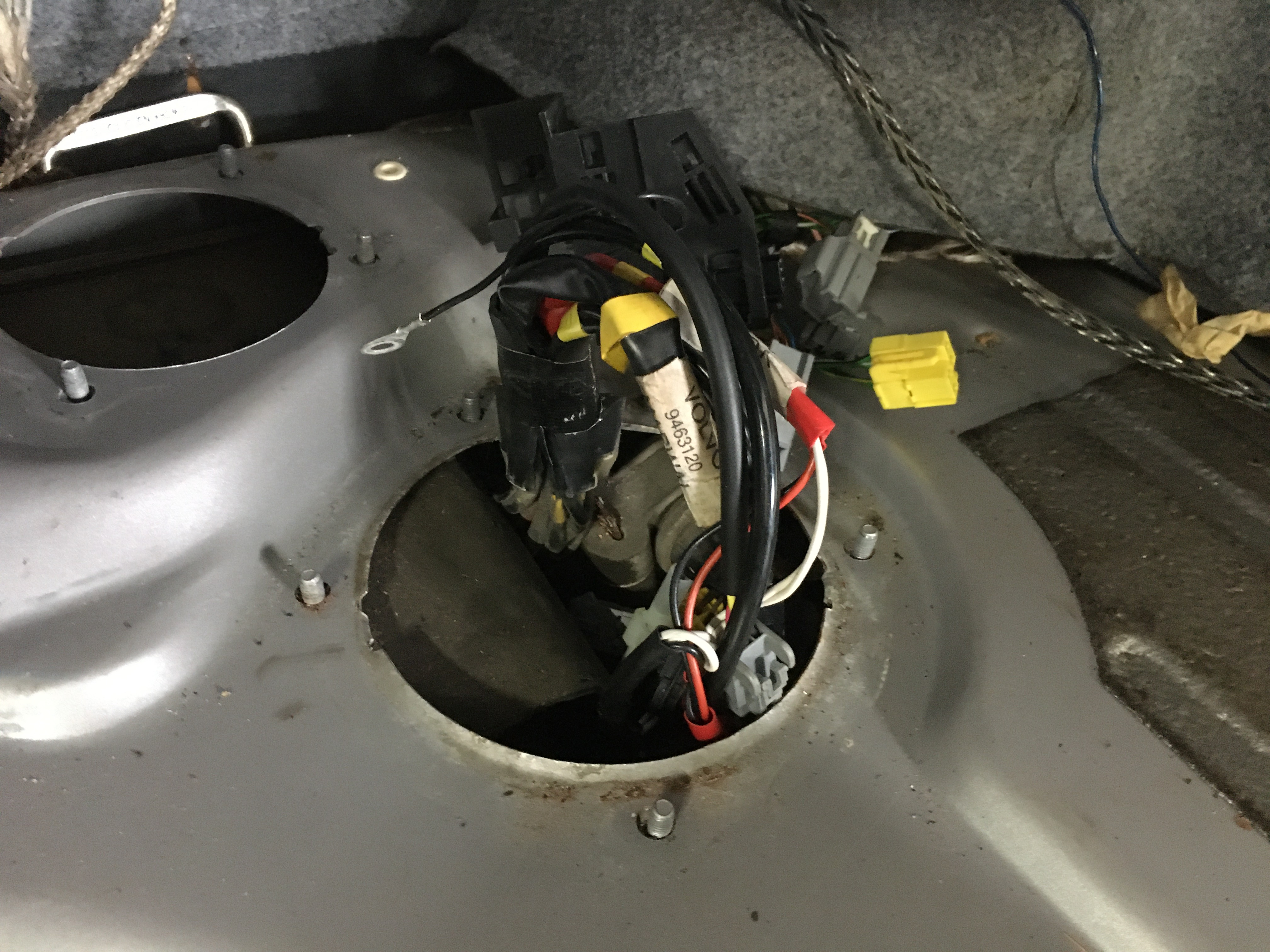

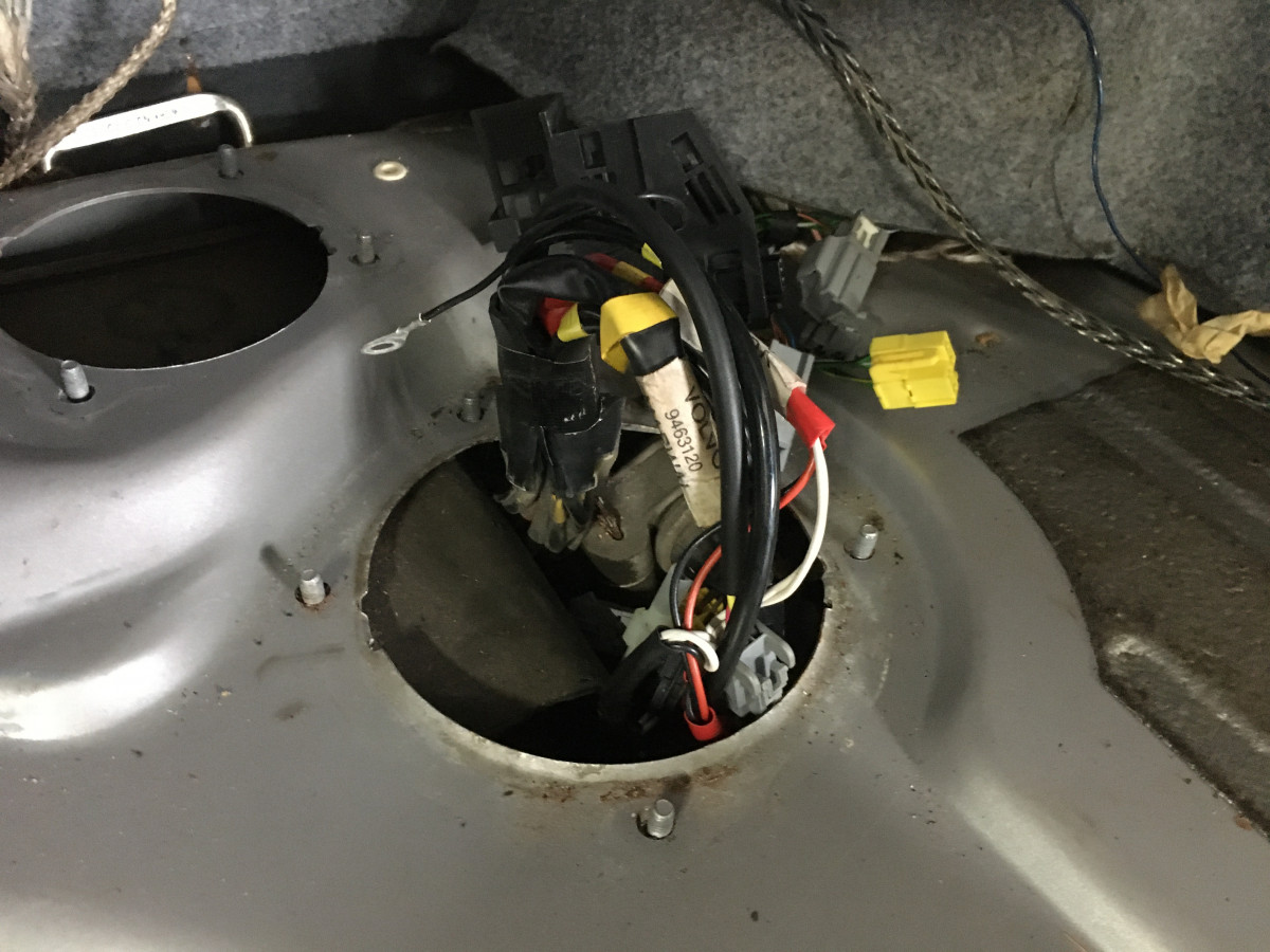

Popped the 10 mm nuts and did the electricals from the trunk
Removed the snap ring and pushed the fuel filler gaiter into the hatch hole
Up...up...up..up
Removedparking brake cable, quick call to Neil inCalgary to confirm the slightly different config of the AWD. PINS VS HOOK cable attachment.
Blocked Ekaterina up under the rockers to access the axle

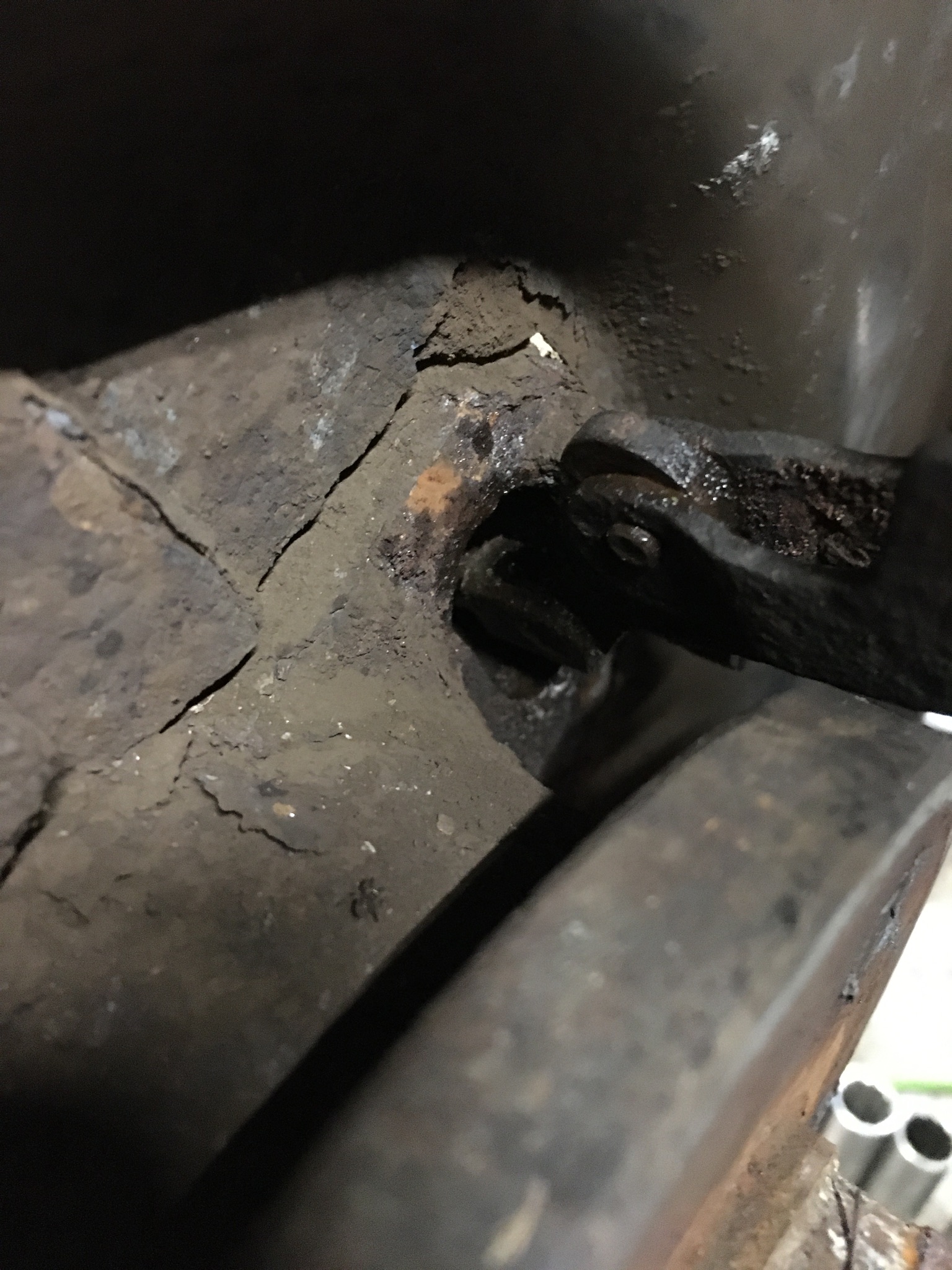

Torque rod bolt out.
Burned off exhaust clamp and removed rear exhaust

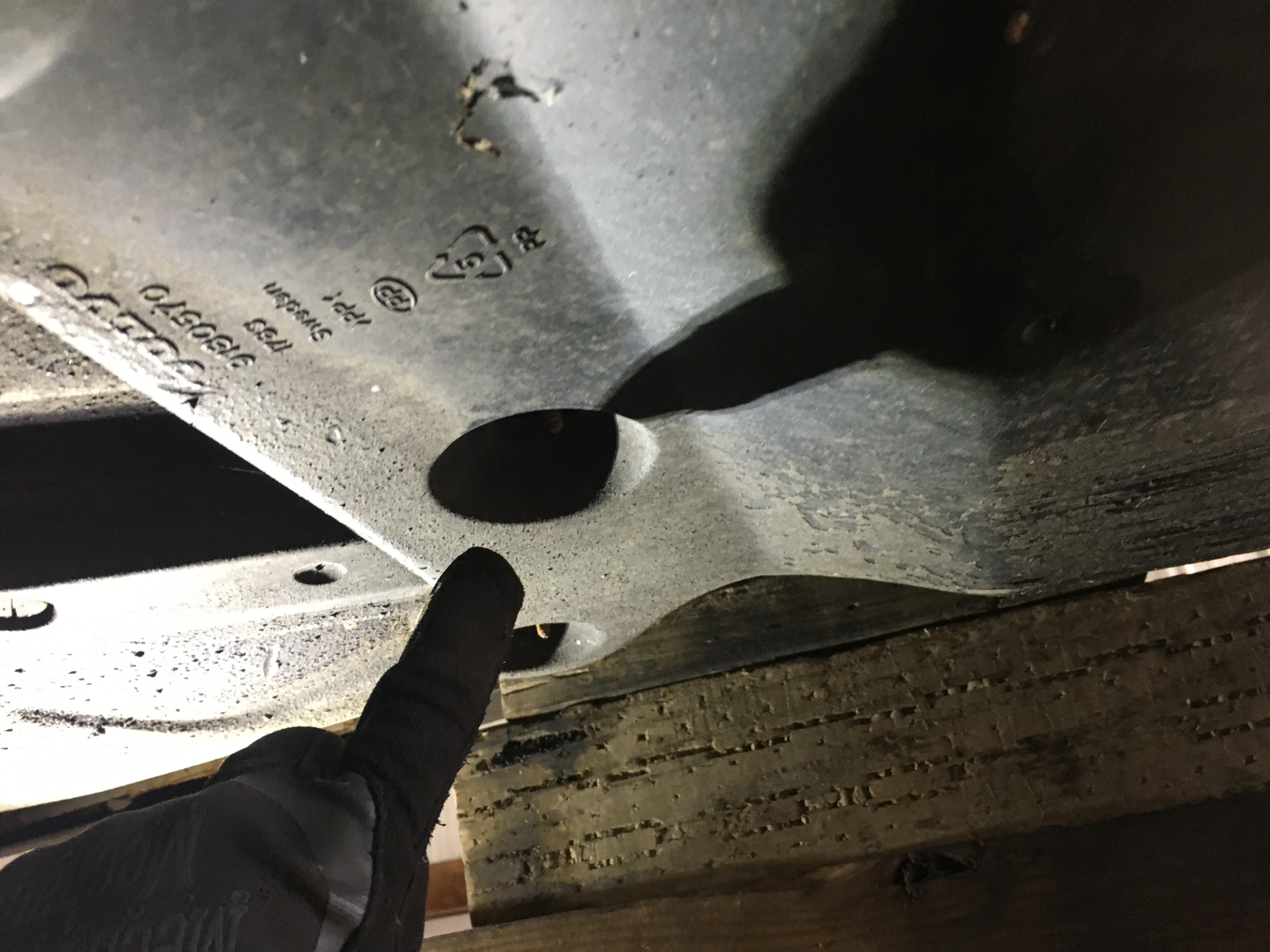

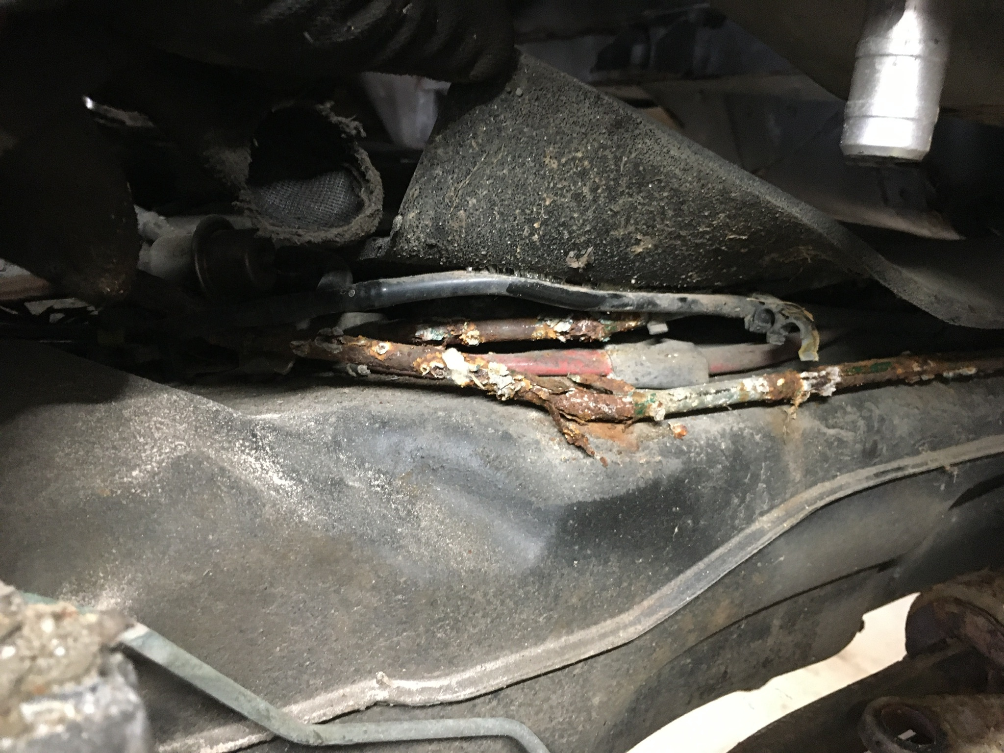

Fuel and vapour line , removed the plastic tray that covers these.
Unclipped brake line
Posts: 35267
Has thanked: 1497 times
Been thanked: 3809 times

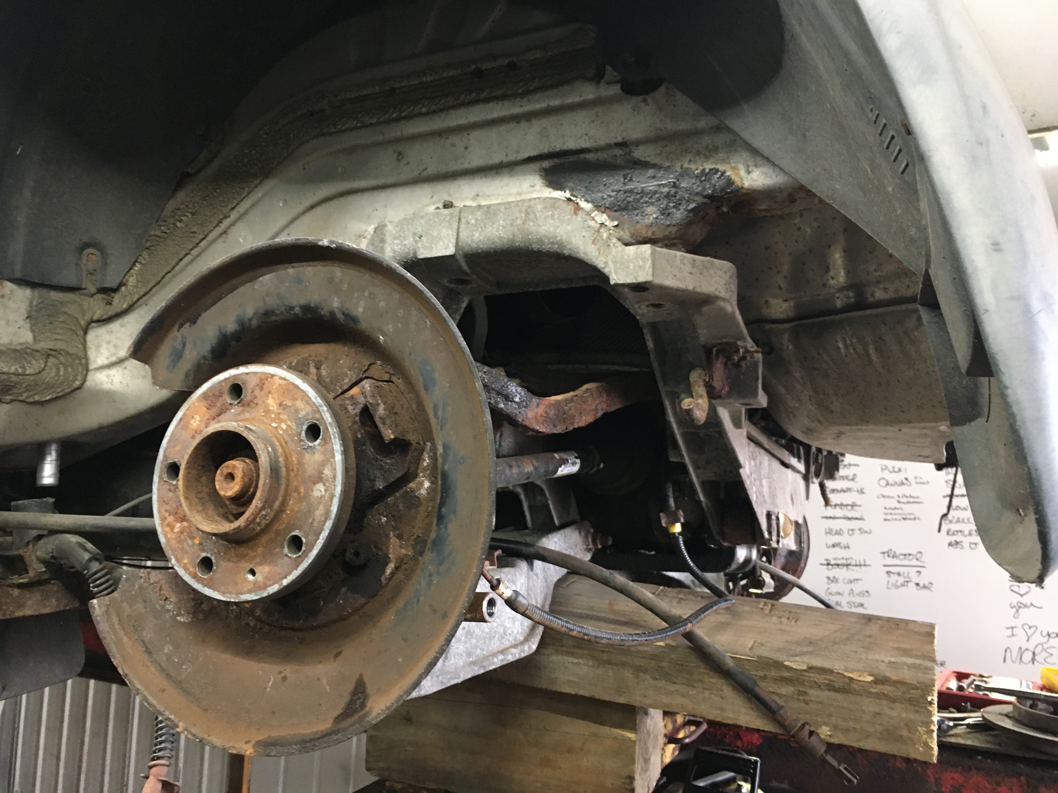

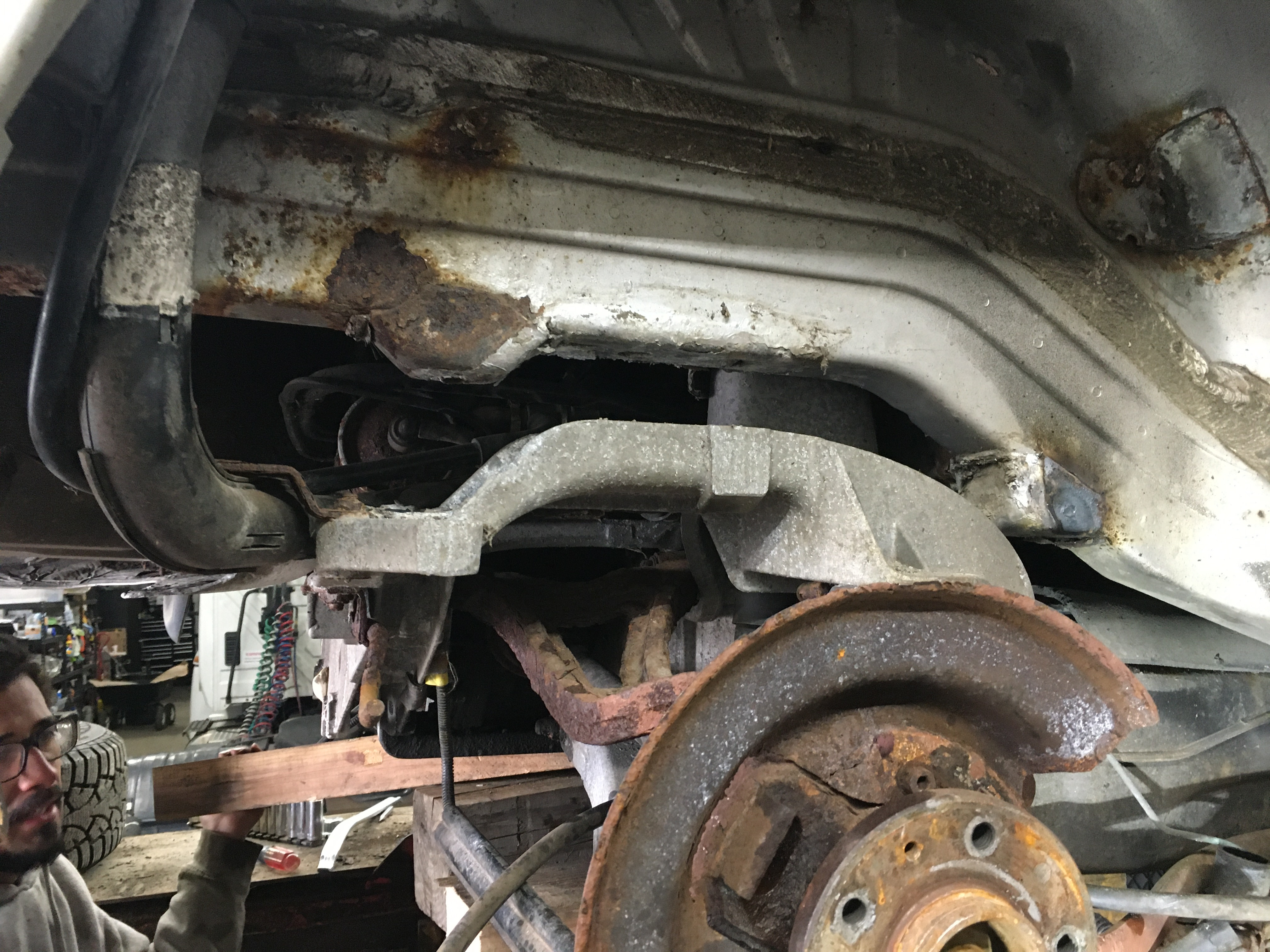

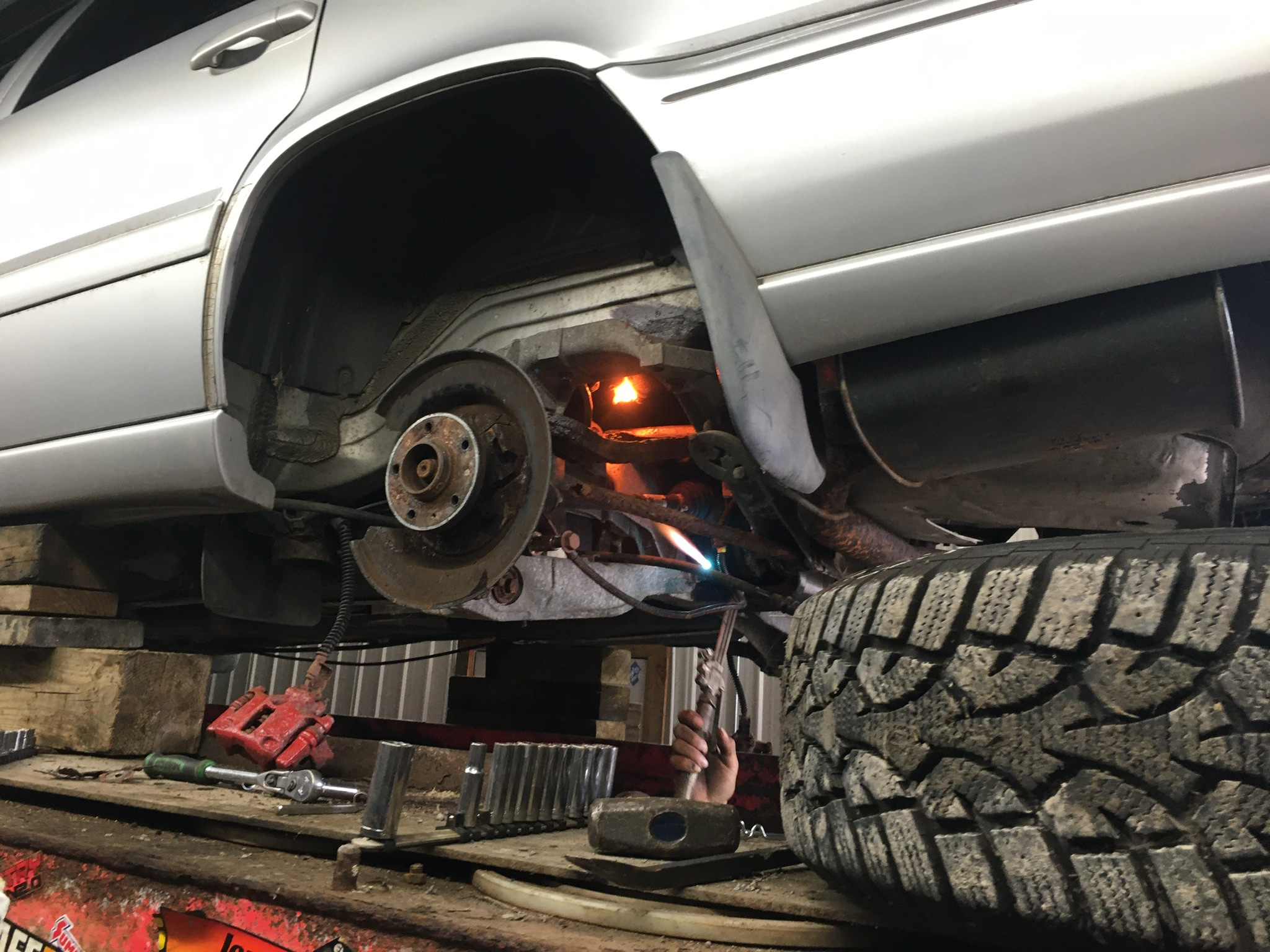

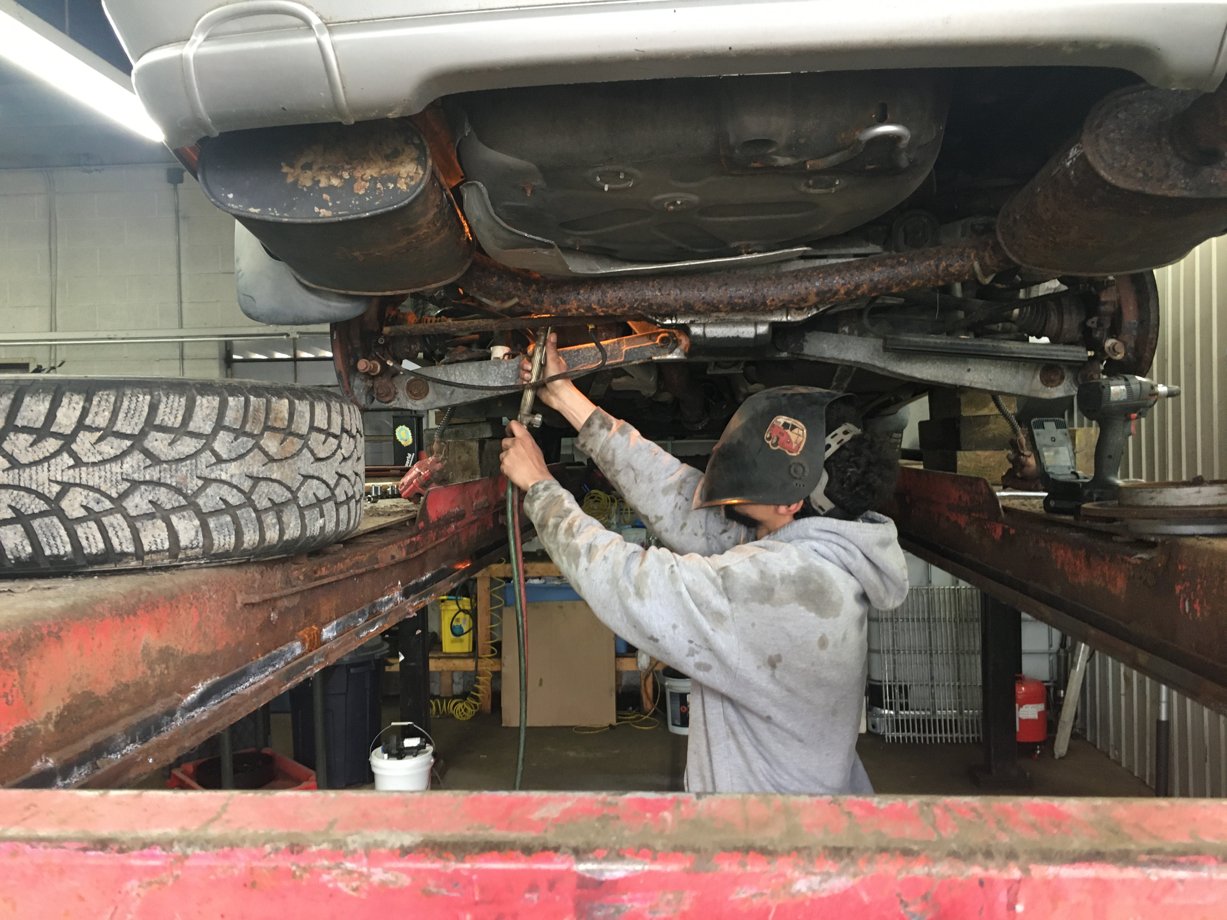

And the moment of truth came. The avid MVS reader will remember that I’ve gotten 5/7 of the axle carrier bolts loose but the last two wouldn’t yield to the big Green Monster.
I fired up up the oxy and heated the steel frame member up....zap zap zap...still not coming.
Onto the Alunimum sub frame, a bit less heat...zap zap zap .....SUCCESS!,
Both sides worked out...conclusion....it’s bolt to Aluminum corrosion that grabs these bolts

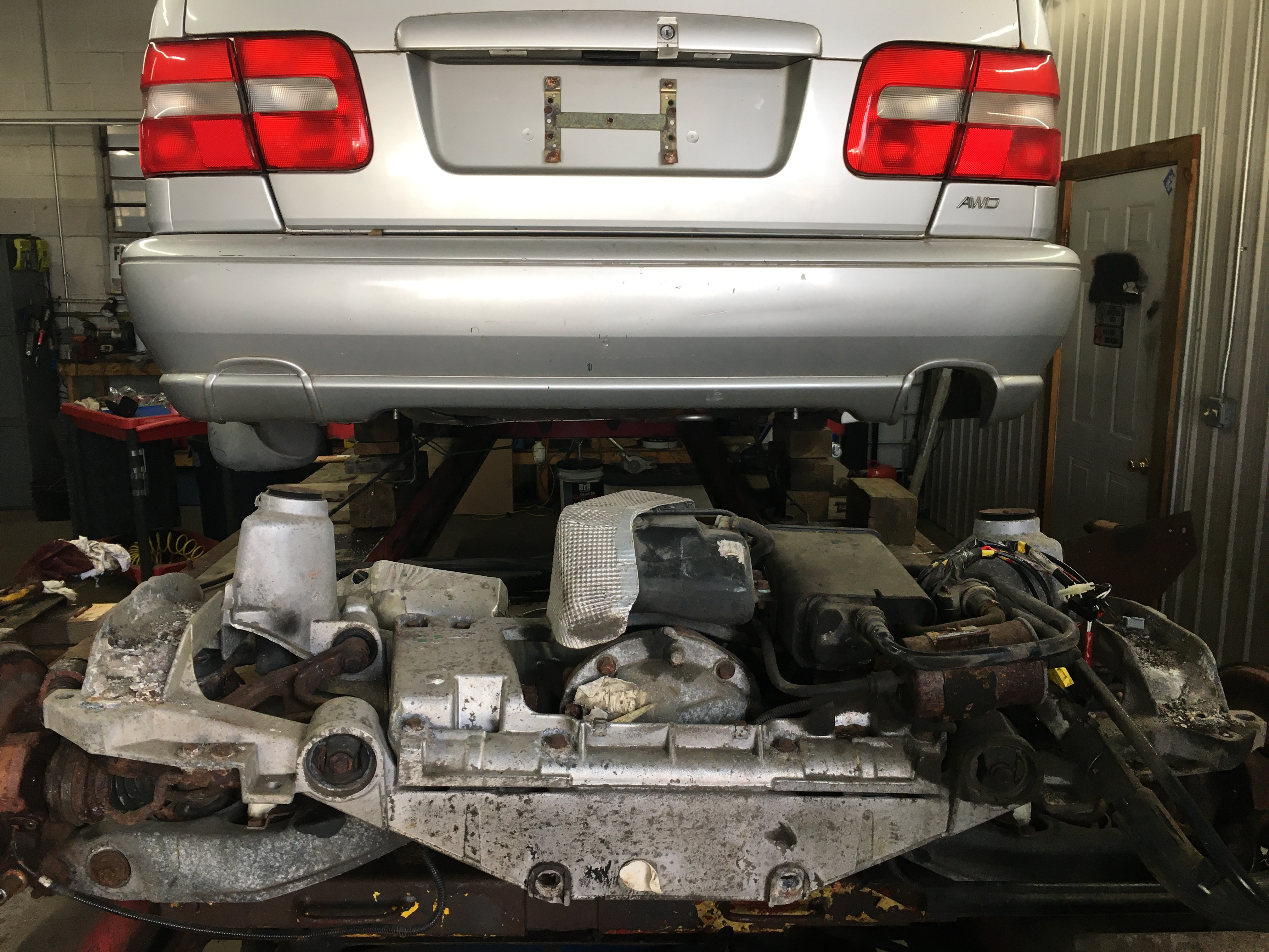

We blocked up the axle onto the frame jack...and......
Posts: 35267

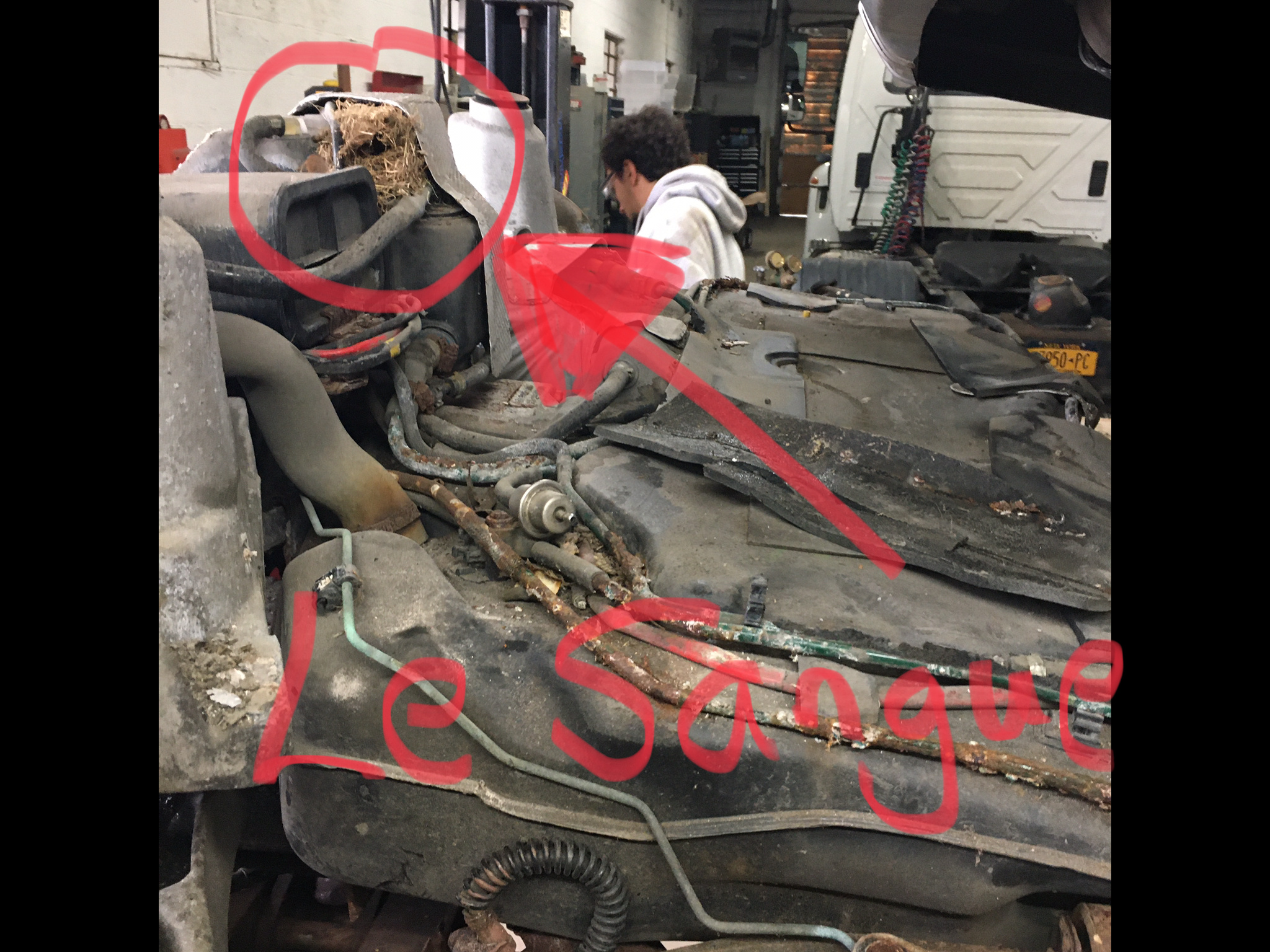

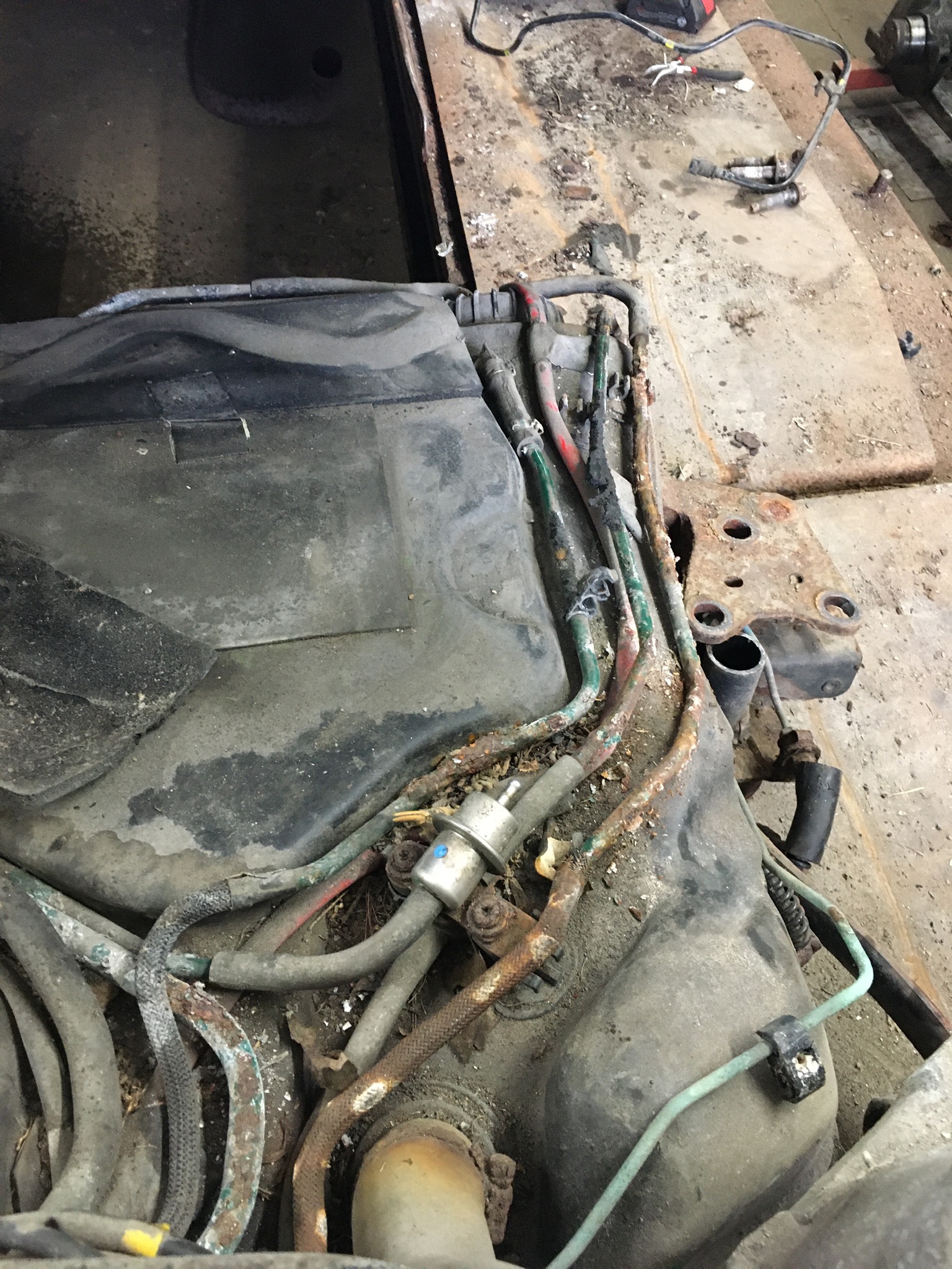

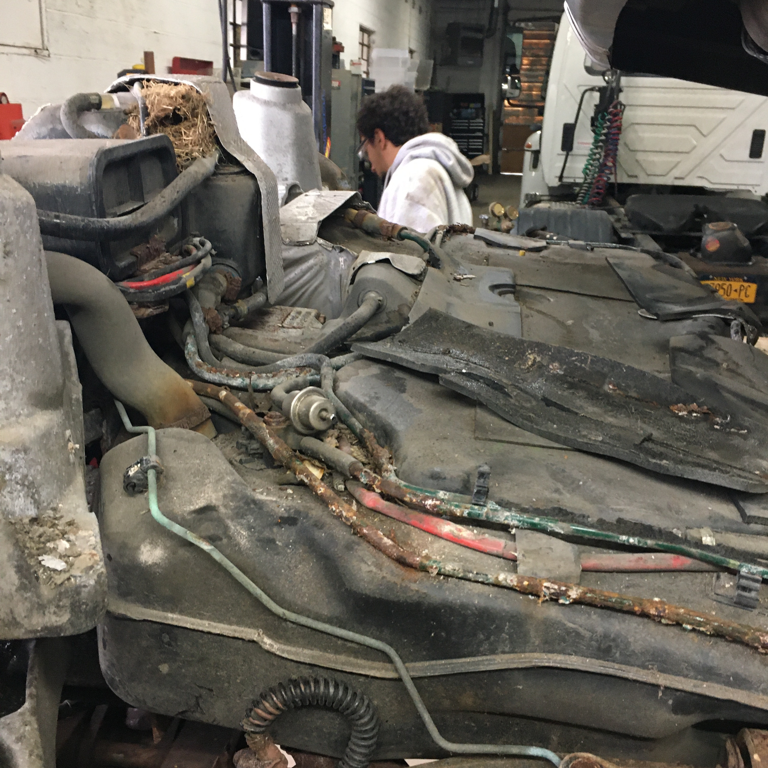

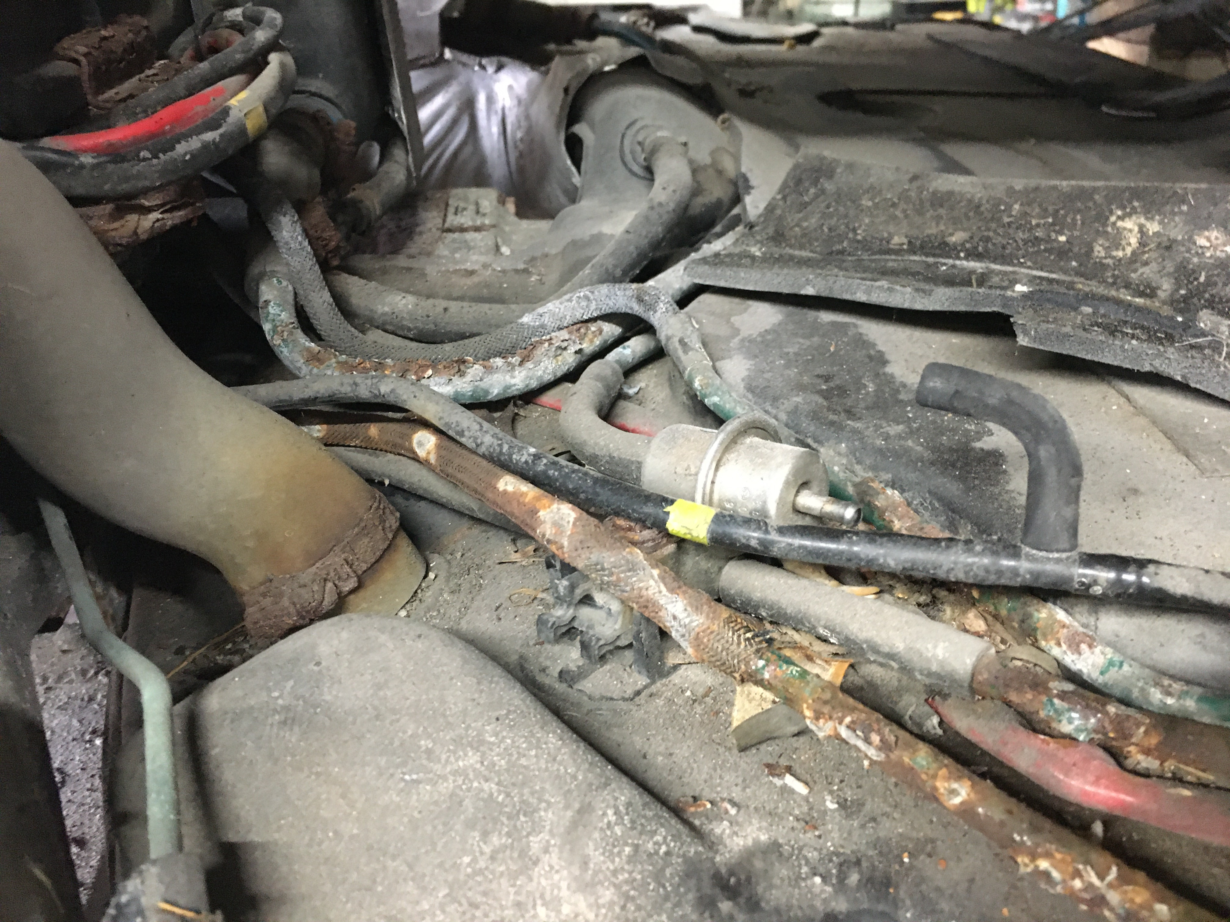

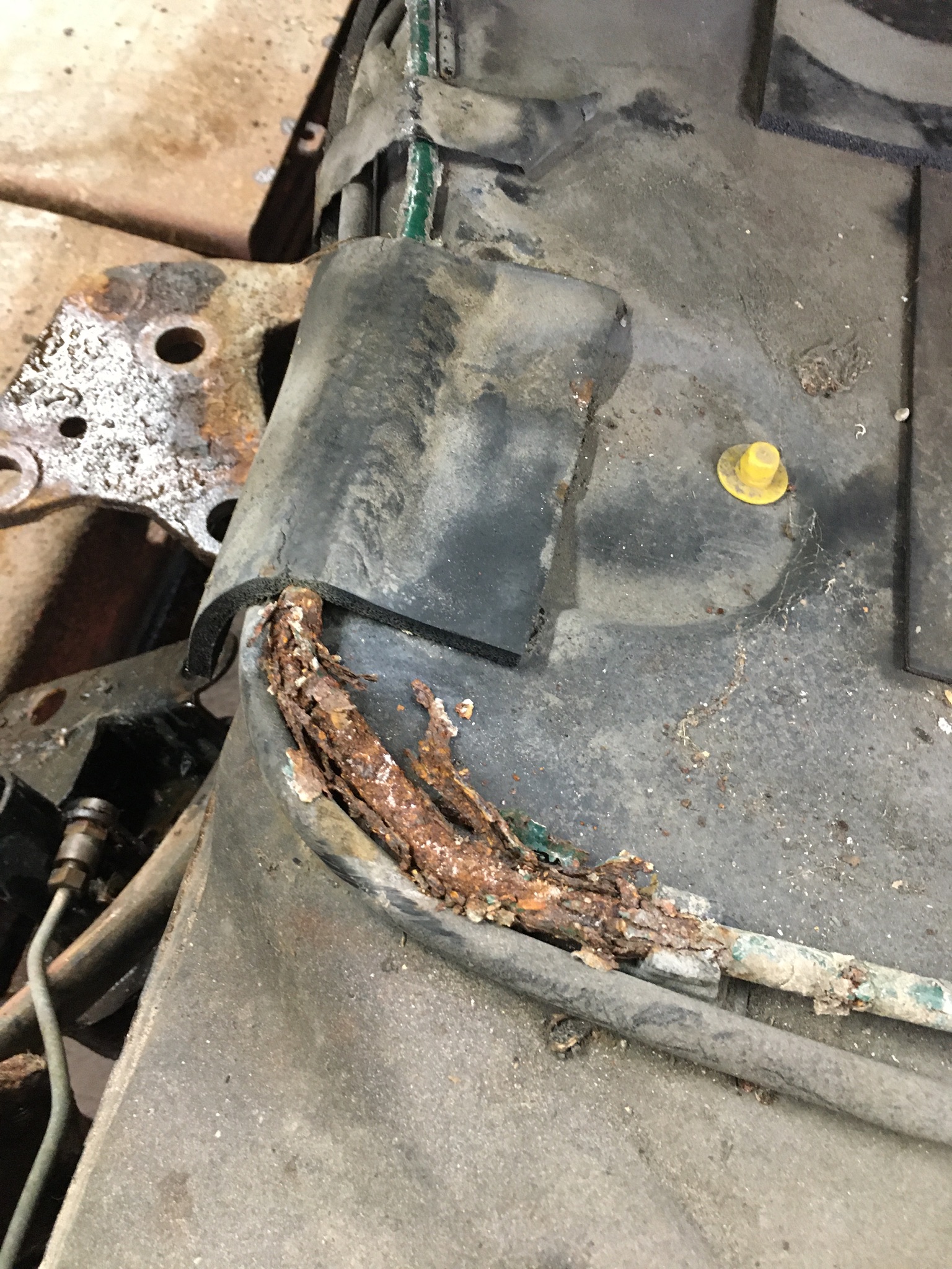

It’s a mess on top. The fuel lines are all badly rusted , so we will be fabbing all new lines to get her going again.
Posts: 35267
I told Caitlin it was a real Rube Goldberg fuel system, but she says it isn’t a true RGM unless it has a mouse...hey...wait a minute...
