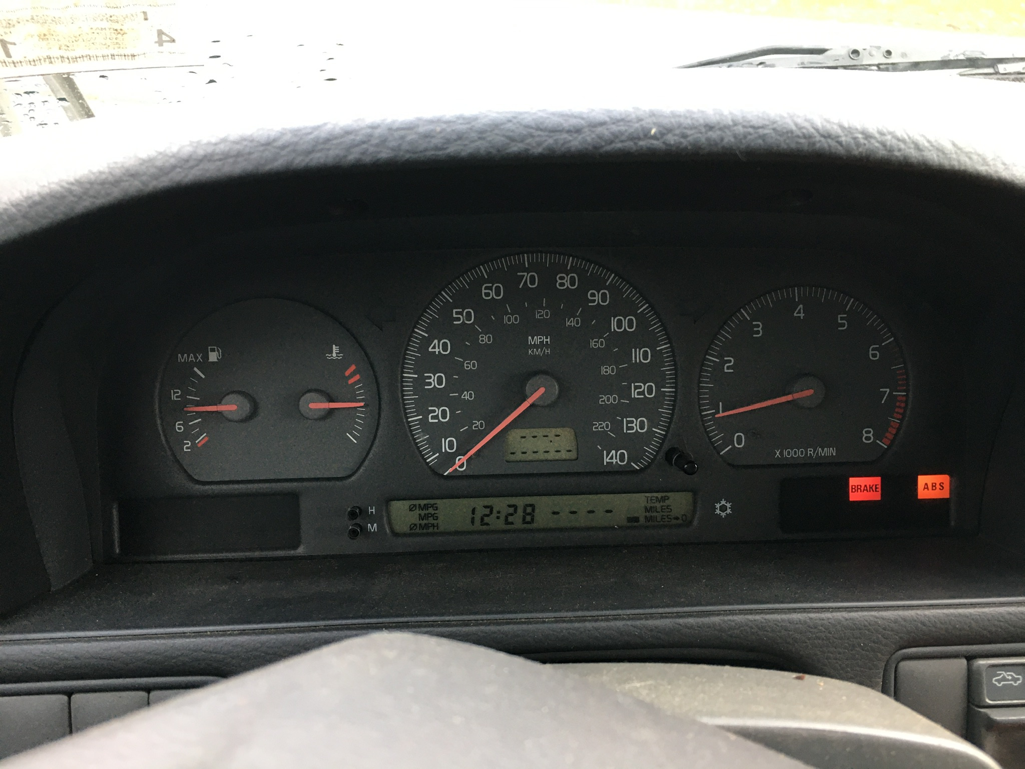

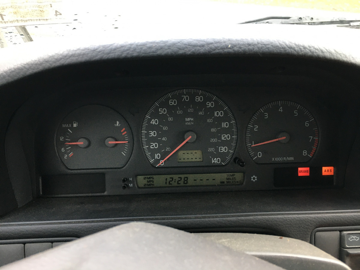

And we turn our attention to the 1999 Silver S70 AWD
USED gates barricade to bridge my new fuel line to the fuel rail. Clamped with two Oetikers
Installed air cleaner and battery., put two gallons of gas in tank
Cranked 5 x for 5 seconds, coughed on 6 attempt.
Caught and ran on 7th
No codes
Brought it to full operating temperature
Idled for 30 minutes at 40 F until oil showed clear of water.
She is smooth runner. Need to sort rear brakes and fuel filler
No codes

So is it a brand new car as the mileage shows as a series of '--------''s? Thankfully, I now hope you are on the way to another functioning car after a huge learning curve! Well done that man!
