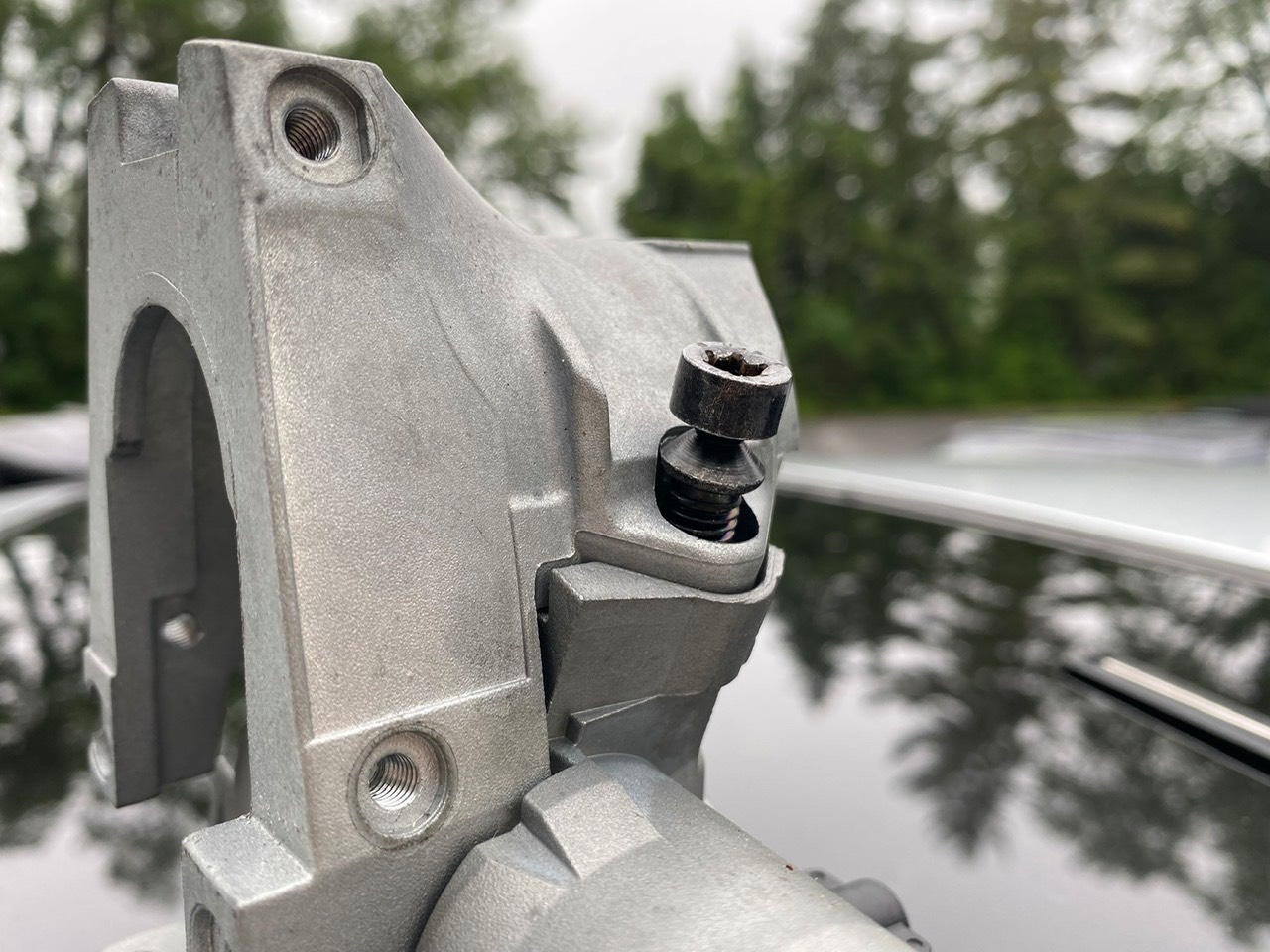

Manual impact. Take a hammer and chisel give it impacts until you get it to loosen up. You can cut a spot at the end of the slot as a landing for the chisel.
That’s a good strategy. I bet impact would have worked to crack it.

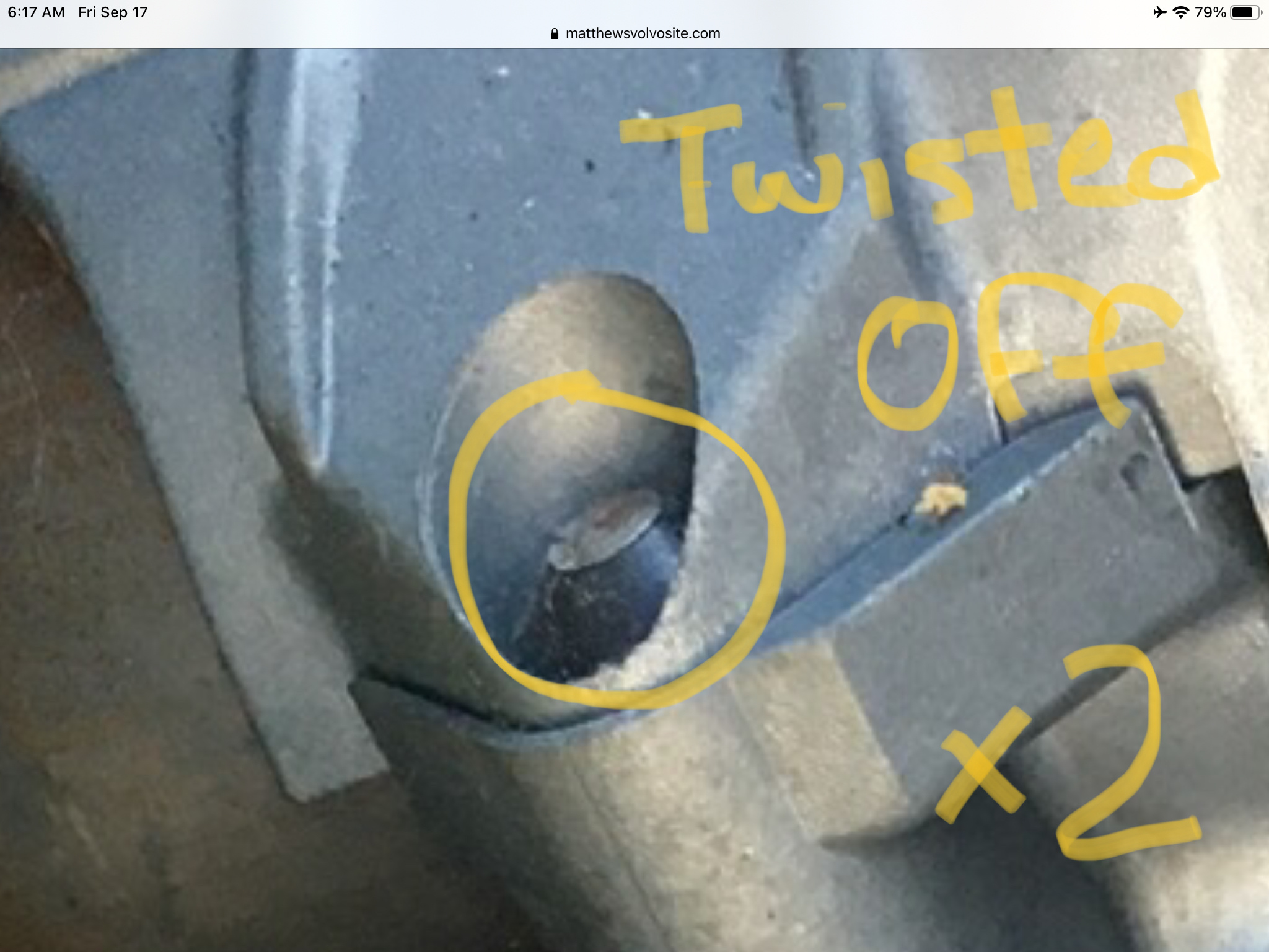

Here is the head of the twisted bolt you are dealing with. Nice side landing cut with Dremel then you can bang on it perpendicular to the steering column

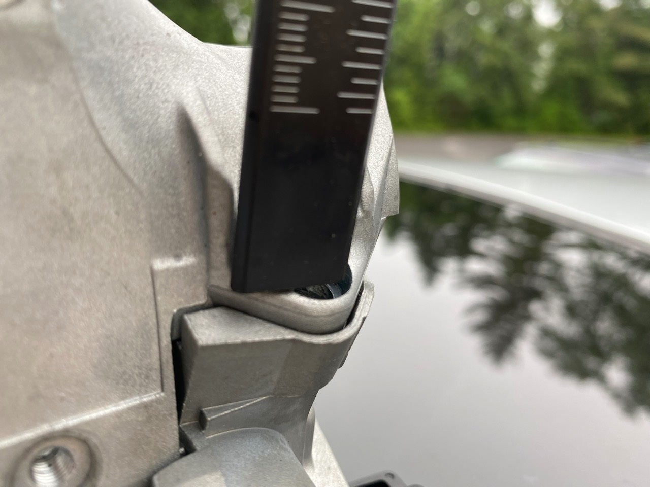

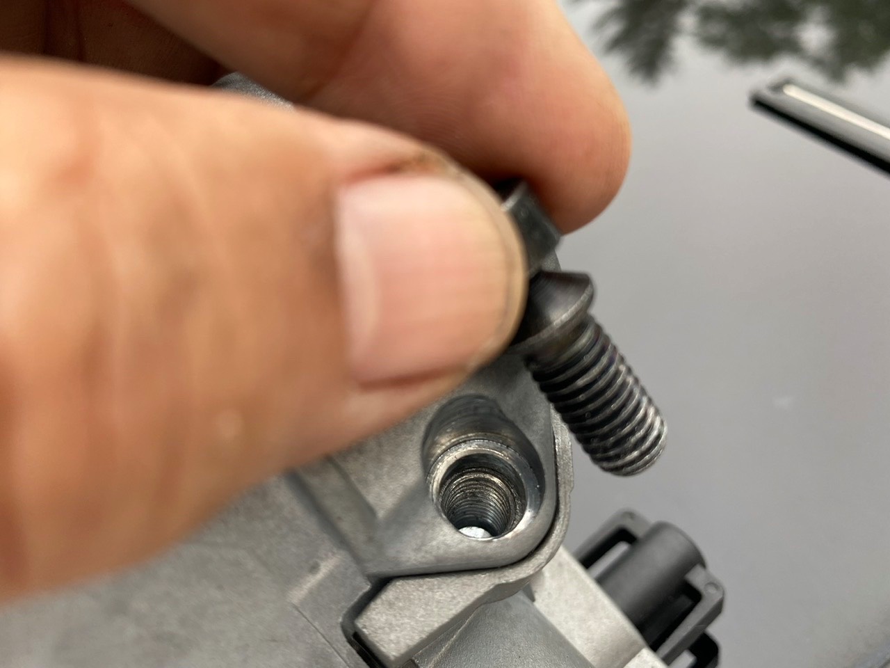

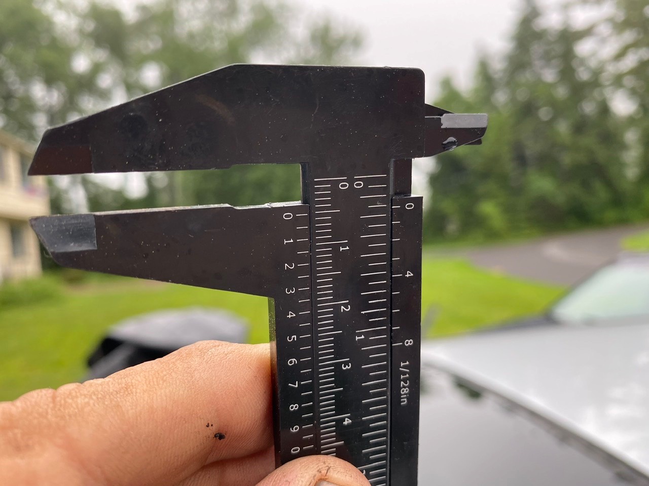

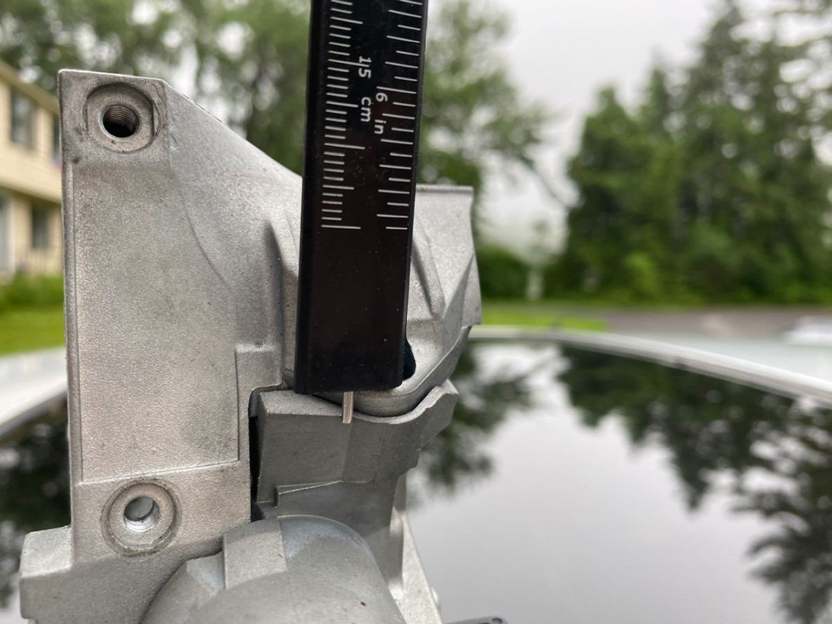

Adding to knowledge base on this one.
How deep you need to go to drill off the head of the security screws?
Answer..the boss is6 mm deep from the head, which is unfortunately 1 mm depressed in the lower half of the lock assembly…
