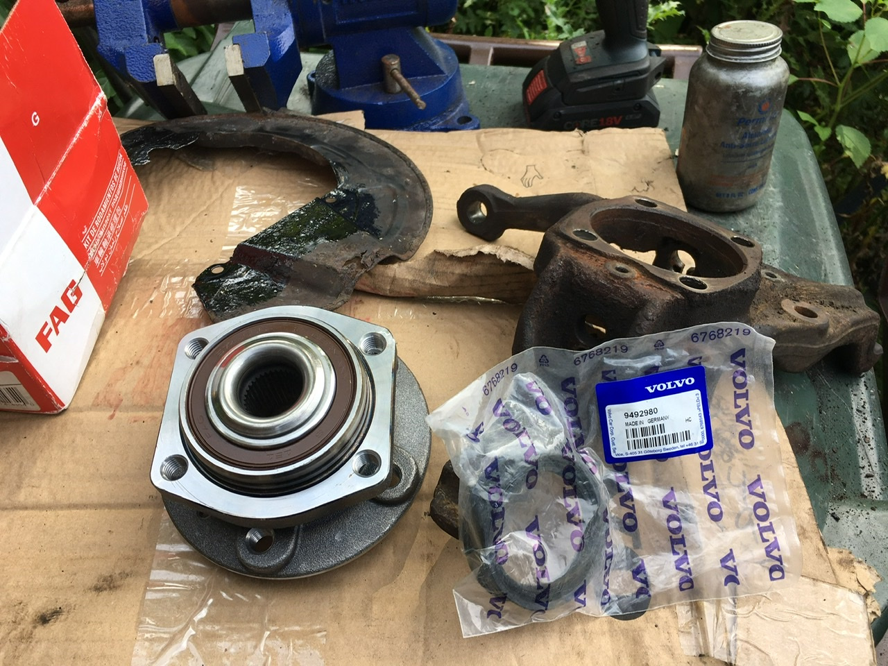

I replaced the front wheel hub assembly the other night and noticed that a seal on the back side is missing. Thats probably why the bearing failed. It was a FAG bearing. I used FAG also and don't to replace it any time soon. Does anybody know what the part number is for the wheel hub seal? I have searched and can't find any info.

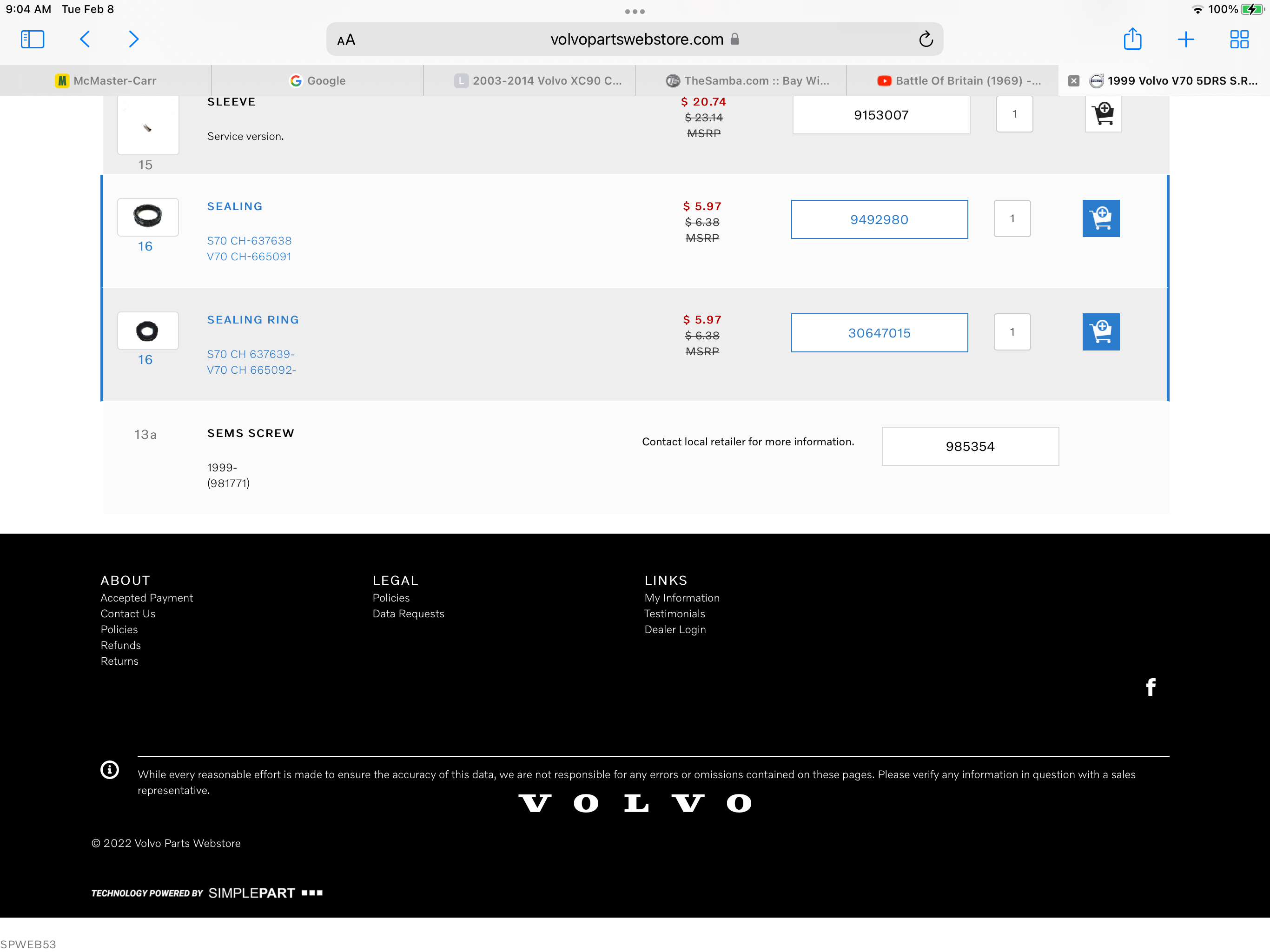

I looked up the diagram on VIDA and I see the sealing ring.
For V70's they list 9492980 for chassis number up to 665091 and
30647015 for chassis number 665092 and on.

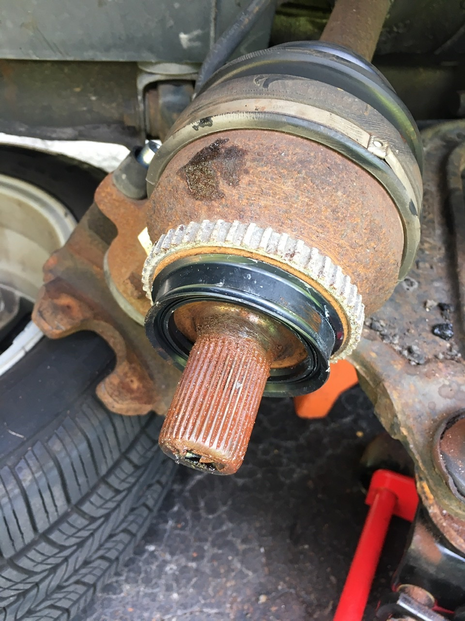

Let’s add to this 10 year old thread !
The seal is not installed on most cars in Sweden / Ghent but is a Volvo approved add on

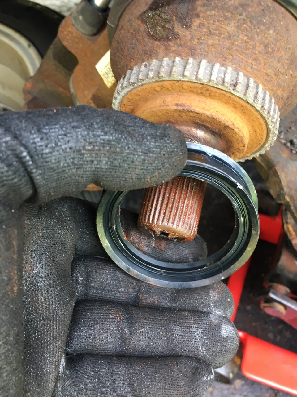

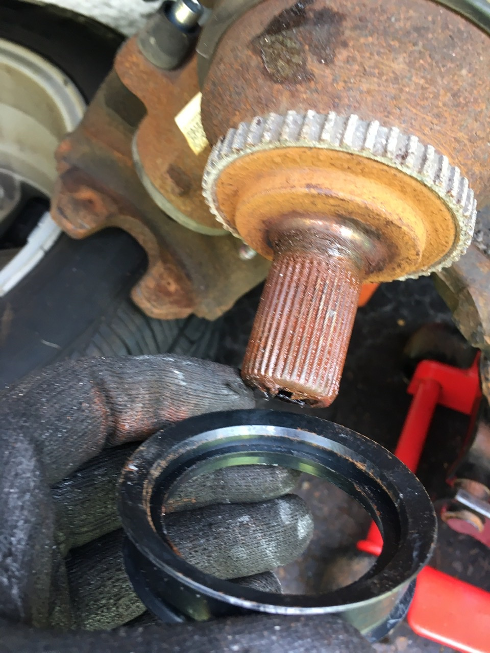

The 9492980 seal has a correct orientation , see pictures

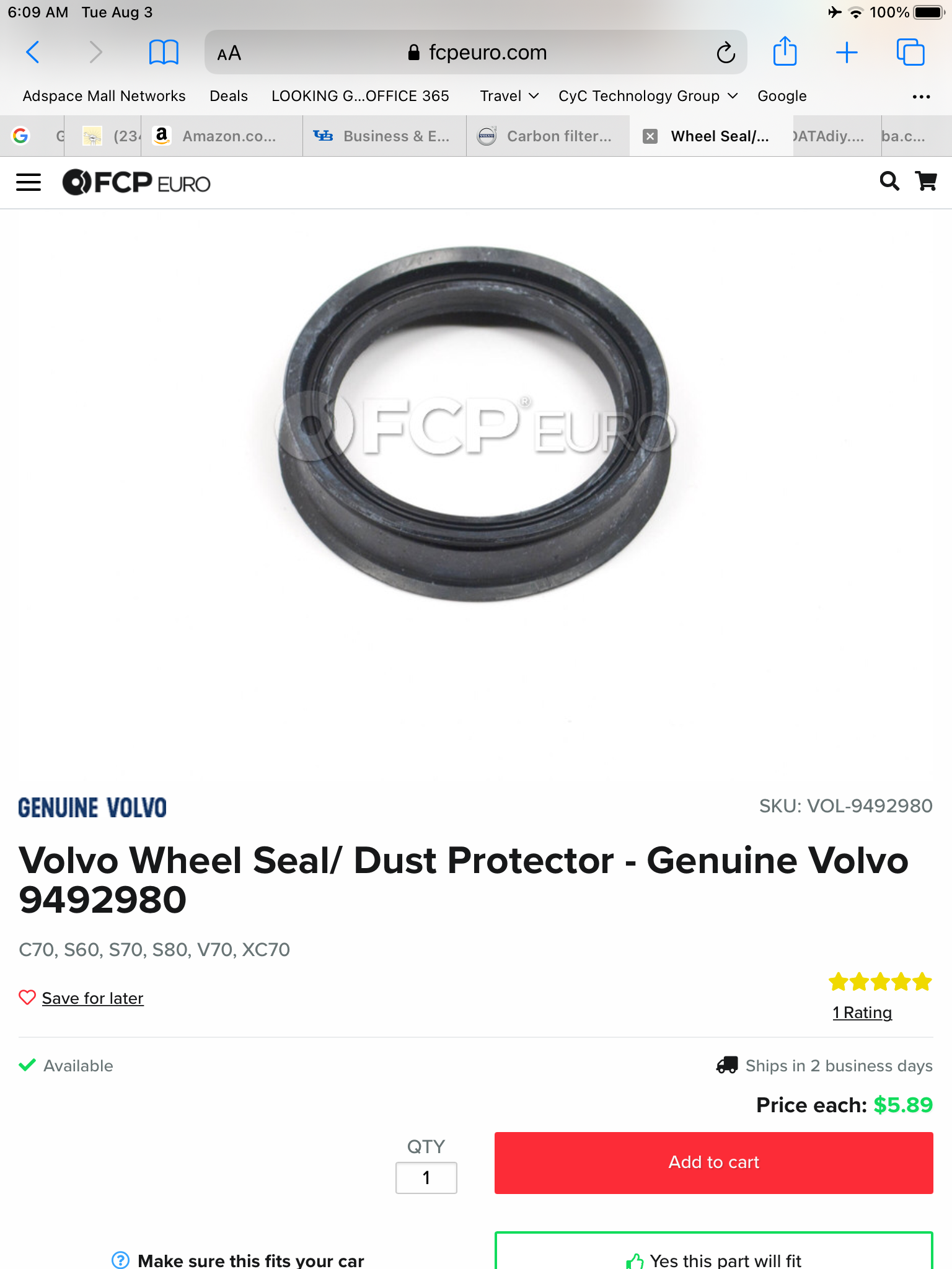

Added FCP picture to post, it’s $6 part protecting a $100 bearing amd 4 hours labor

Here is the chassis break info on the seal
