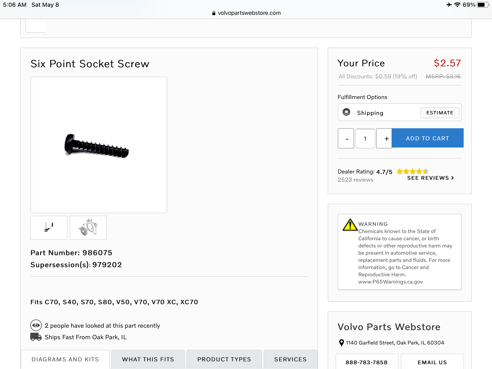

I’ve never figured out why those radiator Torx bolts get so rusty. I guess it’s the heat from the radiator. After I’ve spent 15 minutes per bolt fighting each one out with a vice grip, I throw them away and replace with cheap ss screws from Lowe’s, hex head. I documented the size somewhere here...
...this thread...
viewtopic.php?f=1&t=79387&hilit=Radiator+shroud+screws
...and let’s add the part numbers to title for an easy search...
986075 979202
