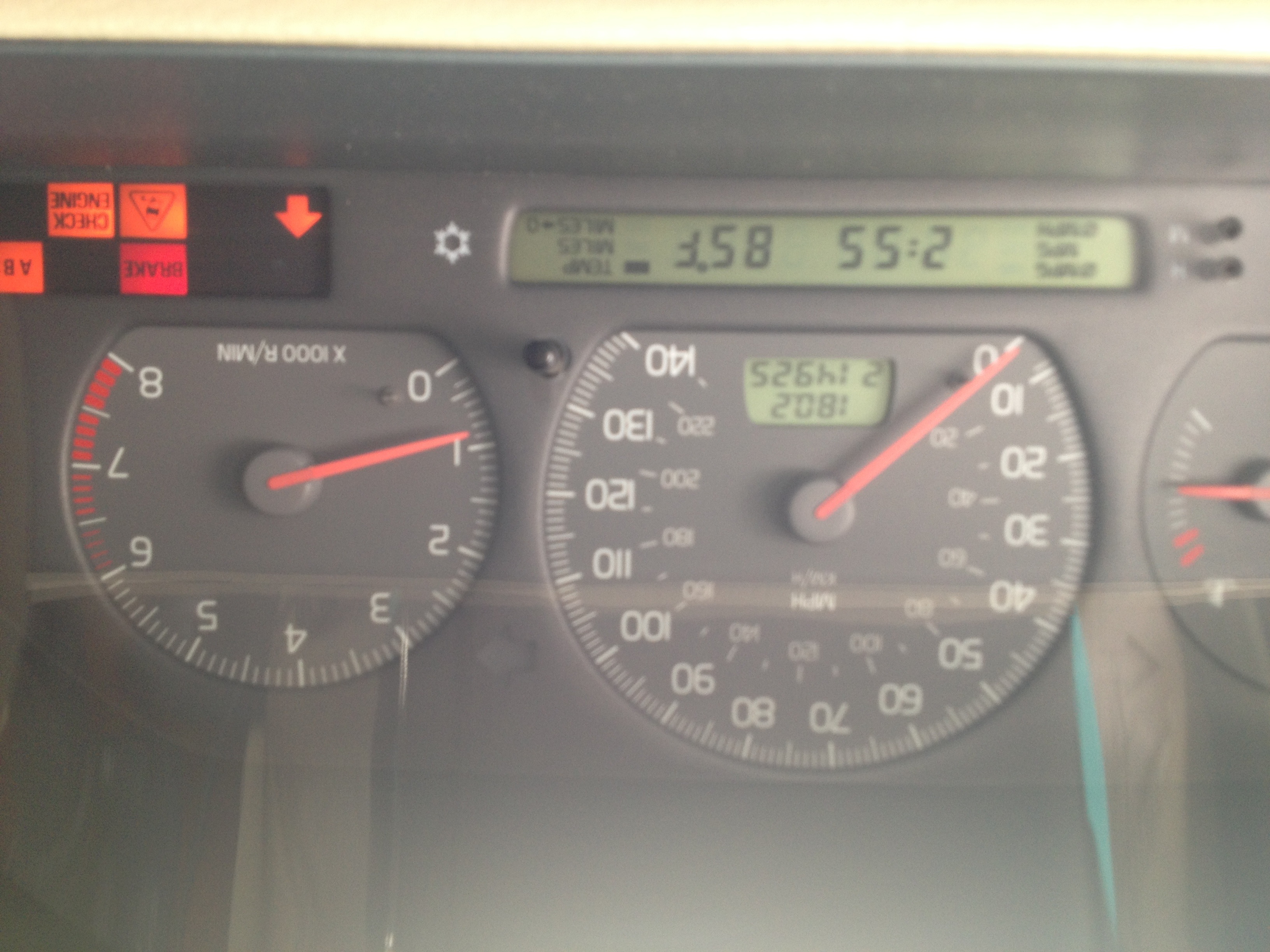

I took the car for a Home Depot run...paper clip mode. I noticed the car tried to bog down a bit every now and again (whether it I was going a steady 45 mph 2500 rpm or from a dead stop). The arrow (W mode) light was on and blinking as well as the traction light periodically....and the odometer would be blank.
Of course I made sure to park far out in the parking lot backed into a spot in case I ended up needing a tow.
I am home now so I survived out there. Heading to back to work may be a different story tomorrow. Can I continue to "attempt" to drive the car with the paper clip? Part won't be here for a few.
Thanks,
Amy

I was able to drive to work and back. The bogging down seems to be more prevalent when going from stop/idle to throttle.
Throttle didn't seem to engage until I got it to almost 3000 rpm.
While I am driving, many lights on on (check engine, trac, arrow blinking, brake light, etc).
Odometer and speedometer intermittently go blank.
Awaiting the arrival of both the fuel pump relay fuse and antenna plug/ring.
I will replace each part separately to hopefully rule out what the problem may be.
I replaced the MAF 3 years ago (OEM). Should I try taking that apart and clean?
My fear is that this whole issue may be the ETM (although the ETS light has not been on for years).
The "check engine" light, however, has been on most of the time I have owned the vehicle.
(@ Klaus: thanks for the advice. I did try the gear shift (D to L back and forth about 20 plus times). Unfortunately, the arrow was blinking throughout my drive).
I will update after I receive the new parts.

Just one more thing to add:
It hasn't "died" in the last few days. It's wanted to but if I rev a bit, it holds it's own with a lot of effort.
That's new since last week. Last week it would big down and die. All power steering, etc. gone.
Is it not dying completely since I pulled the fuel relay and cleaned it and put back in?
The same with antenna ring?
