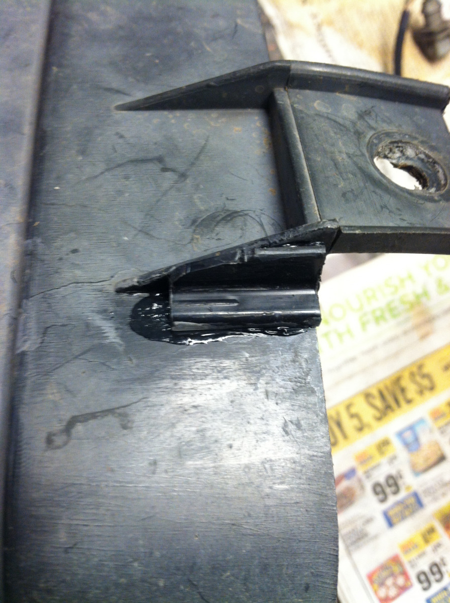

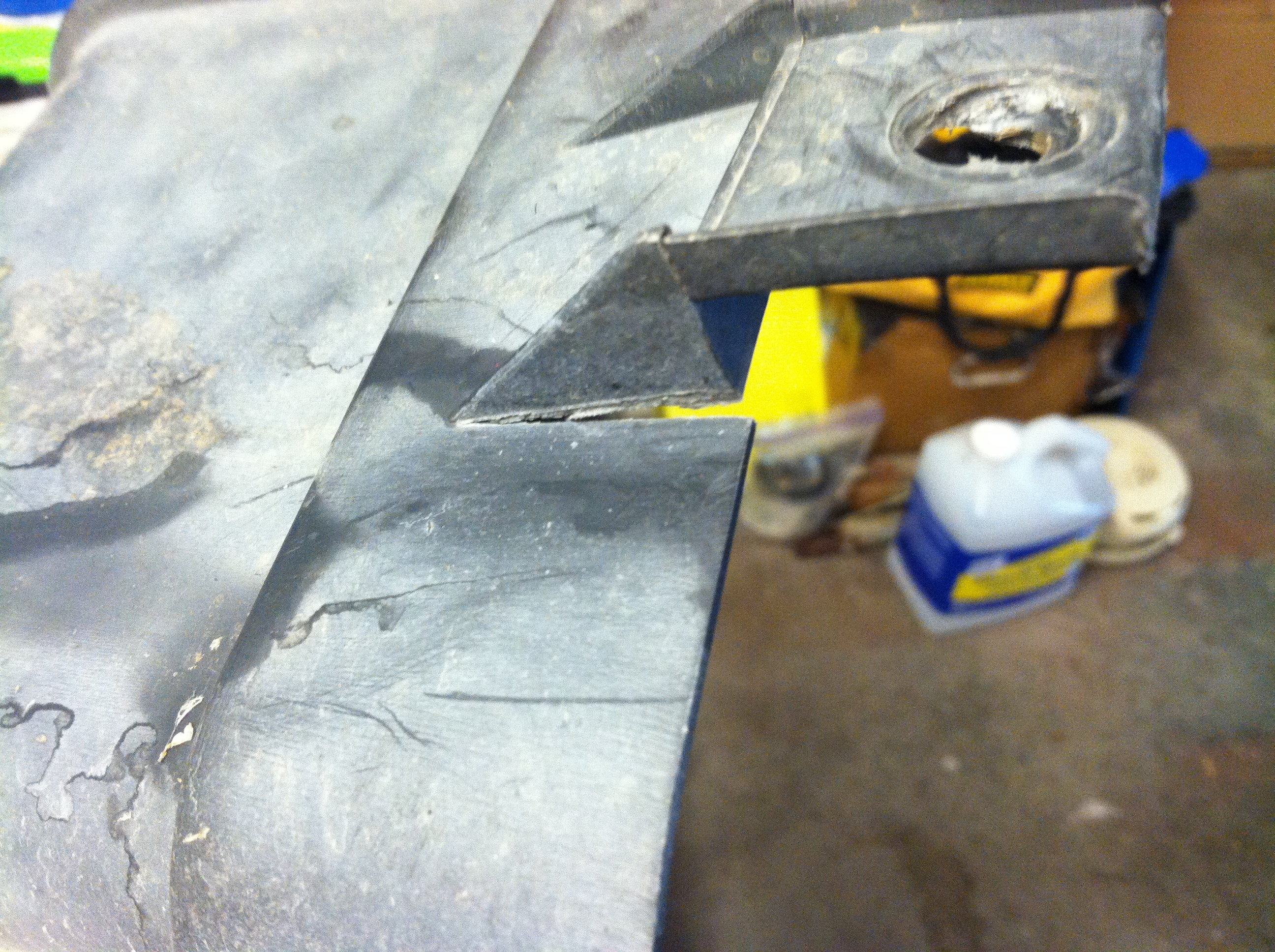

Not home, but in recent past, I did repair the end tab on one, that bolts to the inner skirt:
Oatey ABS medium black
Those dainty little tabs that go in the slot on the bottom of the bumper cover might be a whole 'nuther sport.
(Pics loaded reversed - operator error.)
